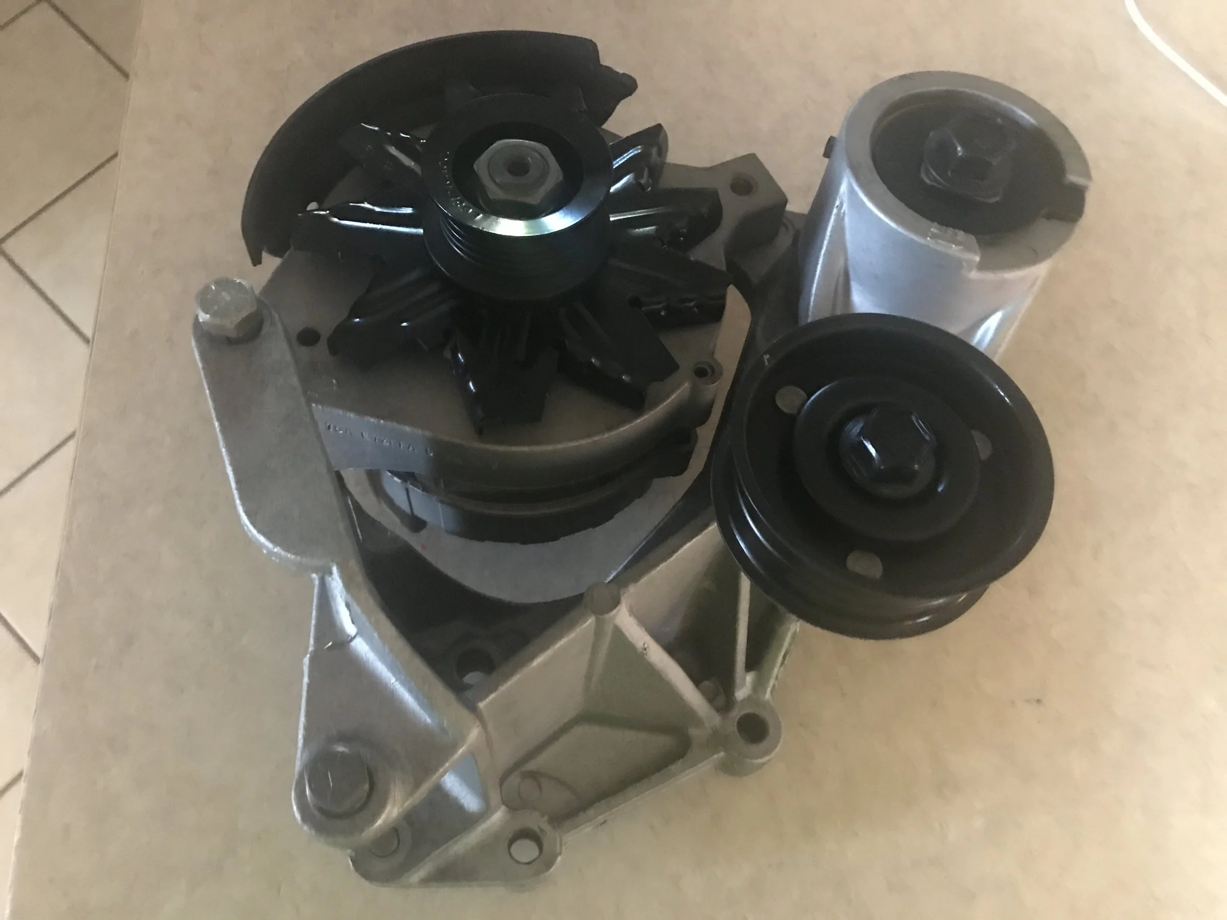

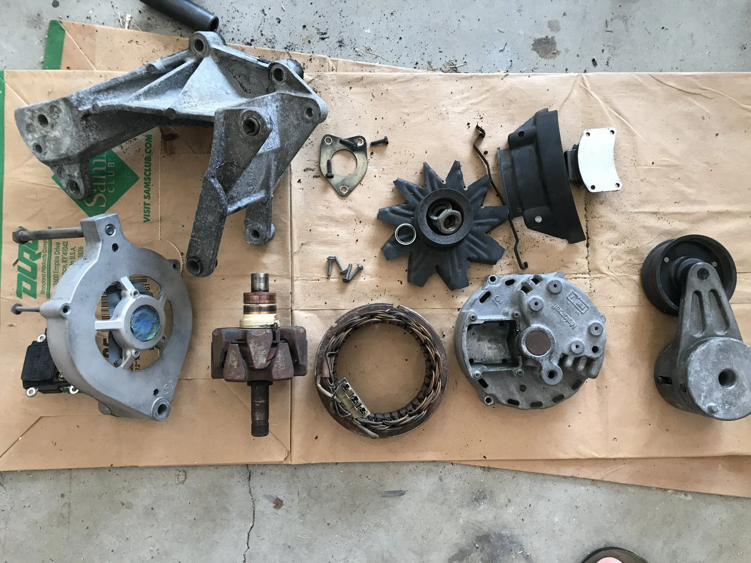

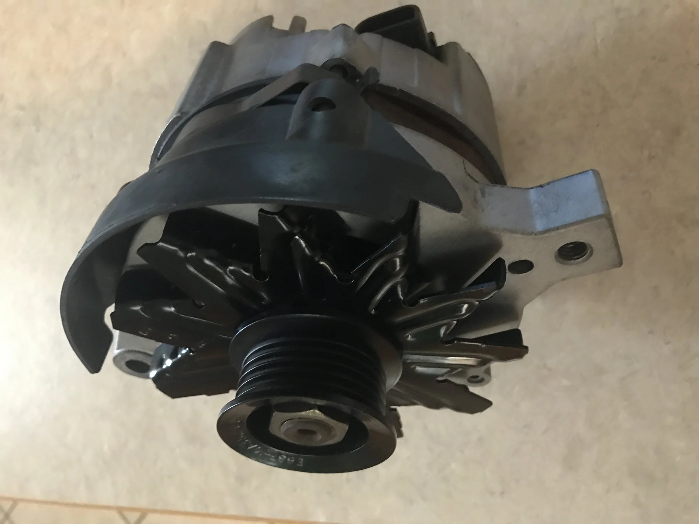

I guess if I am going to change the brushes, I might as well dive in and make sure everything else is okay. Everything on the Stator (< .5 ohms for any connections) and Rotor ohmed out okay at 2.6ohms (spec is 2.0 to 3.9). Rectifier diodes are all good. I will do the final test of the regulator once it is back in the car. The case and everything cleaned up nicely in the blast cabinet and a light coat of high temp satin clear to keep it that way....
Since everything checked out... Rebuilt alternator looking like new for $3.95
I wonder how many people still have that original plastic fan shield on their alternators?

Blast Cabinets are a must for this sort of resto. This would have been a good time to replace the belt-tentioner... Lookin good!

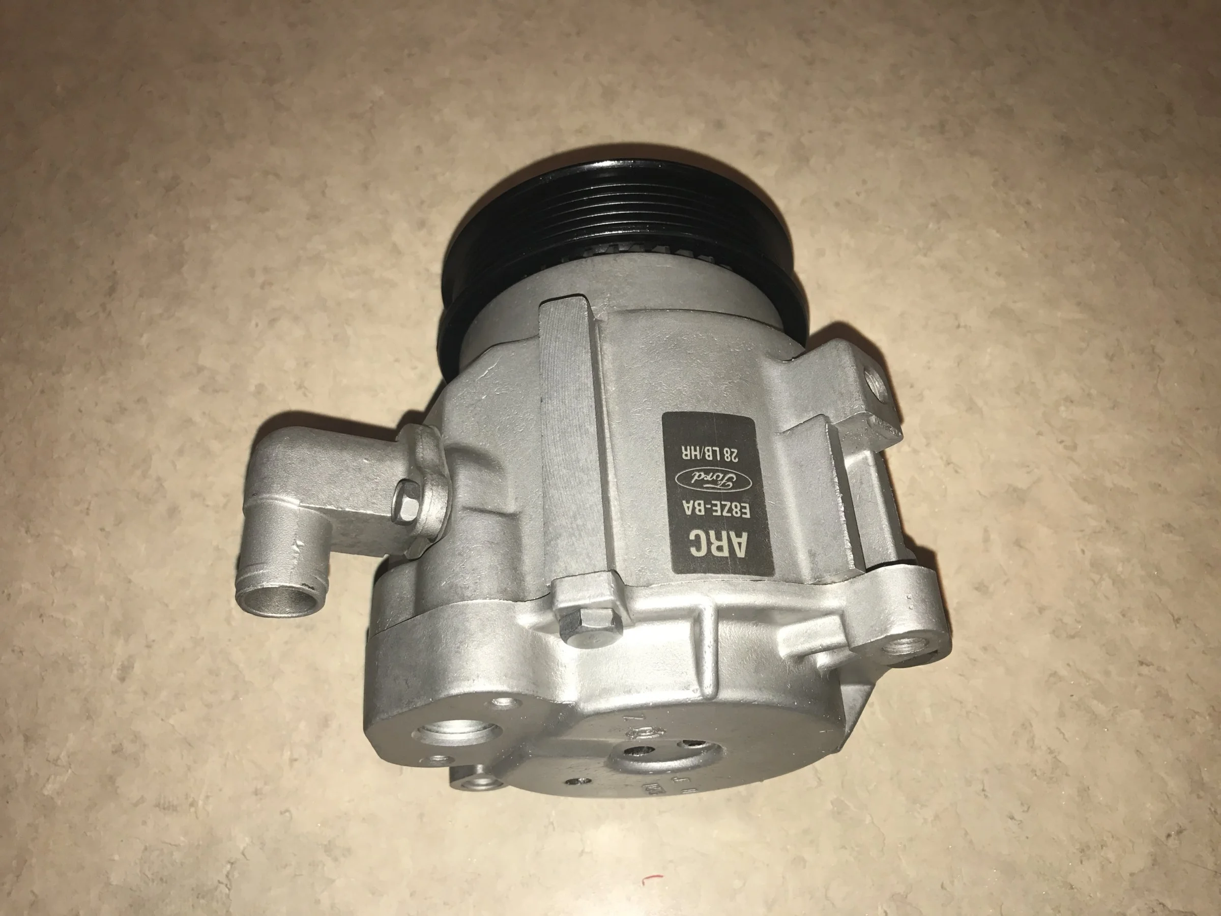

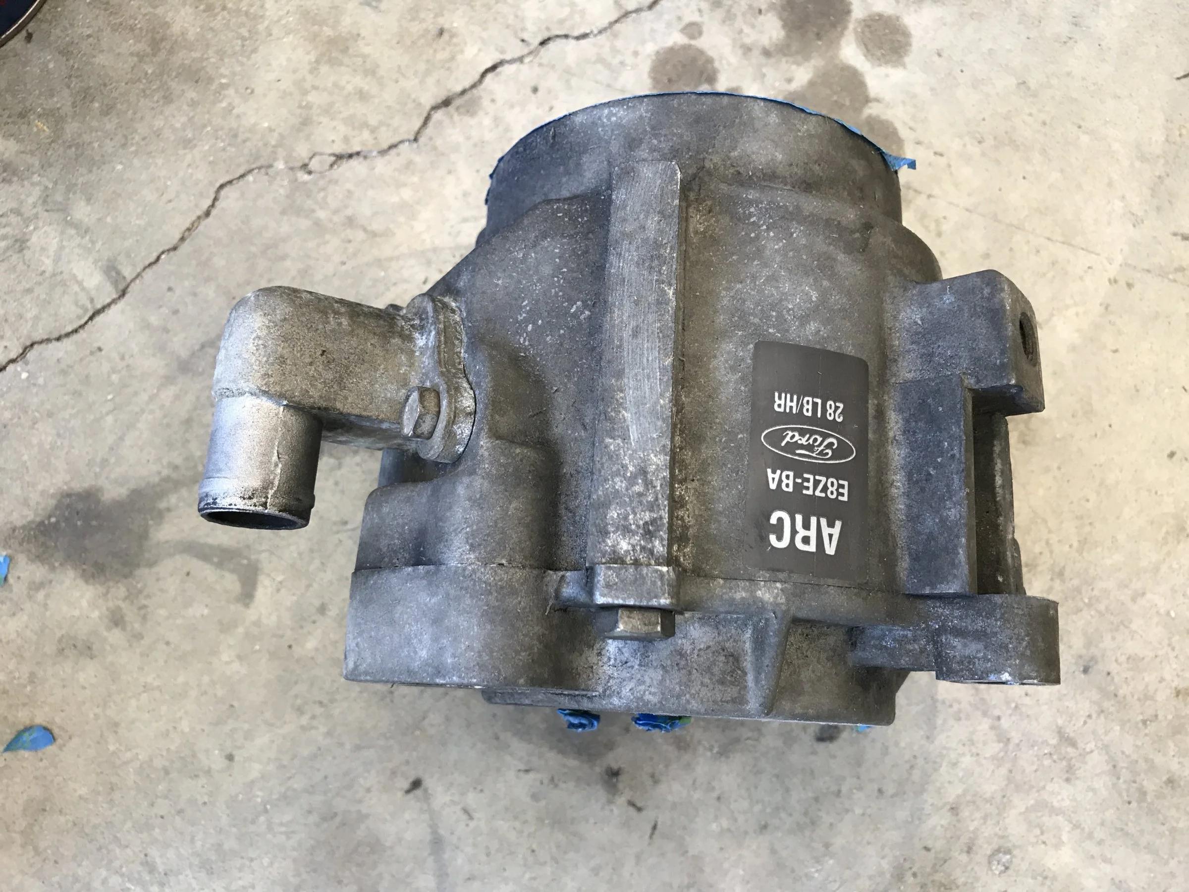

Smog pump before and after
Reactions: 95BlueStallion, Nutty 5.o, 90sickfox and 2 others

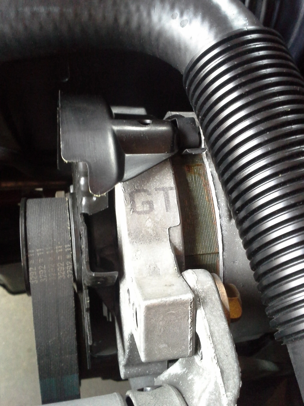

I still have the plastic fan shield.....and the factory "GT" marking

Cool touches, were you taped over the OEM stickers.... I actually stripped and painted my intake with VHT and it is pretty resistant to chemicals. I couldn't tell from the pics that the parts weren't new.
What did you do about the hardware such as nuts and bolts: you painted them as well? I still have my OEM alternator with the plastic fan...lol Took if off at original 45k. I think I'll just store it for whatever....
Nice.That looks real clean. All of my aluminum is oxidized and has white spots on it... How do you keep yours looking so clean?
Hardware also.. I'm using a mild glass bead media... Wife hates coming home to car parts curing in her oven

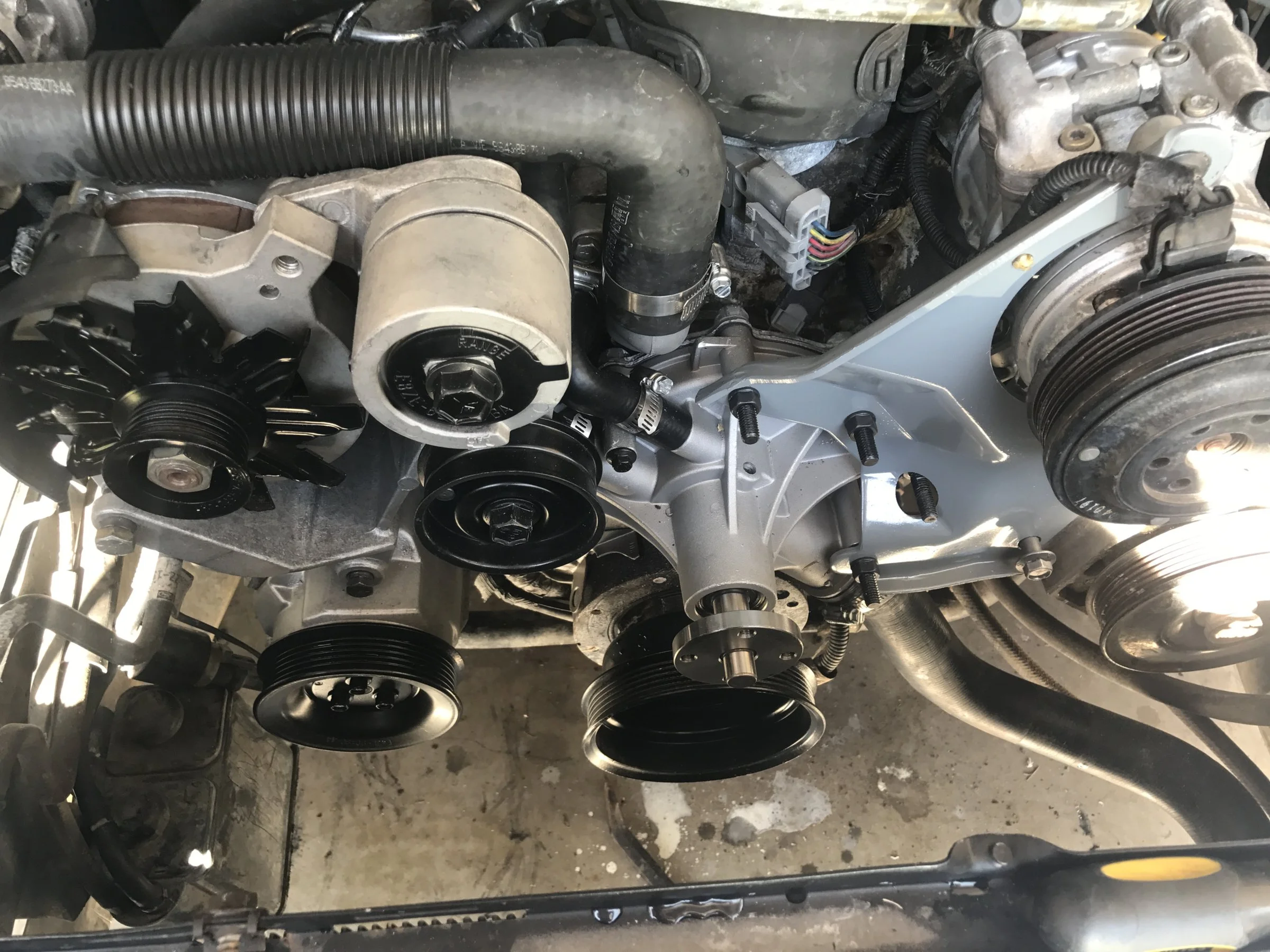

Okay, got all the accessories cleaned up, rebuilt, or replaced as needed. Remembered how to put it all back together and it is looking a lot better. Really surprised that the idle is smoother and all the dash lights are all brighter. I guess the alternator was really struggling with almost no brushes, and parasitic battery drain is gone.
