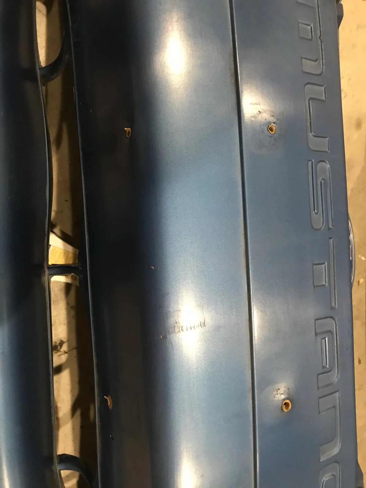

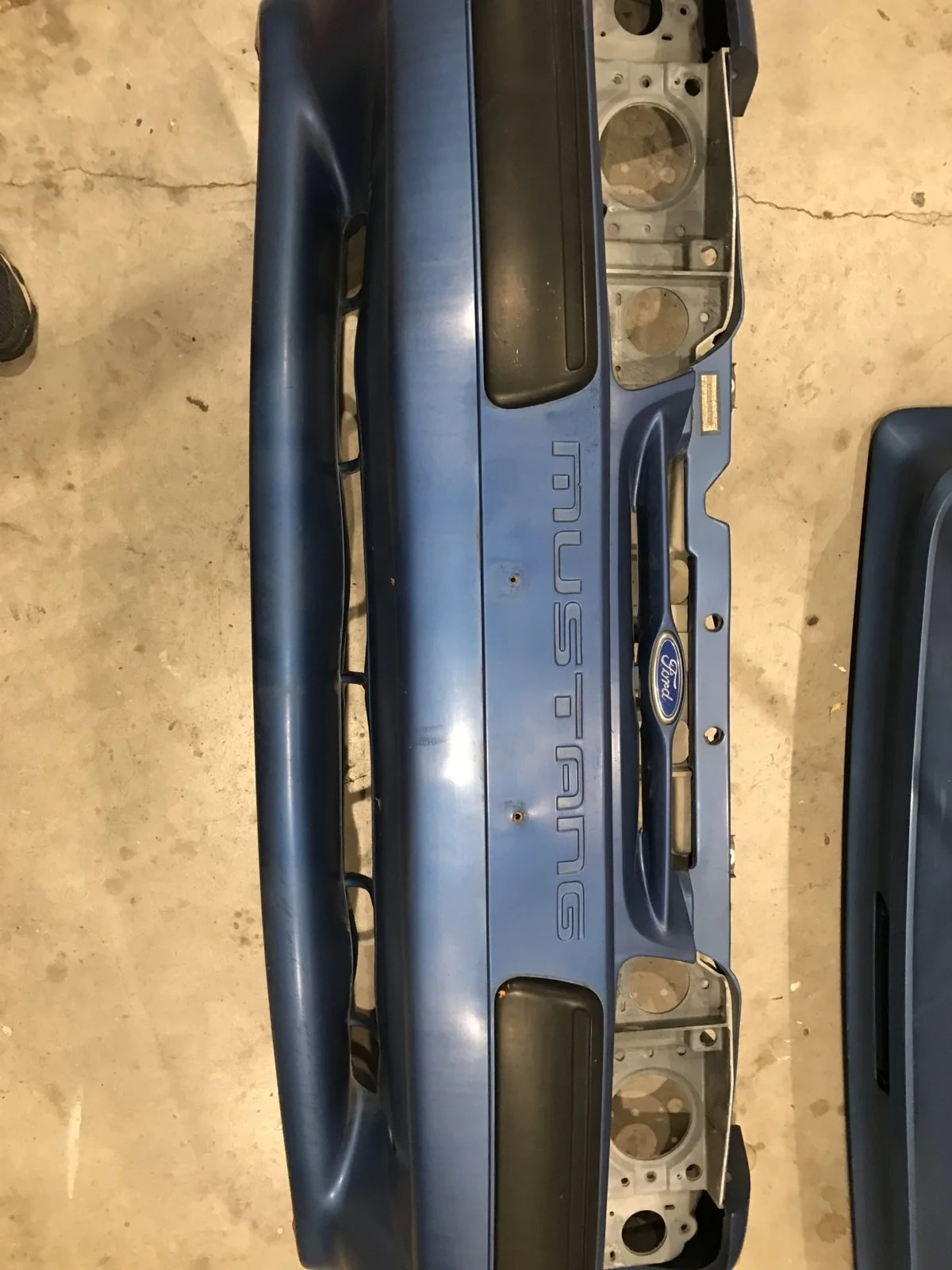

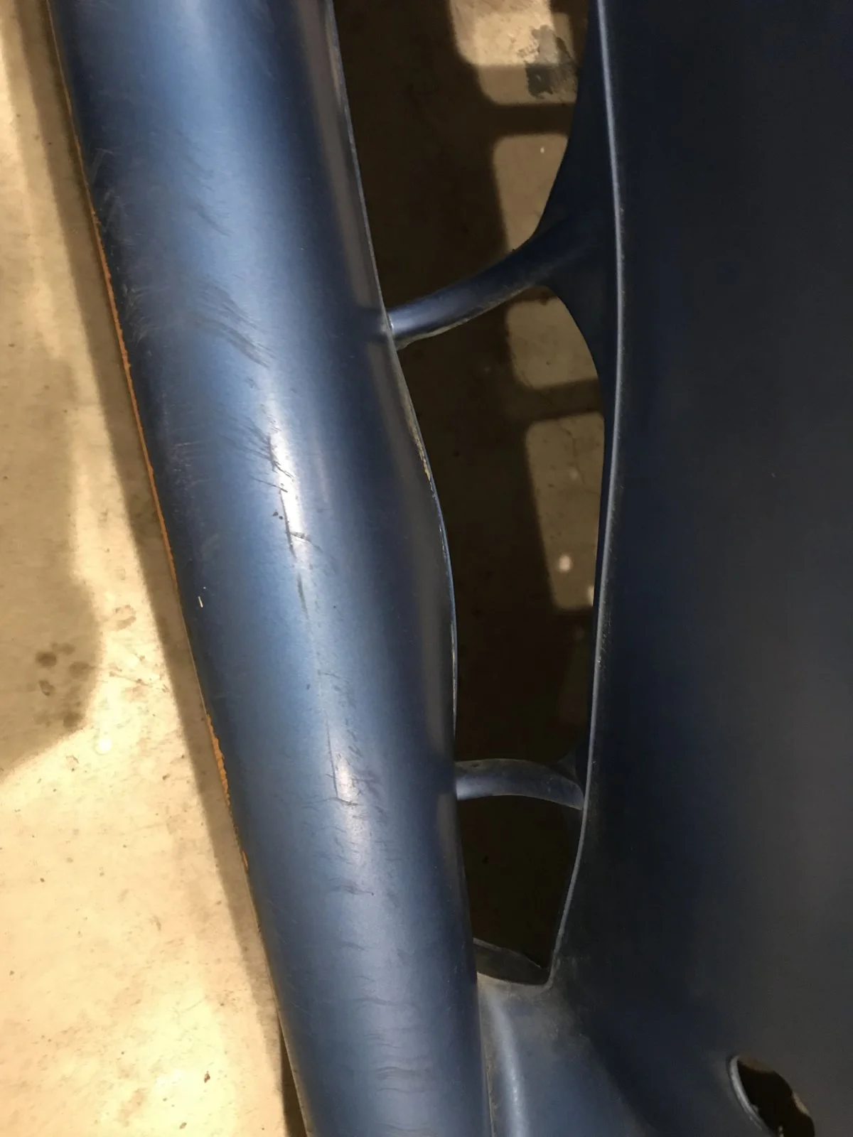

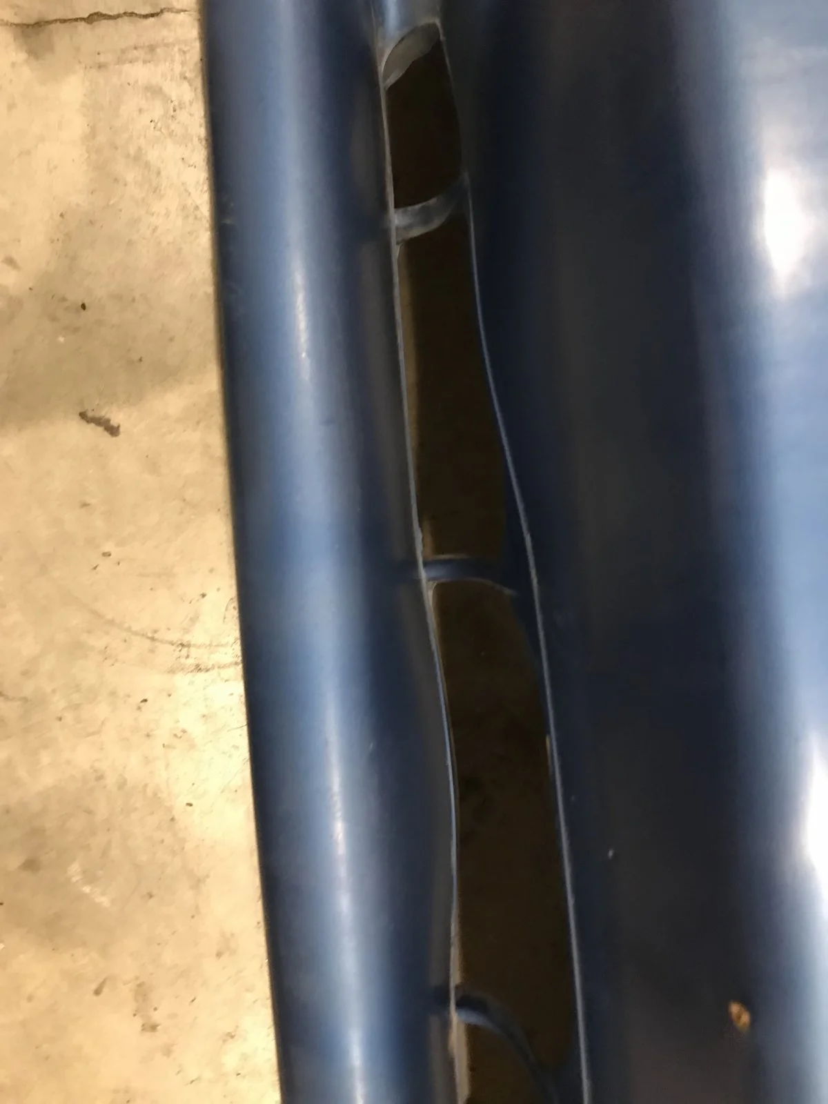

Davedacarpainter… prepping everything for essentially a scuff and puff. Pictures to follow soon. First question... dole out $300 for new front bumper cover or try and restore the old one... other than some curb scratches, a little waviness, and the original dealer holes created from the license plate holder (I hate Texas law requiring front plates) it looks useable...
Okay possibly can finally get back to getting this thing on the road... I finally have accepted that you either have time or you have money, but rarely both at the same time.
Easy answer for that is that for me I would fix the old bumper. It really depends on your learned skills and desire to repair stuff.
Post a picture of it for me, I can walk you through a repair easy enough.
Yes, repair your original cover. The replacement bumper covers won’t fit as good as your original one. Looking forward to seeing more progress. Nice work man!

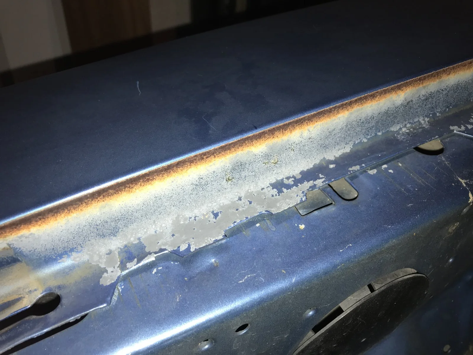

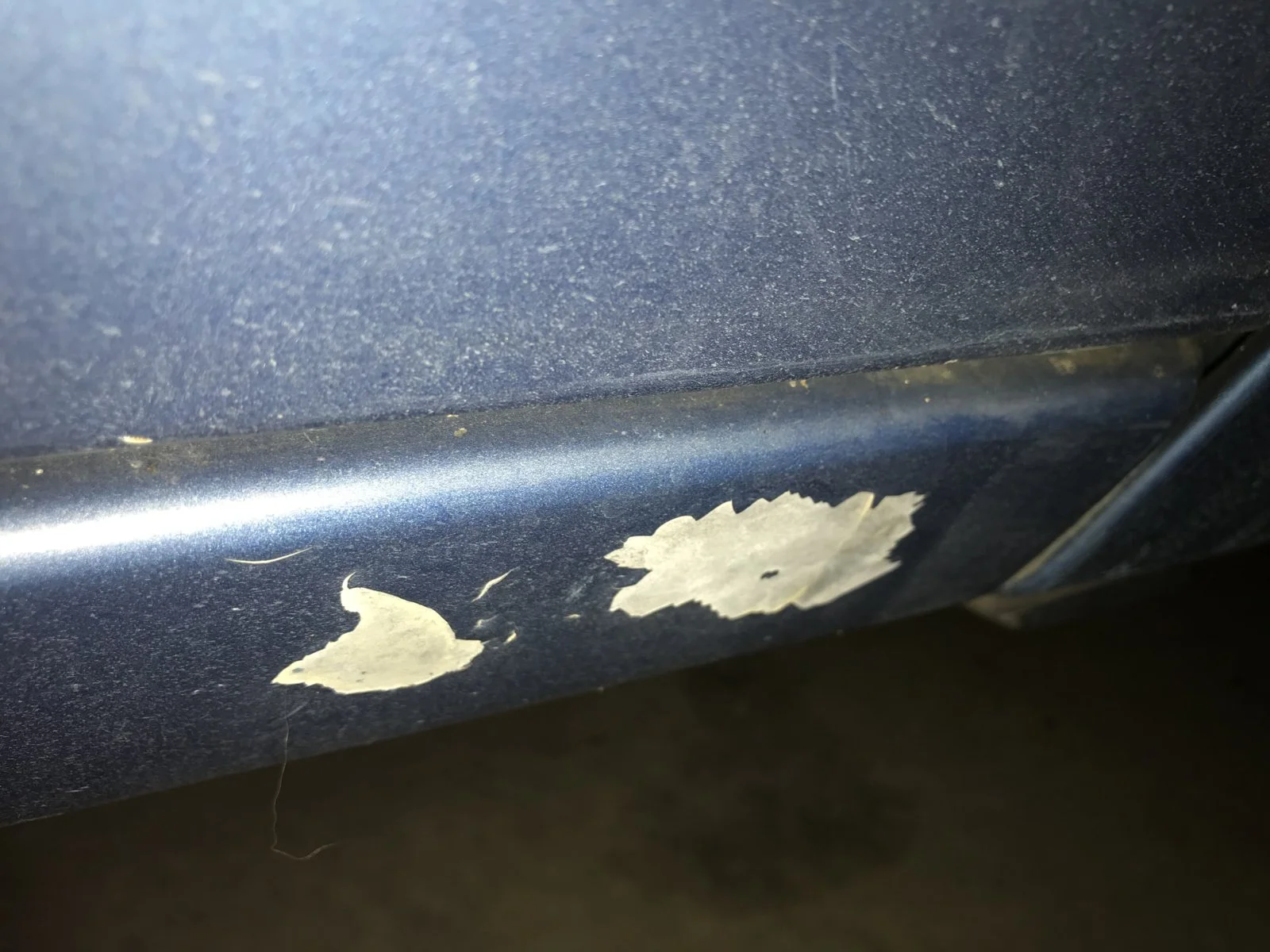

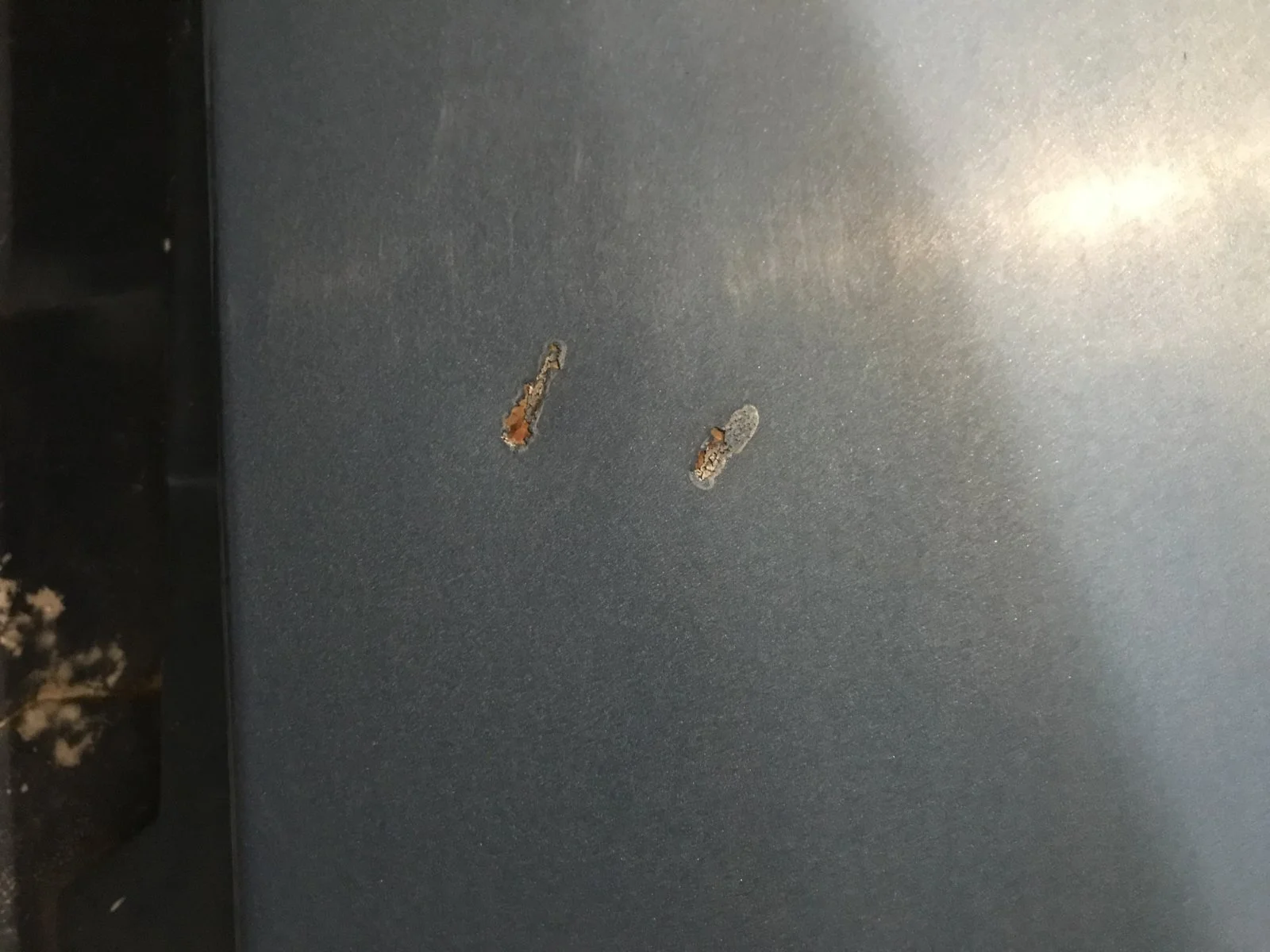

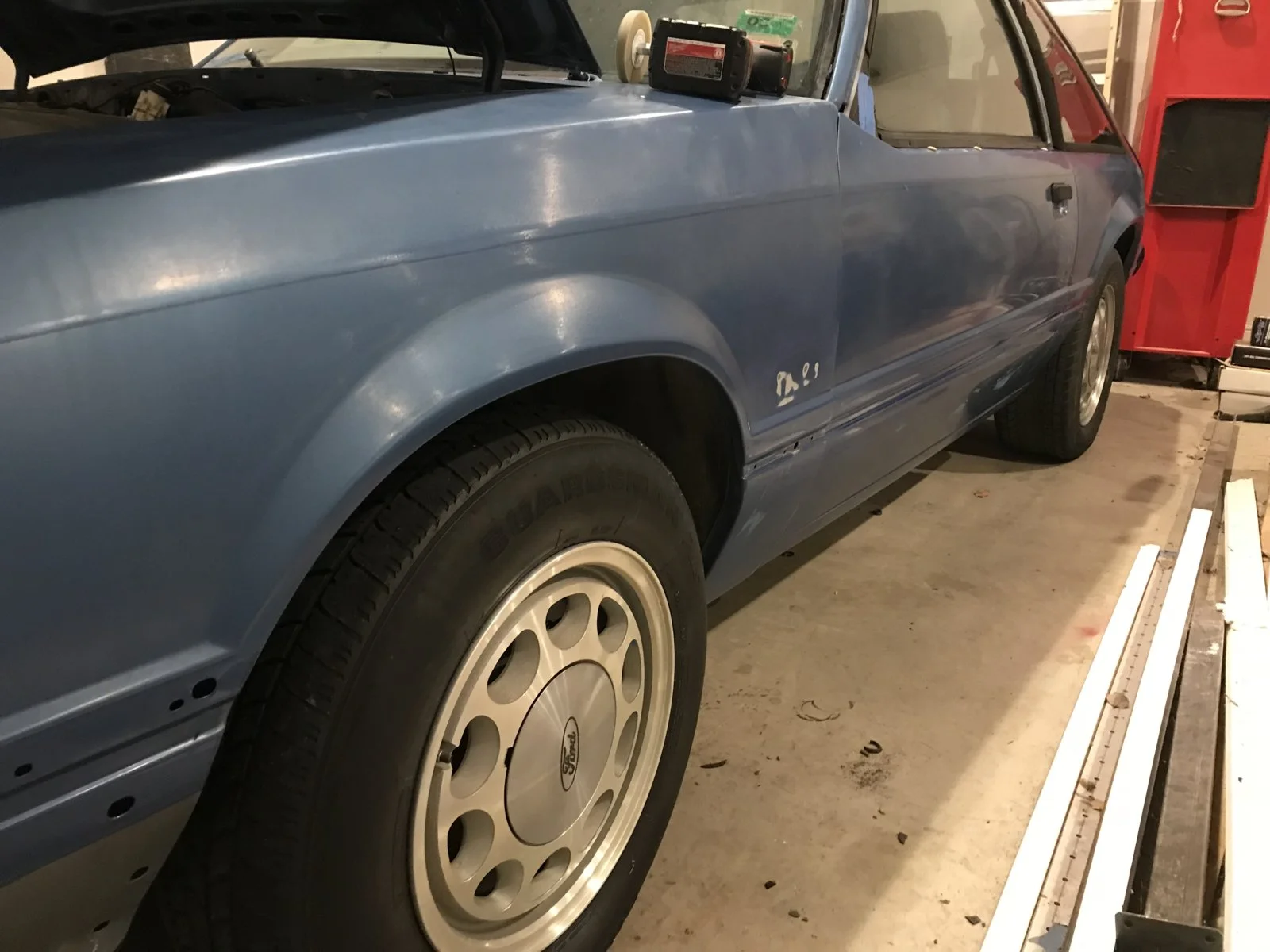

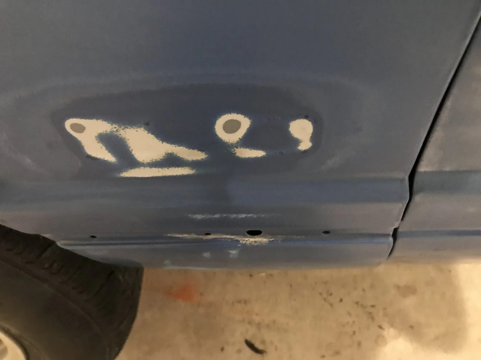

Here is the progress on preparing the rest... Still have a lot to go... The only body issues are the two small dents across top of fender from a highway air born object (lugnut?) that I was relieved when it didn't go straight through the windshield. The other issue is the damage to the lower right rock skirt that was caused by unavoidable highway debris that kicked up and took a bite out of the side but no dent. Then the surface rust at the top fender corner. I was surprised to see what was on/off the car when ford originally sprayed color.
The rocker has exposed bondo, it’s been repaired before.
The fender was repainted as well, it’s an easy fix on it though. The rust line you see in the jamb is very common and another easy fix. I might even guess that’s a replacement fender.
The rocker has never been re-painted and the fender has never been replaced. What you see isn't bondo, it is primer. The car has never been in an accident. The fender still has the little white build sticker that seems to be on every part. The rocker damage was due to running over some debris on the highway that kicked up and hit the rocker. In that area it looks like a very heavy handed color application from the factory. The paint is super thick there and for lack of a better word "brittle" it doesn't appear to have adhered properly the first time as it can flake off. I figured I would need to sand this back and feather it until I get to solid foundation. The fender is from parking it in the Texas sun most of its life... I will try to get a better picture of the rocker...
That bumper is in great condition, easy repairs there. Not a lot you can do about the waviness, it’s just the sht plastic Ford was using at the time.

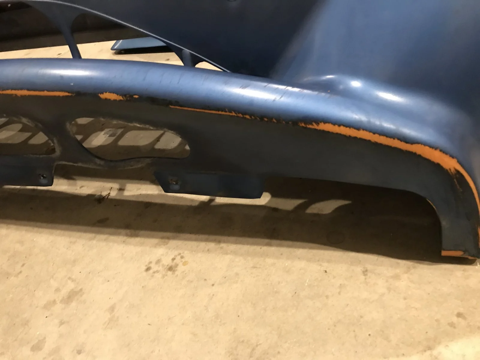

I started looking into a plastic welder with urethane rod to fill in the holes and one UV damaged low area. I have also looked at products from Isopon to bondo. Ranging from $40 all the way down to $4. Any preferences? The back bumper cover has the hairline paint crack issue that hopefully do not run too deep and can be handled by sanding and using a high build primer of some sort? Any advice is most welcome.
Ther best stuff I've used on the factory urethane ( yellow ) plastic is 3m4747. That stuff became one with the urethane. Its an epoxy and not cheap. But can be worked quickly. It doesn't work as well on abs or poly but it will fill any low spots, scratches, or tears in urethane.
Reactions: mrobins26
What you'll need to check on the rear bumper where the cracking is if the cracking extends into the plastic.
You'll want a primer intended for flexible parts when you work on it.
Hum, Ok.
Factory paint jobs from the eighties and nineties had issues with long term adhesion. There was an extended period of time that we were stripping complete vehicles and repainting them. LOTS AND LOTS of fords, ford paid for the warranty work and I made good money doing it, but I got sick of doing completes. Chevy had a mondo problem as well during this period.
The white layer on your fender is similar to the issue we used to have. It's not feathering out. It'll lift real easy there when you primer it. Spray a couple "dry" coats at first to help create a barrier from the solvents in your primer.
I've got to admit, a better picture of the rocker would help me see the issues.
I don't mean to comment when you haven't asked for my opinion btw. I'm not trying to offend.
Hum, Ok.
It looked like bondo to me too Mike.
