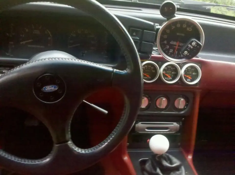

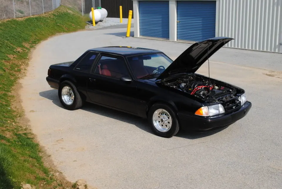

Hey guys im new around here this is my 89, had it for about 4 months now creeping around the forum. Im a car guy always have been, but new to mustangs learned alot reading these forums and the carol forums. Heres a list of mods some done by me the rest were done by owner before me.
Have a few questions if anyone out there wants to help. I drive car 3 days a week i have a jeep to so im thinkin of getting the nitto 555r tires anyone have good reviews on them compared to my MT ET Street Radials i dont drive it in the rain. also what heads do you guys recommend that are not crazy priced i see alot of people wiht trickflows but what ones are good for my aplication.

Nice car. I like the red/black interior myself, my old 90GT had that interior. A bit too much red, but it's not common at all for most cars on the road.
What size tires are back there?
