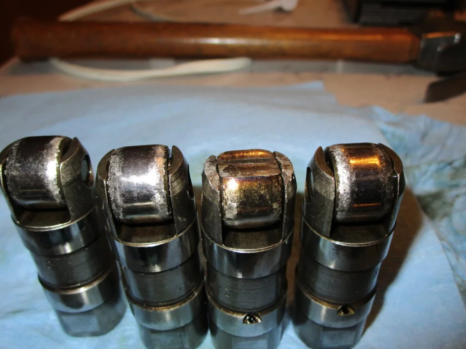

welp, i think motor is dead.
was at the track last night, missed 3rd. over-revved (i have no idea where bob put the limiter, i completely forgot to ask and assumed he set it somewhere reasonable). on the return road, started hearing a nice clack. got to the pits, investigated, found the #5 exhaust rocker was waaaaay loose. relashed, still clacked. did it again, and it was quieter, but still present. figure that lifter just collapsed and limped it home, with a couple instances of the noise getting louder for a few seconds, then quieter again.
got home today, pulled the upper and the drivers side valve cover, and the rocker was loose again. re-lashed, turned the motor so that that valve was open, let it sit that way for about 30-45 minutes, came back, and it was nice and tight like it should be. hmmmmm.
pulled the lower just now, and the #1 and #5 dogbones where sitting in the back of the valley. the #5 exhaust roller is slightly chewed on the edges, and the intake roller has a flat spot down to the fingers of the lifter body. peering down the lifter bore i can see the cam lobe is nice and chewed up too.

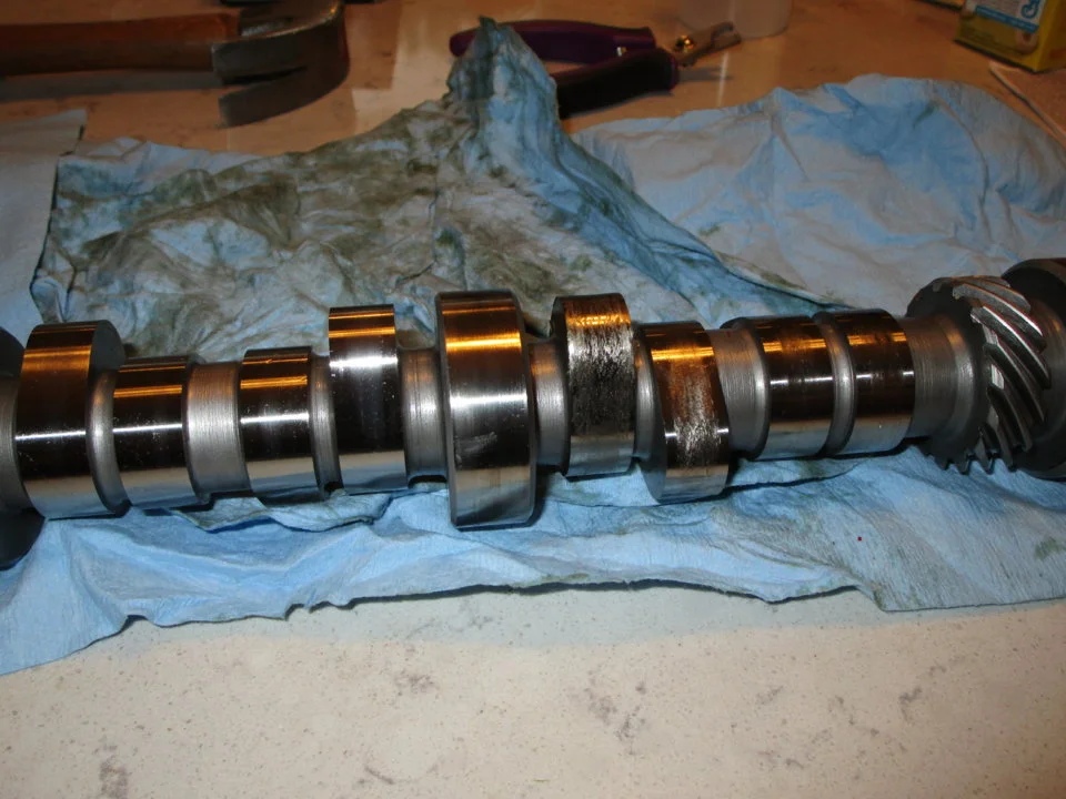

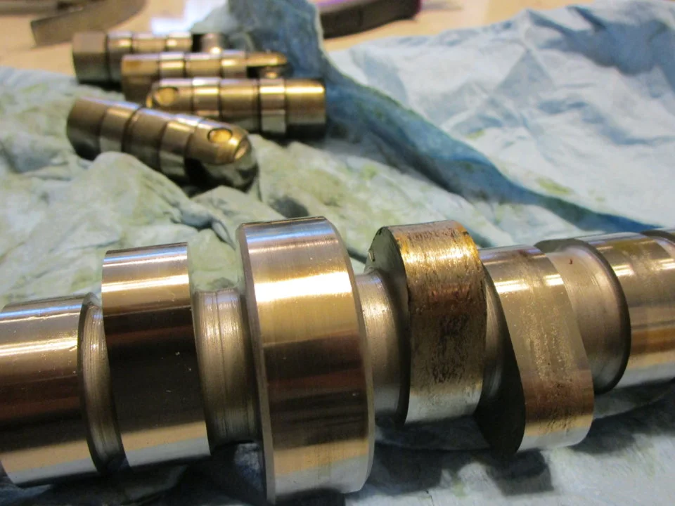

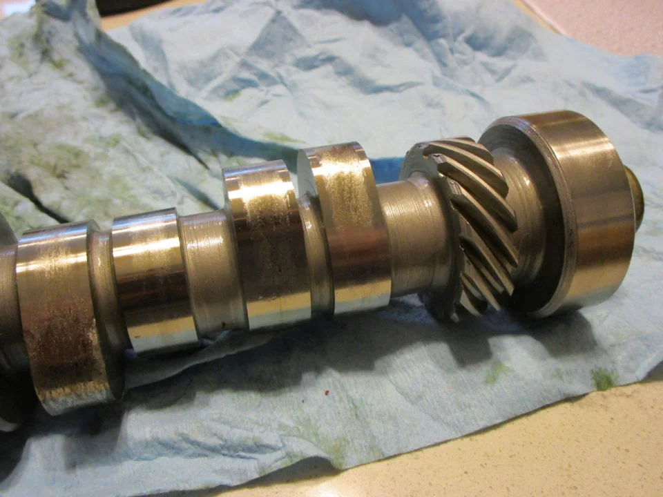

finally tore this thing apart enough for some carnage pics
the other 12 lifters and lobes were perfect, the dogbones just went flying on the front two cylinders (guess the spider is weaker there for some reason?)
the flat lifter was the #5 intake
dunno how much i can trust that none of that missing metal when in the oil system, or how much got trapped in the filter. kinda dont wanna put any more $$$ into this motor either.

You're not ok. When a cam fails at the track, and you stop everything spinning when you hear the noise, doing your best to limit the carnage immediately afterwards, you may be ok to run the engine again when you replace the broke junk.
However.
When you hear the noise, relash the rocker, drive the car, hear the noise, relash the rocker again, and then run the engine some more is equivalent to running liquid metal through the oiling system. Equivalent to I'd say........fill the bottom of a teaspoon w/ grinding dust, and then pour that into your engine at your next oil change.
For all those that had a cam/ lifter fail, and they replaced the broke junk and it " ran just fine" afterwards didn't look at the engine bearings in the months after the incident. Of the two flat tappet cam failures I incurred, one was allowed to go to the new owner after replacing the broke junk, and on the other, I pulled the engine immediately after the failure.
What I found after driving the second car 30 minutes after a loose rocker, was a badly scored oil pump, and metal embedded main, and rod bearings.
It alway kills me when somebody advises another that you'll be fine to drive an engine after a cam failure.
" Meh, you'll be fine, through some metal dust into the engine, I do it, and I've never had a problem."

I agree with Mike, that metal has to be somewhere, odds are it's trapped as he described.

i completely agree with you both. i'd be pretty confident that it hasnt killed a bearing yet, but i'd feel a hell of a lot safer pulling all the caps, taking the rotating assembly out, and washing the thing out, then throw new bearings at it. but i just dont think i want to spend that much money on an explorer 302 with probably close to 130k on it now, and it not be any faster or more reliable than what it was.
