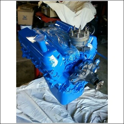

Cleaned it up first. Like layers of grease and grime on it. Painted it blue cause it isnt exactly a new engine so im sure it will probably leak somewhere. Did all the conversion ****. dipstick, oil pan, and put a double roller timing chain and new gears.
just got to buy new water pump distributor power steering pump and carb. thinkin holley 600 cfm. anyone know of a good mallory distributor to put in a converted 5.0.
gonna paint the intake black. got it from the family friend along with the engine. some retard painted it like a sparkle chrome and painted over all the screw holes and the gasket surface and carb surface so i had to use a tap hazardous chemicals to get it to come off. along with a razor blade.

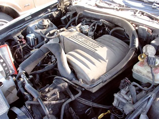

gonna by new valve covers 2. thinkin about those that say 302 powered by ford. this is about what it looked like before not the exact engine i forgot to take a picture of it. doesnt really show the amount of grease and how dirty it was when i got it.

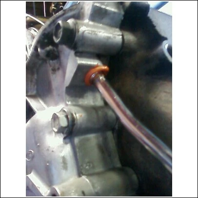

dipstick

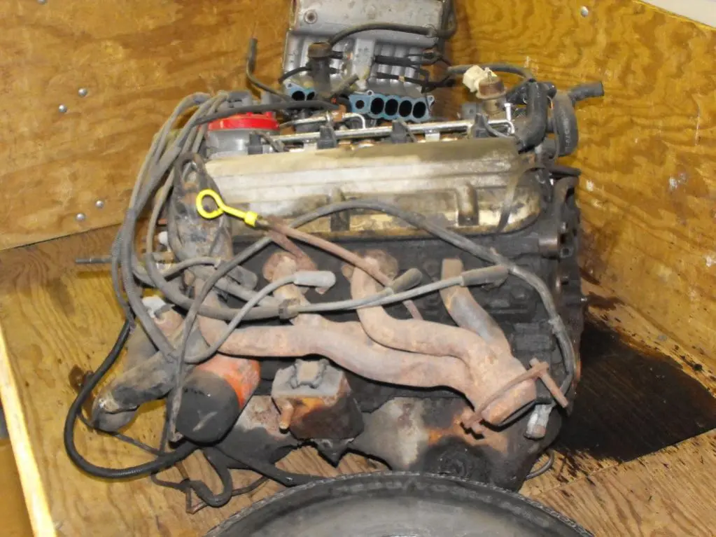

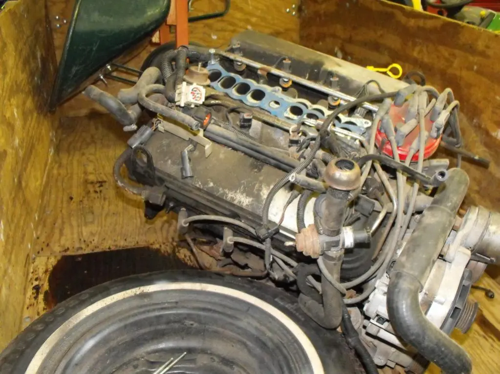

Im doing the same thing with a 87 5.0 I picked up. Right now Im doing a leakdown and a compression test to see if I need to rebuild it before installing the engine. Did you hear yours run? I didn't so Im on the fence on how much I want to do. Im debating on carburetor or EFI also. Your engine looks great painted up. Here is some pics of the engine I picked up. Im getting a lower than expected lead down on my tests on the cylinders. So Im going to try a compression test just to see what kind of #s the engine pulls.

thats basically mine looked like when i bought it. I was on a stand and covered in grease. it didnt have headers but it had a flex plate. apparently it was a turn key. i dont think the guy would have lied to me cause he was best friends with my dad and uncles back in the day. i had pulled the ban and manifold and it looked good inside, no rust. the cam had some wear but i think it will be fine. im gonna finish the car then go back and buy a rebuild kit for it. then once i have all the parts for it im gonna pull the engine and rebuild it. mine was out of a 91 Tbird
