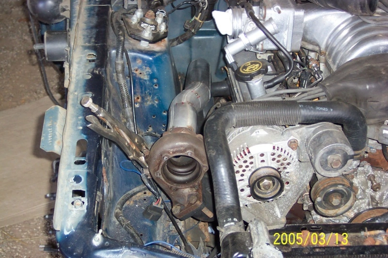

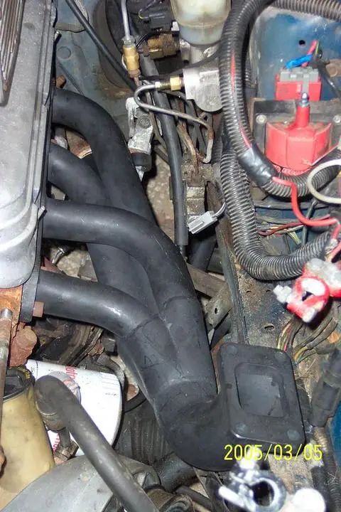

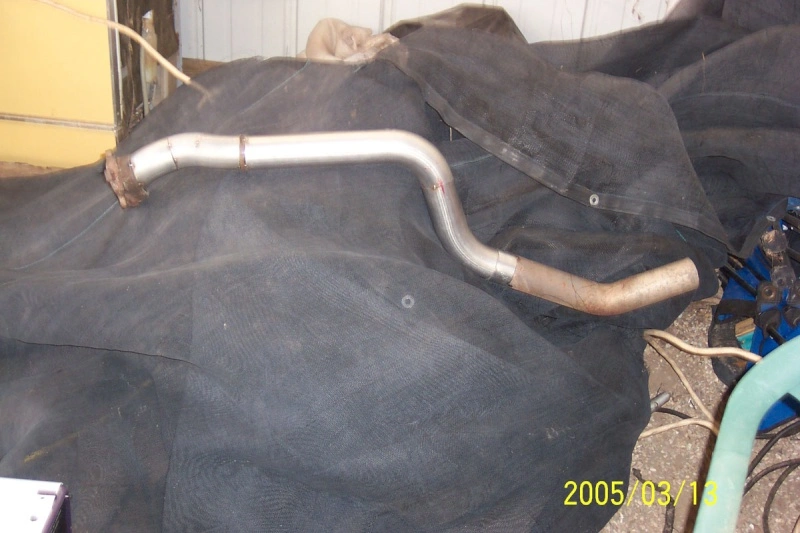

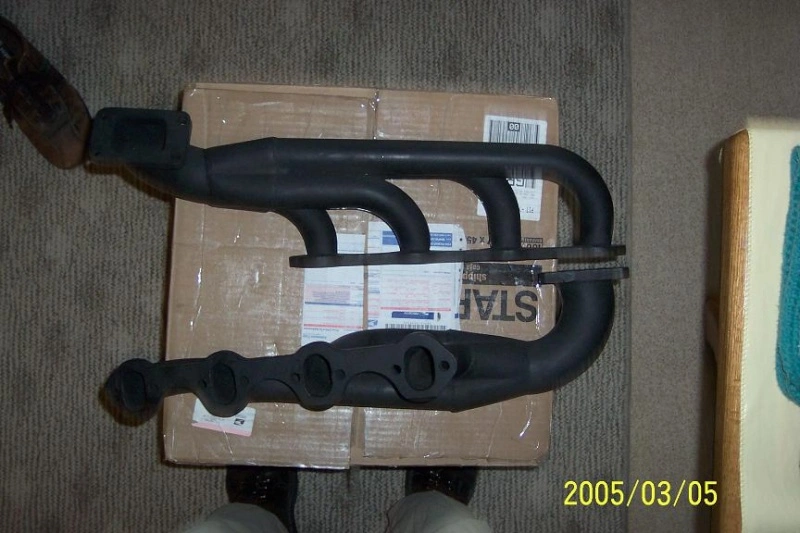

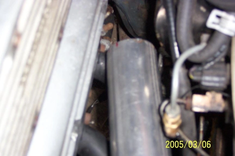

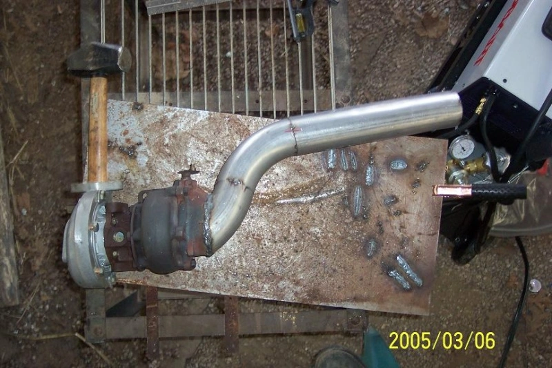

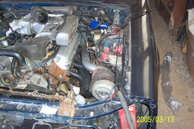

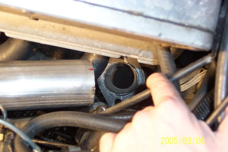

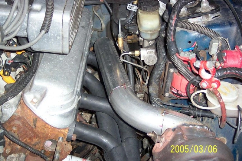

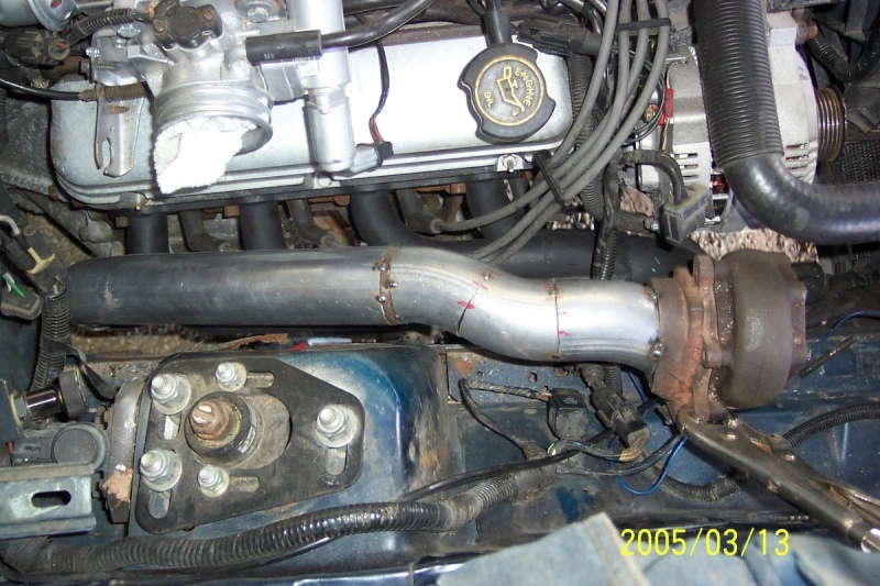

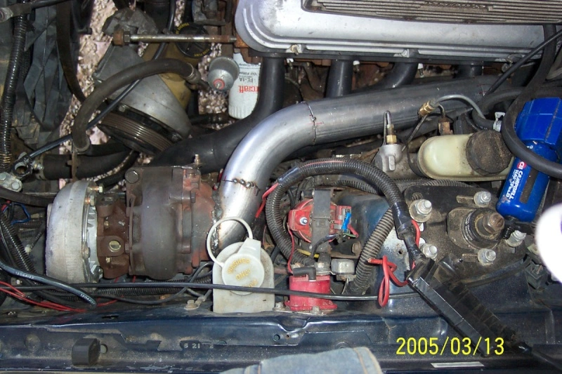

Just an update. I'm re-posting the pics as my old hosting site went down. I'm adding some dyno results and vid's at the bottom of this post. Soo....well start with the hotside....
Drivers side...
Passenger side...
