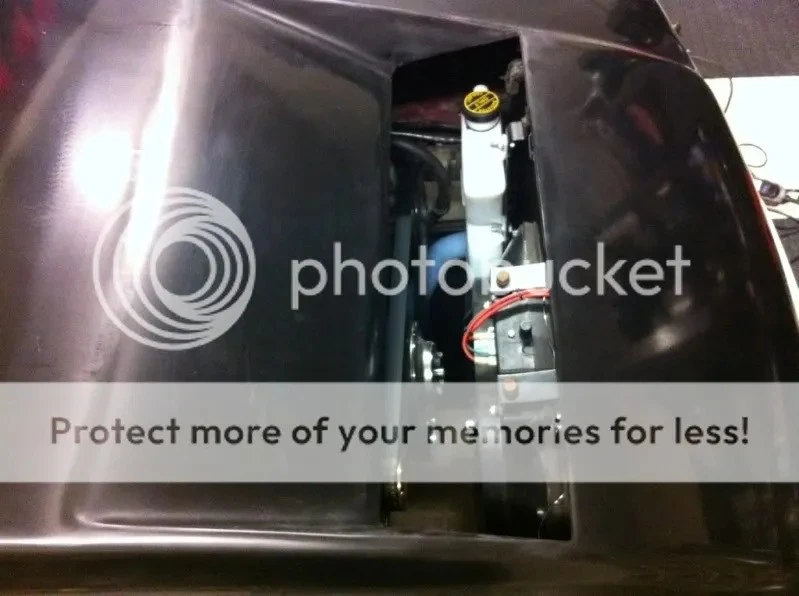

Maier Racing body panels, widebody, etc. Good reference for hood and splitter. What I mentioned about the hood is obvious from their panel, a huge cutout from about where the pulleys sit to the back of the radiator, as well as a cowl on the back, and cutouts to the left and right of the engine as well.

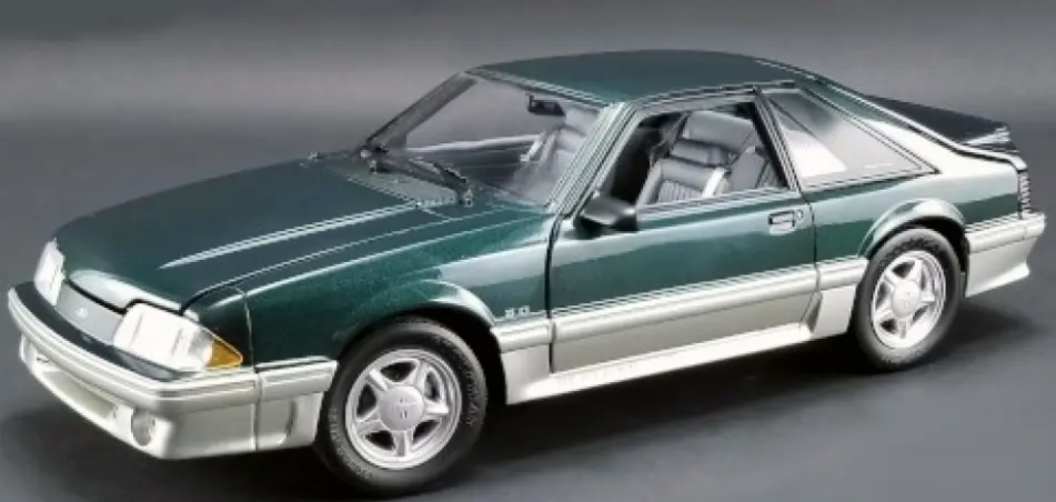

Meh... Start with something like this:
WOuld be interesting, but the downside is these 1:18 cars are pricey.
Realistically though they are lacking things you'd really need for it to be accurate, like windows, and lower radiator air deflector, and a flow-through radiator so you can model the airflow through the engine comparement as well.
The basic shape and panel lines are all pretty good tho... Yeah, you'd have to do some mods but I can't think of a better replica to start with. :shrug:
I'm fairly certain the car in the image above is missing the chin spoiler. :D

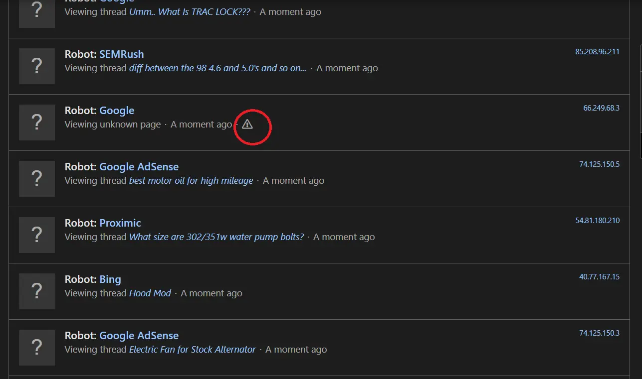

Here is a portion of just one of eight pages of web crawlers we see at any given moment:
The little red circle there is what happens when a crawler tries to access a forum it doesn't have permission for. It sees an error message.

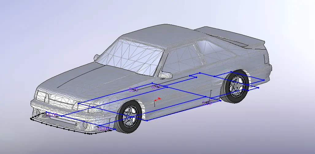

I bought the part file for $3 on that website and scaled it to the proper dimensions, and I'm looking into design for the undertray. Hopefully I can get this to a point where I can do a Solidworks flow simulation and use that to find design issues as well as points of interest and pressure on the body of the car. It won't be perfectly accurate by any means but rough is good enough for this application, and it does seem to be a pretty good model.
My main constraints that I'm focused on beyond just making a flat floor are:
-Splitter and diffuser design
-Brake cooling/ducting (Likely 2 small inlets on the bottom of the splitter to guide air up into the brakes like the performance packs on newer mustangs)
-Transmission cooling via a NACA duct
-Differential cooling and preventing rear end / suspension interference while still having a "mostly flat" floor
-Hardware and mounting bracketry
-Ducting or cutouts at the rear of the bumper to allow any high pressure air that makes it's way above the undertray to escape and not just create lift
Ideally this would be a 5 piece design. Front splitter, rear diffuser, middle tray, and 2 side skirt trays.

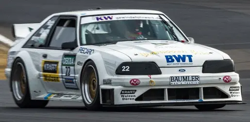

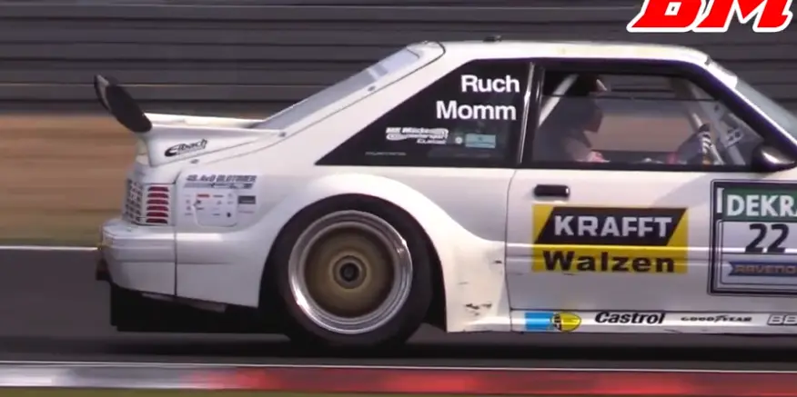

I also found pictures of a 1990's DTM car (Deutsche Touring Masters) that looks killer and is a good design inspiration. These cars did not win much in the series but they got the cool factor down for sure. I'd love to make a front bumper similar to the one shown. Just look at that wing... From what I understand it's a modified fiberglass GT wing with a huge upward slope molded into it, along with a big diffuser out back.
