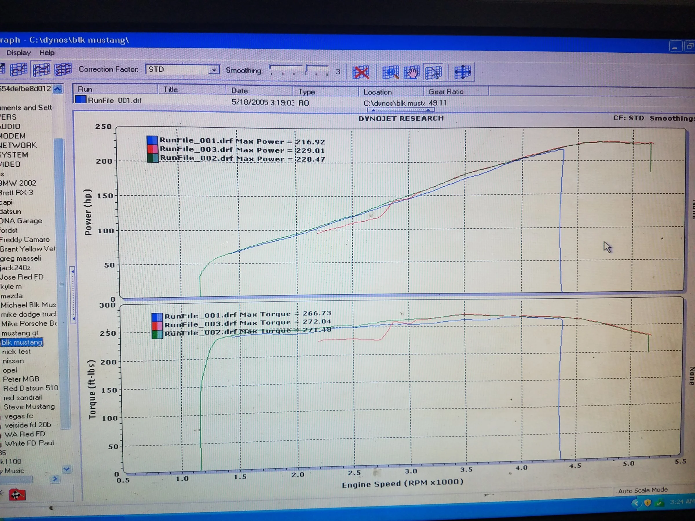

Hi everyone I just dyno my mustang does this look right it's a 1989 Mustang GT 5.0 5speed manual transmission it has Pro-m 80mm mass air meter Anderson Shorty Power Pipe 65 throttle body Holley systemax intake manifold upper and lower 1.7 rocker arms 24 injectors BBK shorty headers Dynomax super turbo mufflers with pipes 190 fuel pump timing is set at 12. 355 rear end gears aluminum driveshaft the car still has AC stock 4 cats mishimoto radiator 3 core 180 thermostat NGK spark plugs iridium 229HP 272TQ stock heads. Stock Cam

Yeah those numbers look about right for what you have going there. You have plenty of intake ect., but the stock heads are a bottleneck and the 4 catts are very restrictive. You could possibly pick up 8-10 more if you bump the timing on up to 14 degrees.
If you get yourself a nice set of heads and maybe a cam while you're there it'll be well worth it.

I don't know about 50 state legal but I have the same intake as you. Under that I have a set of Edelbrock Performer RPM heads and Trick Flow stage 1 cam. That combo made 300rwhp and 330rwtq. Now I have a supercharger on the mix so it makes a little over 500.
