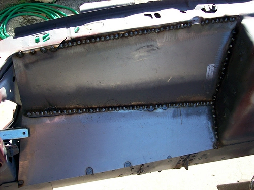

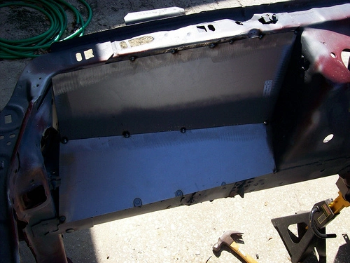

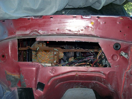

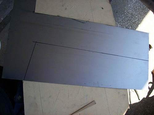

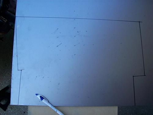

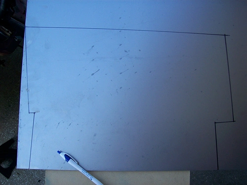

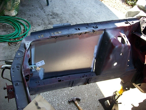

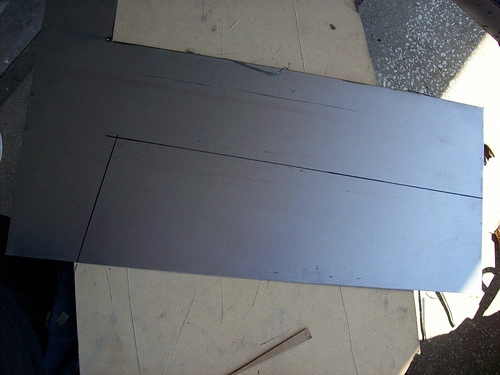

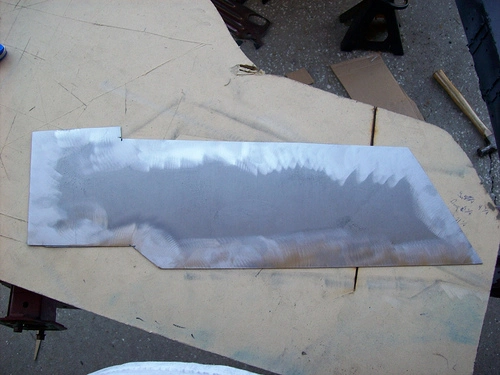

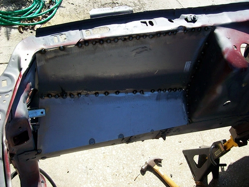

My engine bay and the reconstruction let me know what u think.
2241805675
well that is my progress so far i still have the rest of the bay to do

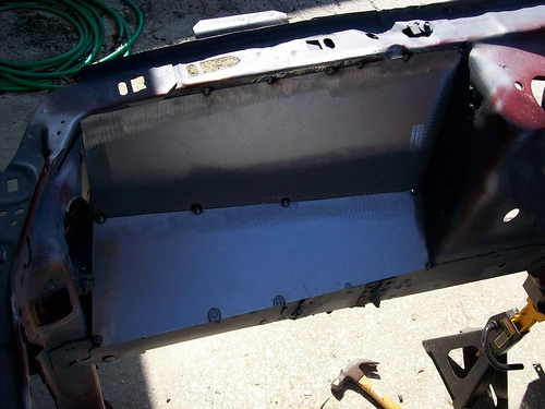

Keep the pics coming! Don't let the hours discourage you! What I usually do, is tape a picture of a finished and smoothed engine bay to the windshield, and that is my motivation!!!
Good work!
i like it, i may be getting a beater soon, if so i will be doing my engine bay but not to the extent that everyone around here is lately!
keep the pics flowin'!
yeah i couldnt either once u get to doing it there is alot of them one thing that helps tho go and get a brass bar and hold it behind the hole ur welding cause it wont stick that way u can just put a contiunes blog so to speak instead of pulsing and takeing twice as long

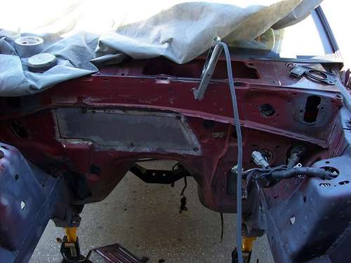

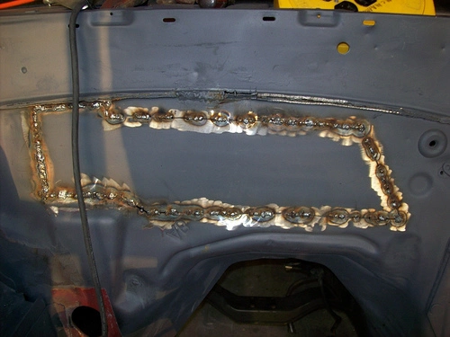

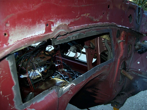

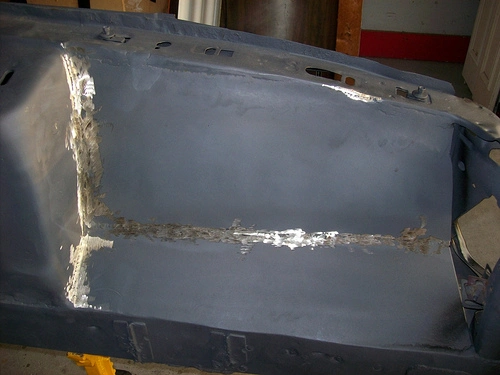

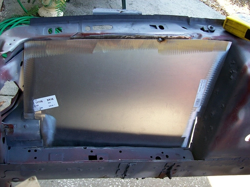

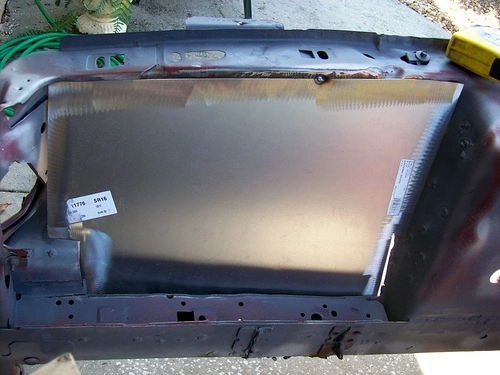

my engine bay ( more progress pics)
i a lil bit more work done i spent most my weekend helping chromdoutdubs finish his mini tubs and putting in his new coil over rear end suspenion but what i got done was getting rid of the ridges on the fire wall let me know what u think
ok quick question for all of u who have done n e kind of body work. In my quest to make a very nice looking engine bay, what would be the best body filler out there all i know or have heard about is bondo. so my question is, is there n e thing better or more suitable?

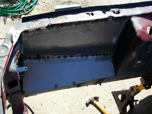

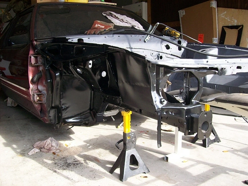

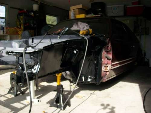

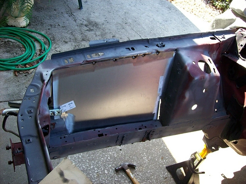

FINALLY!!! got some long over due work done
The new rims about 3 grand a pop lol:nice:
finishing cleaning and grinding the bay tomorrow hopping to start bondoing fri or this weekend
let me know what yall think
