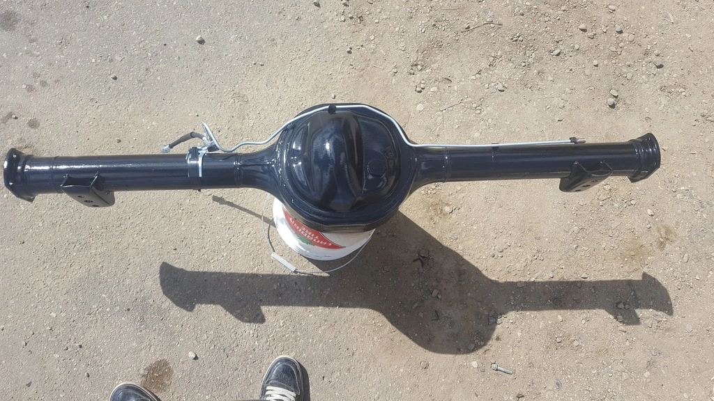

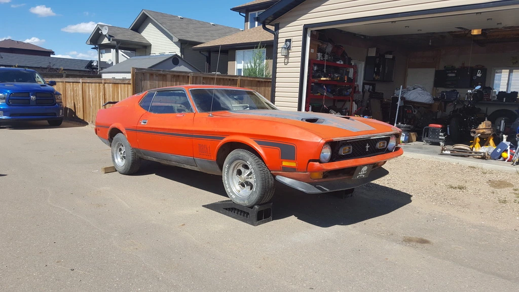

Might as well throw in a couple more pics too. The housing after paint and a shot of the car on ramps.

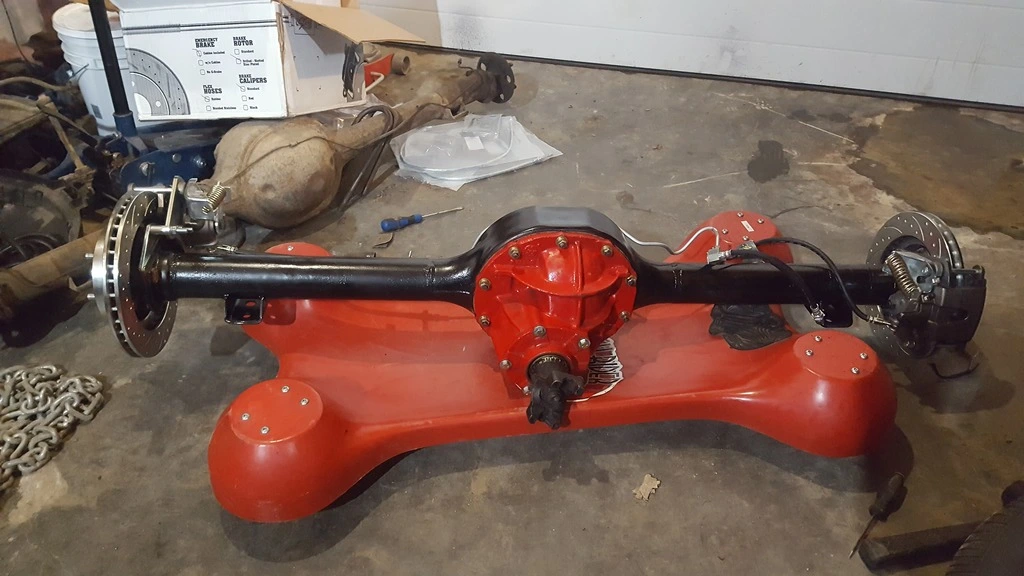

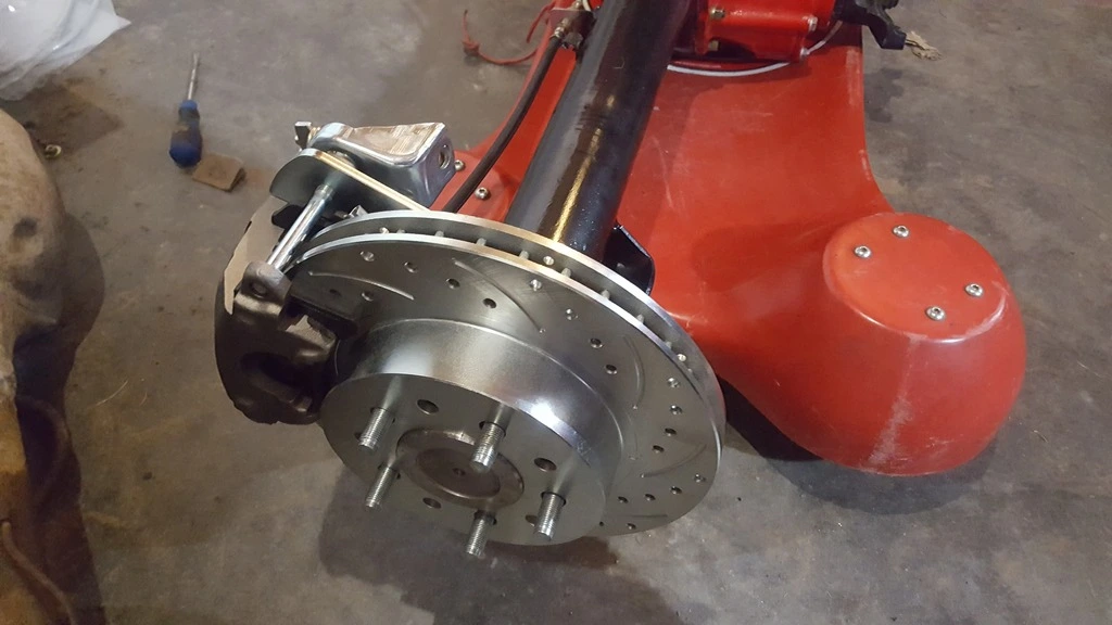

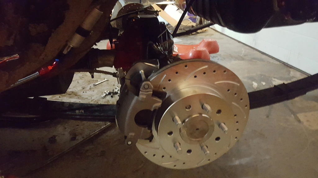

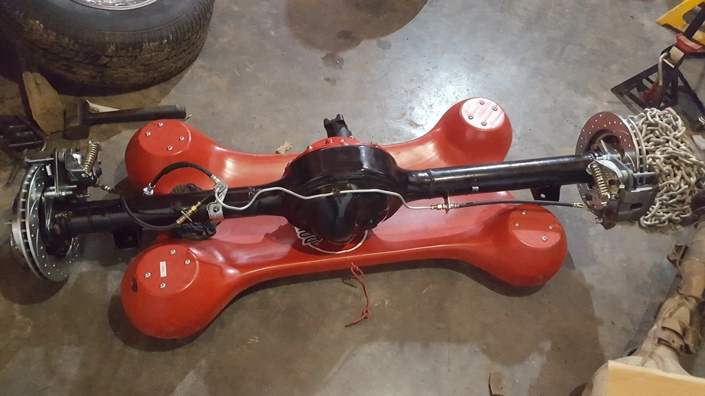

Well the guy at the machine shop went the extra mile to fit in my bit of work today so I got everything mostly in place; still a ways to go but this rear end swap is in it's final run finally. Going from the well aged open diff 3.25:1 8" rear end to a posi 4:11 9 inch.
I am really quite happy with the Right Stuff disc swap; the rotors look awesome (although I'm not really a drilled rotor fan) The setup and install of everything was really quite straightforward (I still have to actually do the Ebrake cables however). Overall the kit is pretty great value for the price. I did have to reduce the fitting size down for my hard-line though (easy to get fittings). Would be nice if the hoses were somewhat shorter, but really not a big deal.
