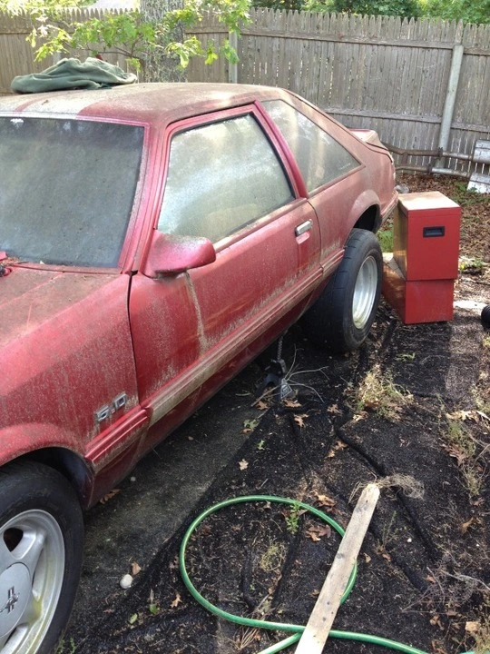

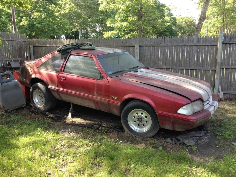

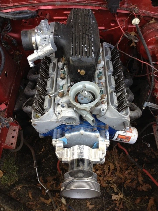

Its been sitting for a few years in my brothers back yard and talk came around of him parting it out selling parts. I started to help him sell everything but then something came to mind. How much would he sell everything in one shot for? He said a number, I agreed, now I own this hunk of junk. Ive always been a import guy and although I know how to work on these things for the most part, kind of know my way around and not having any other projects going on this season, I figured why not convert over to the dark side. So here I am finally a Mustang owner. Not sure what to expect out of it performance wise. Just trying to get this car running and drive it/weed out issues that a 25 year old car would have and sitting in a back yard rotting away for 3 years.
Reason for him selling: He couldnt get pulse at injectors and couldnt get spark. 2 things I am not worried about diagnosing. He lost all focus and drive and gave up. Here is how I got the car:

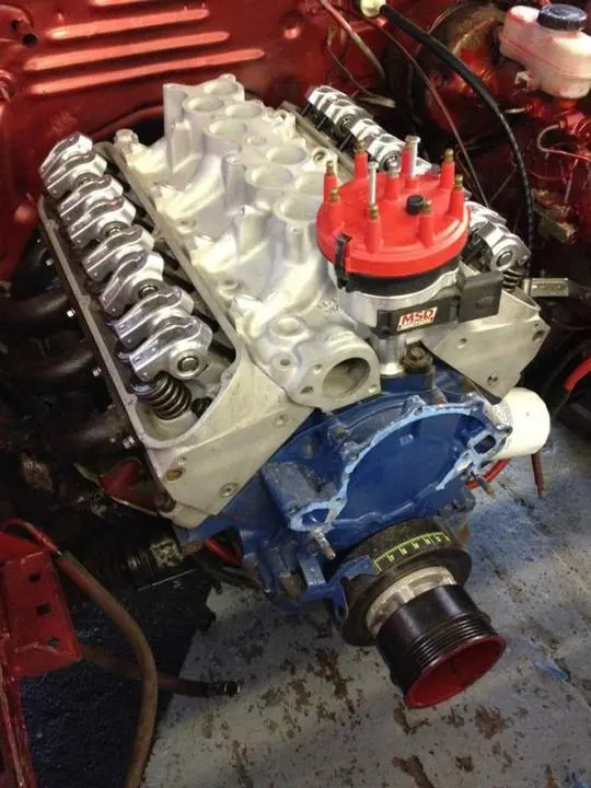

3 years ago he had the motor rebuilt by a local machine shop. Stock 302 bored .030 over to 306, stock crank, eagle rods, JE pistons 9.6:1 compression on 60cc heads, F303 cam, edelbrock 60379 heads, ARP hardware, all professionally balanced & assembled. Motor sat for a long time but I primed it, turned crank by hand, all seems fine.... I hope. Wont know until I fire it up.
So I went ahead and started changing things about the setup I didnt agree with or like. Also it was missing a bunch of parts I had to order so above pics is all I had to really work with. So I ripped into it a little, cleaned it up and started buying parts. Here is the progress:

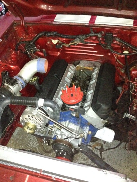

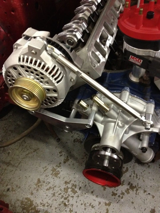

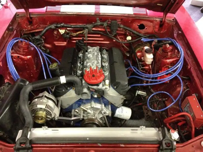

So what I have added to this motor was a SN95 alternator, 1.7 roller rockers, gt40 upper and lower intake manifold (ported), 70mm TB, 3/8" egr delete spacer, C&L intake, MAF conversion, walbro 255 fuel pump, SCT chip custom to ignore egr, evap, etc. MSD distributor, MSD TFI coil, MSD 6AL-2 box w/ 2 step, 2.5" off road hpipe with new O2 sensors, new IAT and ECT sensor, 3 row full aluminum radiator w/ electric fans/shroud, hoses, belt, blah blah blah. All the small stuff to make it run.

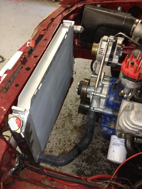

Had some time to get radiator in, install wiring harness, and paint the valve covers. I dont have much time to really work on this much with my schedule but I found a couple hours today to make more progress. Still waiting on the lower manifold to come back from porting then I can really put a dent in this assembly. Here are a few pics
Wow. Big improvements already. Well, at least it looks like you are automotively savy, so thats a plus. These cars are getting older, so a lot of times our go fast budgets turn into restoration budgets. Post up some pics of the TMOSS intake when it comes in, I'd love to see it. Keep it up!

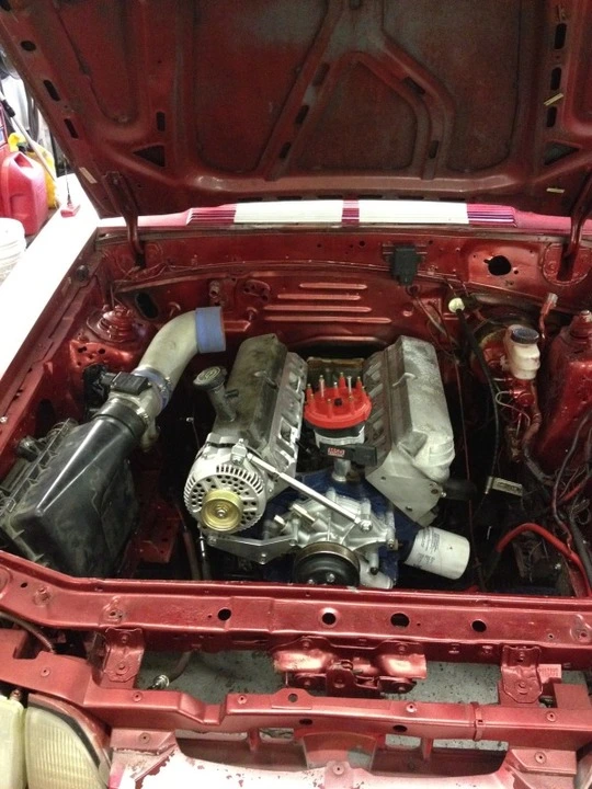

Had a few more hours after work today. I just need a day off to finish this thing but I dont have it for another 2 weeks. Next time I touch this wont be until next week sometime. I got the fuel stuff in, coolant hard lines, lower intake manifold torqued down, some ignition stuff in, etc.
I still have a nest of wires to go through and wire to starter solenoid and have some vacuum lines to figure out. I also ordered a UPR battery relocation kit. I wish I didnt work where I am working on my car or I would call in sick FML!!!

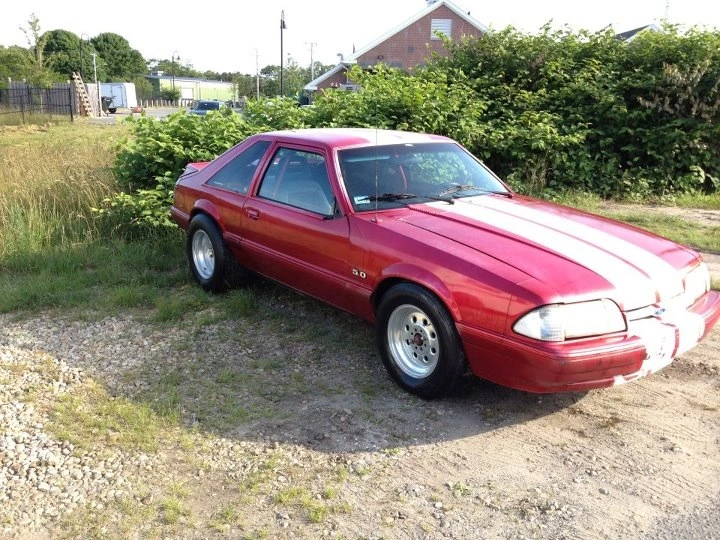

Here is how it sits
