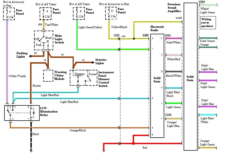

I have some questions about a wire and the inertia switch. What is this wire for?
...and which picture shows the inertia switch tripped and which one shows not tripped?
That red wire goes to ground for the radio. Its the stupidest thing I have ever heard of.
Thanks! I was completely stumped on that one.

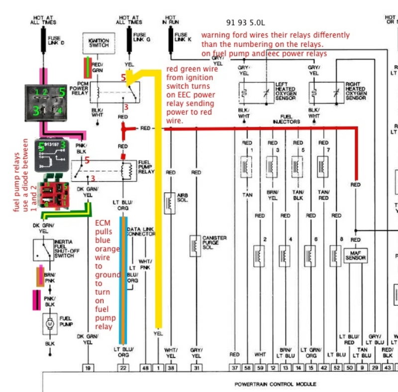

Without the computer controlling the ground it won't turn off....it'll run constant. I don't see it being a huge issue. When the var is running it runs constant anyway, it's just a way to keep from overheating the pp when the key is on but the motor isn't running.
The blue with orange stripe is the ground trigger for the FP. Your car should be similar to this schematic
Reactions: stangboy
Yeah, I was referring to that diagram(@jrichker posted it a couple games back in his troubleshooting article). I'm just wonder what could have happened to those wires because the car was running fine before I tore it apart to do this build. Just another reason for me to regret doing the dash swap.

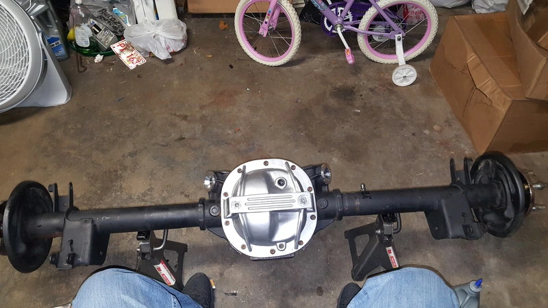

Also I cleaned up and painted the replacement rearend housing that I bought. I have come to the realization that when, the first shop that built it, welded the axle tubes they didn't put it on a jig to insure the tubes wouldn't distort from the heat. So from the noises coming from it when we loaded/unloaded it on the trailer to bring it to my house and pushed it into my garage, im pretty sure the axles tubes are the problem. They're probably worped enough to make noise but not enough to keep everything from moving internally. So I bought another stock housing and will have my engine builder put all the internals in the that one...crossing my fingers and praying that none of the internals are damaged. Yes, his shop builds rearends and transmissions too. The only reason I didn't go to him from the start was because he's about and hour drive away and I wasn't ready to build the rearend when I had the shortblock done. So I found a shop locally to do it. BIG mistake on my part.

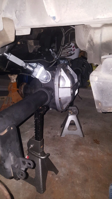

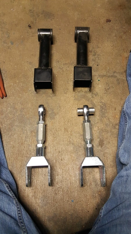

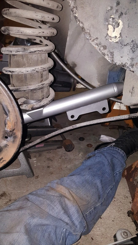

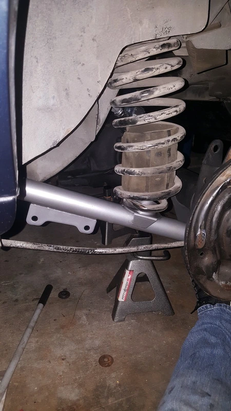

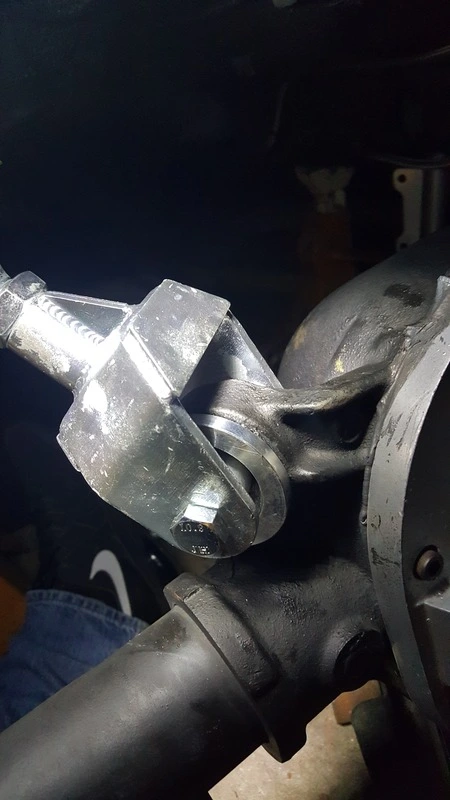

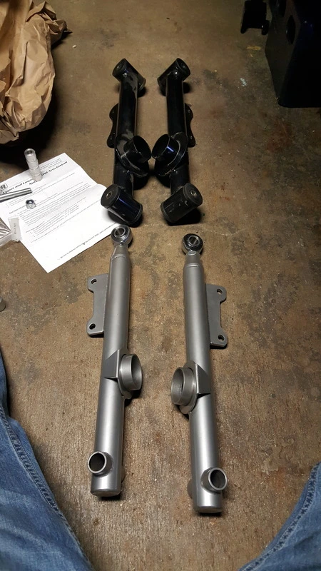

Well, my car has a rearend again! I sure hope it doesn't make that horrible noise it made before. I'm almost positive it won't tho. This is a completely different housing.
I took the SVE upper and lower control arms out and put in the UPR adjustable upper and lower controls arms. Look how pretty!
I did all of this while the Superbowl was on. None of my teams were playing so I found something better to do.
