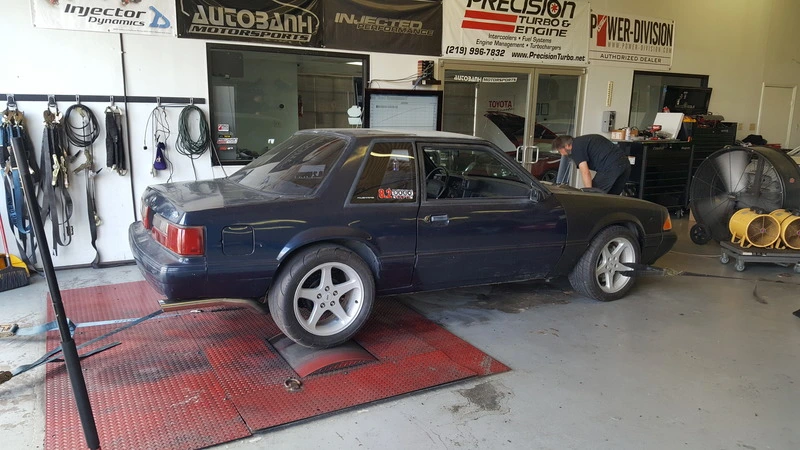

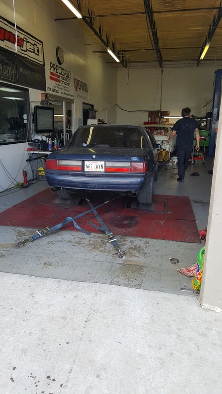

We arrived at the shop at 10:00 on the dot. My buddy made good power with his car(650rwhp). Me, on the other hand, not so much. The dyno exposed everything wrong or not all the way right on my car. I went in with an exhaust leak that the muffler shop couldn't get out because out of the box one of the ball flanges had a nice dent in them and he wasn't able to seal it all the way. I was wondering why the car would idle fine as long as you don't move but as soon as you move it would die when coming to a stop then it would search for idle when you start it back up. Well that turned out to be a massive vacuum leak. I didn't retorque the lower intake bolts after several heat cycles. Another thing that the dyno exposed was leaking valve cover gaskets. And something I found out after all of this disappointment and embarrassment was that all the intake rocker studs need thread sealer or it will suck oil pass the threads and into the intake ports. This cause a fair amount of smoke out of the tail pipes after several pills on the dyno. It had me uneasy because I thought I might have been running too rich all those times I let it run at home getting heat cycles in it. All I could think about was Scott's brand new motor that he washed the cylinders down running too rich. Then I was thinking, "were those idle heat cycles enough for the rings to seal?" I was as nervous as a hooker in church. Did I mention this was my first time having any of my cars dyno'd?
After we left the dyno I never took the car off the trailer the whole time we were at TX2K17. The next day I pulled the valve covers and upper and lower intake thinking my pushrods may have been too long. After talking to Jim at FordStrokers.com he assured me my pushrods were not too long, if anything they might be a little short. Mine are 6.400" and he said setups like mine are normally around 6.500". Thats when he told me about putting thread sealer on the intake rocker studs. He also told me to relash all the valves and I should be ok.
Now I know you're wondering how much power did it make. It made a measly 365rwhp. The power was falling off like a cliff after 6k rpms which had me kinda stumped because the cam was ground to make power to 7k. But I quickly figure I needed better valve springs. I thought I asked the guy at Cam Motion if the cam came with a set of springs or was their springs they recommended. I could have sworn he said no. Anyway, I emailed Ed Curtis at FTI and asked him what valve springs he recommends for my cam. He just got back to me today with the set he recommends. So I'll be getting those in the next month or so.
Here are some pics and videos. I am not very proud but it is what it is. At least it didn't grenade on the dyno. :shrug:

And short of having to go back through your thread and look, how big is your engine anyway? If this thing is a N/A 306-331, 365 WHP isn't measly. It's all about Torque in a street car anyway,...what did yours make?
The problem is you went to the dyno w/ a terminator. You cannot hope to take that engines thunder until you step the block up, and put some sort of wheezer on yours.

365? With a vacuum leak and assorted "issues"? Not bad at all:nice:
Once you sort it out you'll probably pick up a few more hp's and you still can add forced induction down the road and have "terminator" power.
Car sounds awesome btw:nice::nice:
Reactions: stangboy
That pretty new engine of yours ought to make a good more than that though, right?
I know you said you thought your cr was 9.0-1 though.
Still, dart 363 with afr 205's and all the rest of those pretty parts. Ought to be close to 450-500 rwhp maybe?

The contact patch on the valve was a little wide but it was in the middle. My ci. is 363, Dart Sportsman block. As for torque, it wouldn't register because the tuner said that the MSD box was throwing the dyno off with the multi-sparks that it couldn't even give an accurate rpm reading therefore unable to give torque numbers. I didn't question it because I didn't know any better.

With compression between 9:1 and 9.8:1 I was hoping for around 425ish. The discrepancy with the compression is the engine builder said the pistons are in the hole .020" but what I measured was less than that. So with my calculations from my measurements I got like 9.8:1.

I think a vacuum leak and potential valve spring issue could be costing you a considerable amount. What are you tuning the motor with(ecu wise)? Stock electronics may not net you the most power also.
Getting the motor to go cleanly above 6500rpm...hard to do if the springs are weak,systemax intake(n/a they peter out around 62-6500),the ecu,msd ignition,and a few mechanical questions. Just my thoughts.
