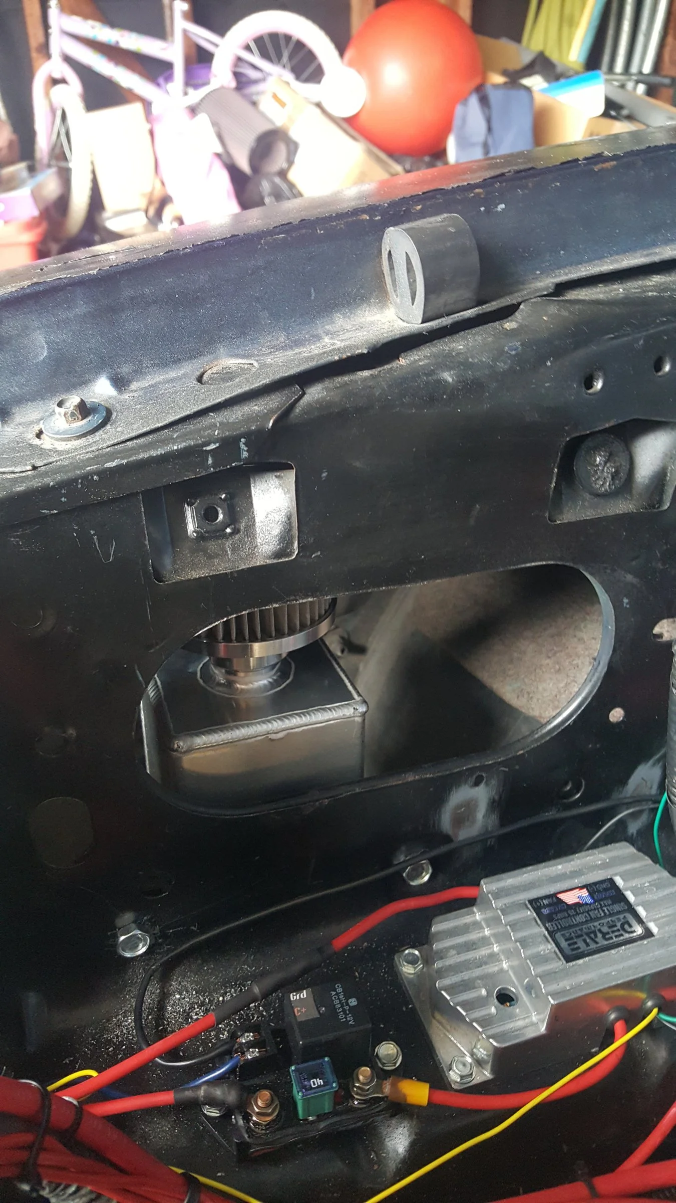

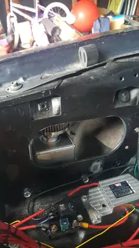

Well I bought an oil catch can. I found one on Amazon for half the price of the UPR catch can. It seems like pretty good quality. It looks nice and has beautiful welds. Of course I forgot to take a pic of it before I installed it. The only place I had space to install it was inside the passenger fender well where the stock air filter got its air from.
The car runs noticeably better. It idles better and it runs better overall.
As for my other ongoing issue, controlling my fan, has been extremely irritating to say the least. Apparently 12g wire wasn't heavy enough to handle the current that was running through them. Which was probably/maybe/still unsure, is causing my issues with the fan coming on at the temp it was supposed to but not cutting off when it got 10* below that temp. Which caused the fuse on the relay board to blow because it would get too hot. After talking to @TOOLOW91 I figured out that I had things wired backwards. But by the time I changed things around it was kinda too late. When I changed the wiring around I noticed that the relay board was all warped and distorted from all the heat the was generated by the current passing through those wires constantly. And the controller still didn't cut the fan off once it came on. The water temp got to almost 220 the last time I drove the car(Friday evening) because once again the fuse blew. You can see in the pic of my catch can how distorted the side of the relay board is and the discoloration on the wire connector. In the pic everything was still wired wrong. I changed the wiring around after I took that pic.

That breather looks familiar... I've got the same one mounted in the same location. :nice:
For the money its very hard to beat.
Keep an eye on the screen for the breather on top. Its not stainless and will rust. Mine has been holding up well for a few months now.

I'll definitely keep an eye on it with the damp climate we have here. A lot of stuff(ARP bolts and a few other things) had surface rust on my engine before I was even close to starting it for the first time. Even my oil pan had oxidation on it.
