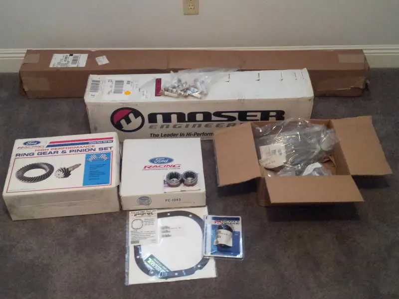

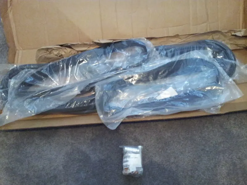

The parts I ordered earlier this week arrived today!
Subframe connectors(long brown box), torque box reinforcement kit, gear install kit, axles, studs, leather shift knob. Oh and I put the gear in the pic too(that was a Christmas gift from my dad).

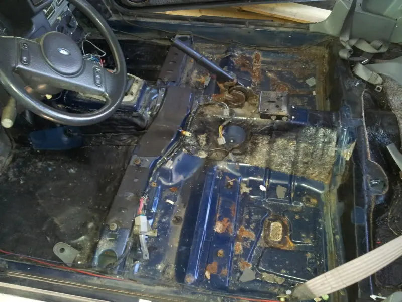

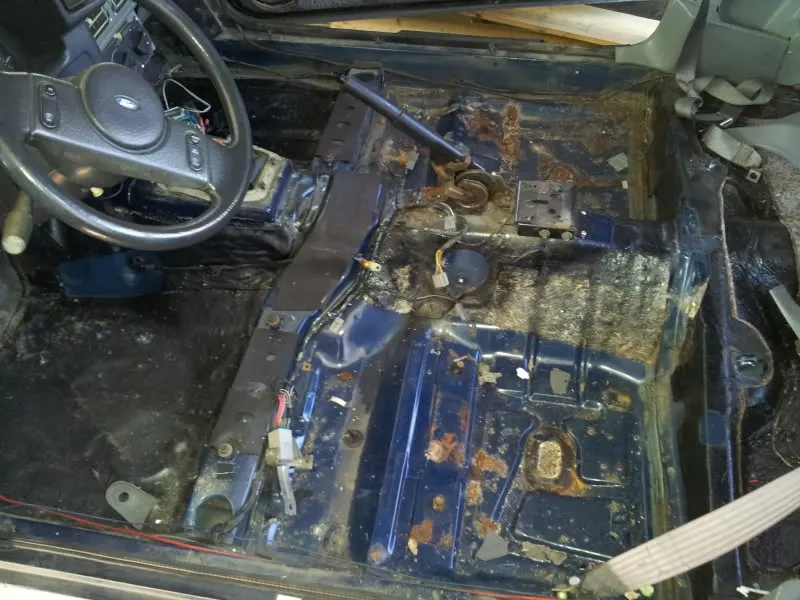

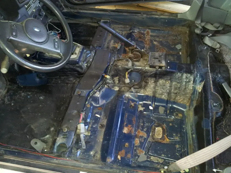

I actually did some work to the car today. I removed the seats, center console and carpet. The shop that will be installing my subframe connectors and torque box reinforcements suggested I remove the carpet....I had every intension on doing that anyway. I'll be bringing it to them next week. When I get it back I'll be pulling the rearend out to take it apart, clean it, paint it then bring it to the shop have all the new parts installed.

^^I would probably wait to paint the rear until you got it back from being set up, or at the very least plan on touching it up. Are you having the axle tubes welded while it's out and apart?

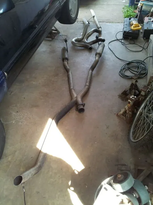

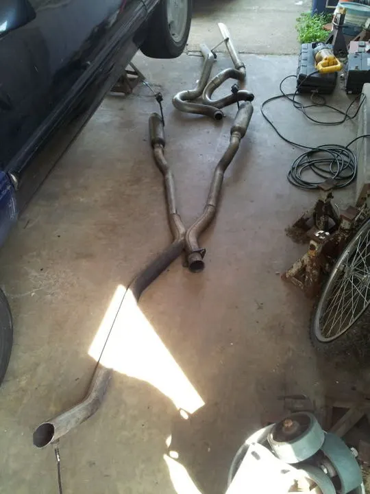

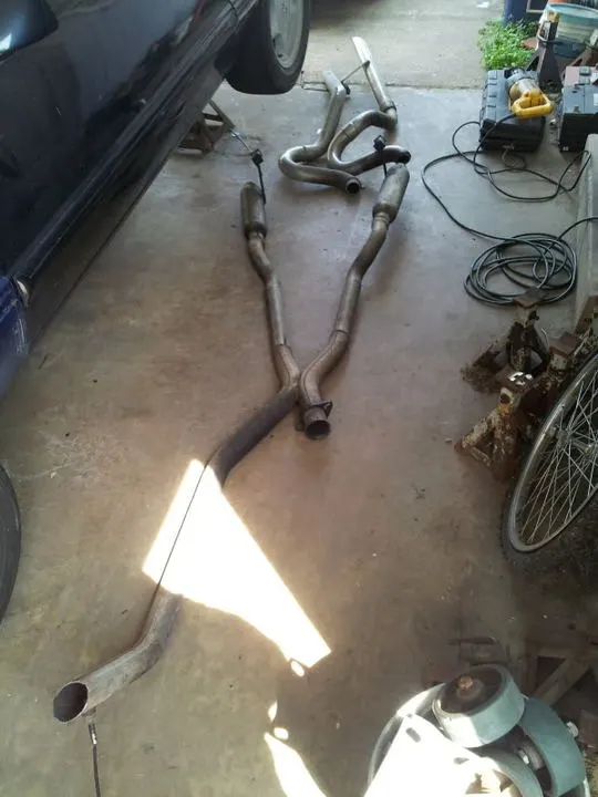

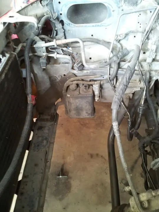

Cut off the Frankenstien exhaust system. Now its totally ready to go to the shop to have the subframe connectors and torque box reinforcements welded in.

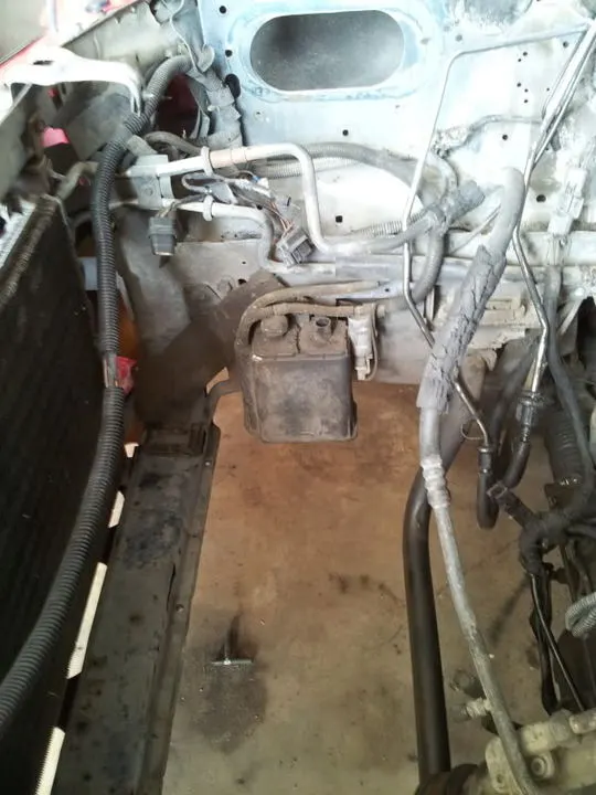

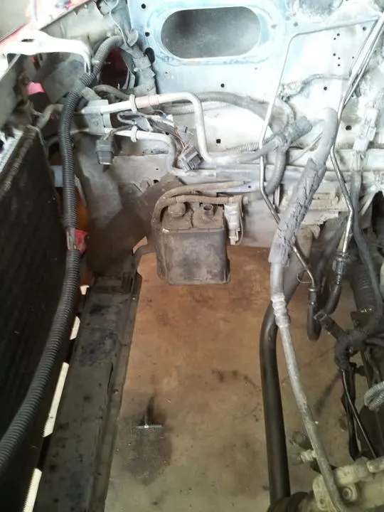

Question: Do I need this canister if I'm running off-road exhaust? I THINK this is a part of the smog system.
That's the charcoal canister that's part of the evaporative emissions system (fuel vapor). You could probably delete that with no ill effect besides the possibility of fuel fumes from time to time (the fuel tank would have to vent somewhere).

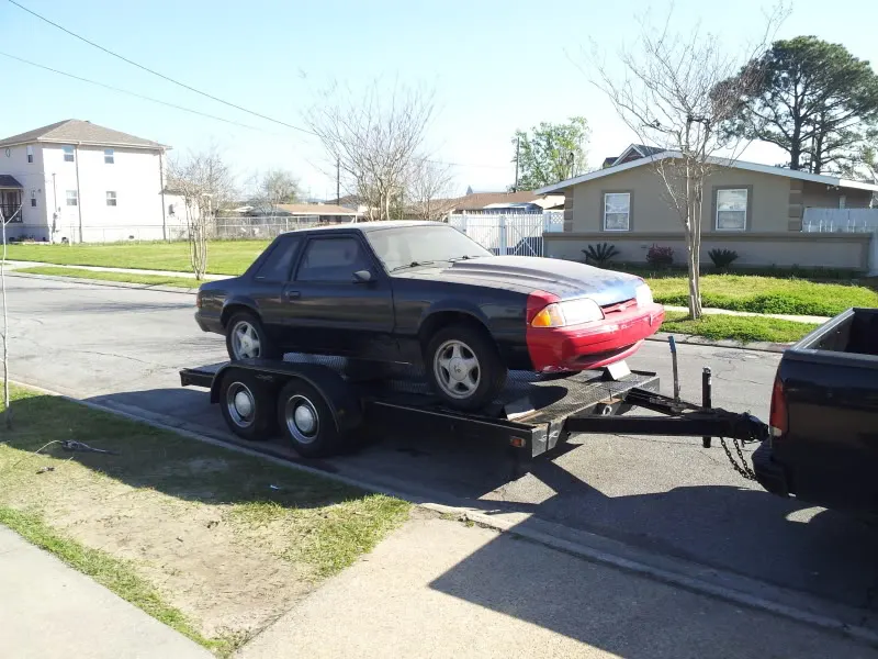

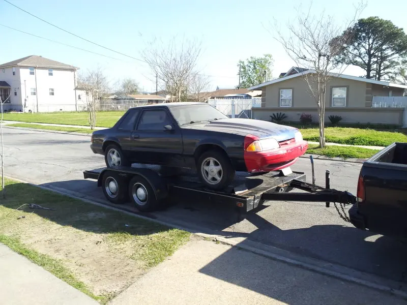

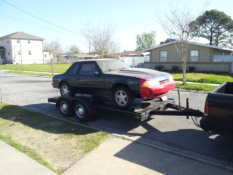

Well here she is in all her dusty glory on the way to have the subframe connectors and torque box reinforcements installed.
I also brought all the parts for the shortblock to the machinist/engine builder today. The ball is officially rolling now. Pushing to have her back on the road no later than May.
