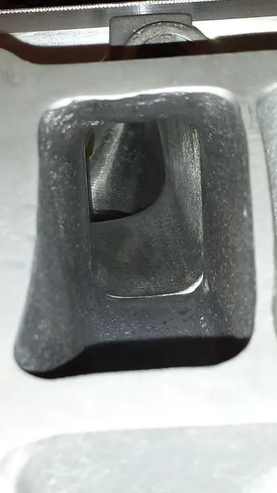

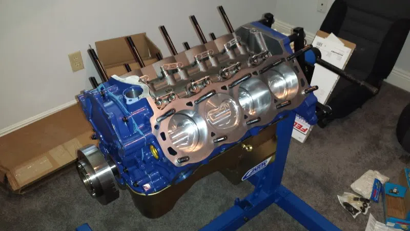

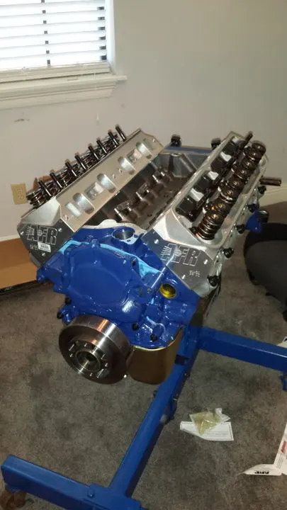

I did a little bit this morning. Nothing is torqued down because I didn't have a torque wrench on-hand. I still have to drill out a couple of rivets on the MLS head gaskets so I didn't want to torque them down anyway.

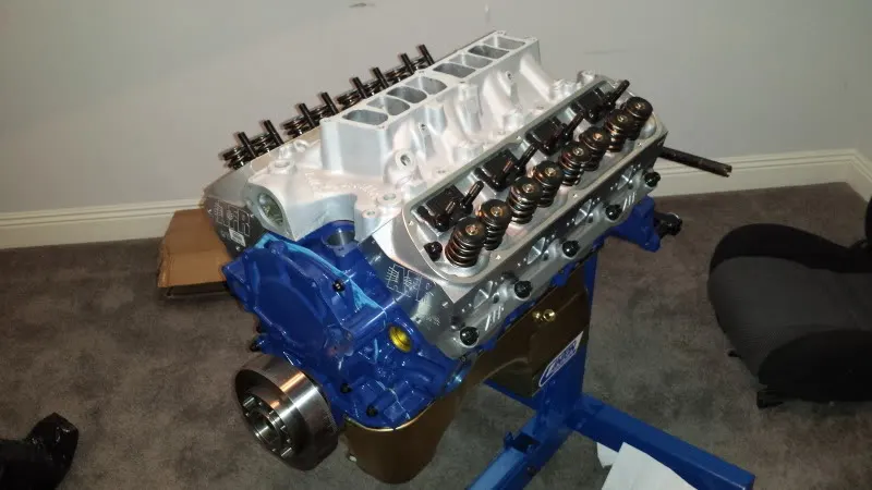

Just set the intake up there for kicks. I don't have the intake gaskets yet.
I thought I might need to get the intake port matched to the heads....I guess I was wrong. :banana: Remember this is with no intake gaskets so these ports might actually mate up close to perfectly. :cool:

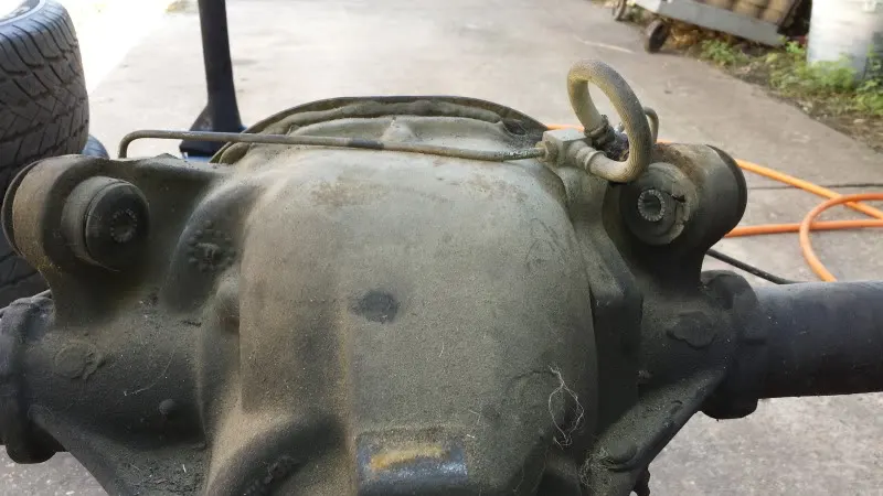

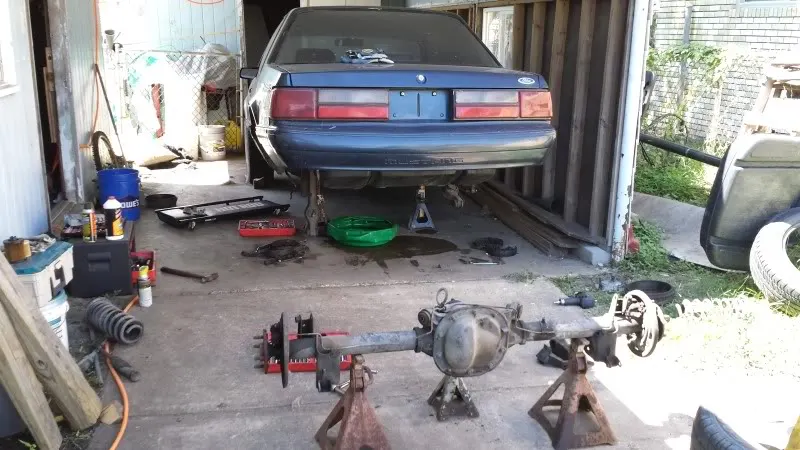

Well, its been a LOOOOONG time since I've been able to turn some wrenches on my car. The summer came and went and I haven't had a chance to touch it.....until today. I finally pulled the rearend out. I'm taking it to work tomorrow to hopefully take it apart and at least START cleaning it so I can bring it to the shop next week for it to get assembled with all the new stuff.
Here's what I did today.
I also took a pic of how bad the UCA bushings look. It's an indication of how ALL the bushings on the car look.
Ok so what's the trick to getting those bushings out? I think I read somewhere(probably here) that you have to drill through the rubber then beat the rest out. Is that the best/easiest way to do it?

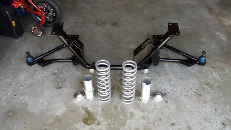

Craigslist Score!!!
Yesterday I picked up a NEW UPR K-member with A-arms, coilover kit, and rear upper and lower control arms(non-adjustable). All for a grand total of $600. I couldn't pass it up. I sold my dad the LCAs and UCAs for $200 because I will be getting the adjustable ones. So getting the car started will be delayed a little because I used the money to buy all the knick knacks like sensors, coil, and other minor hardware. This purchase actually saved me from having to pull the motor out again to change the k-member later.
