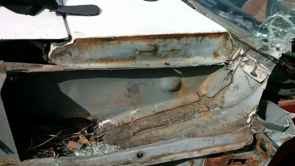

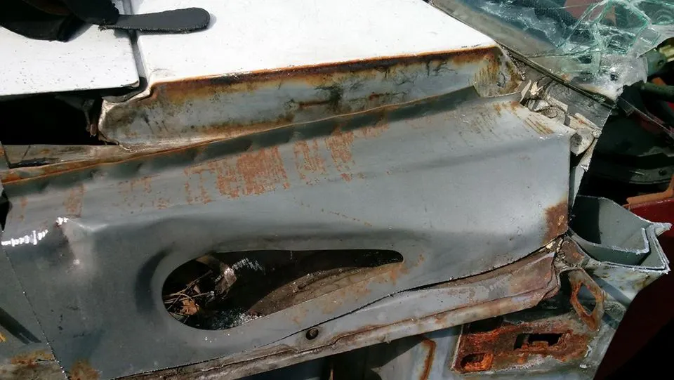

I wonder if this cowl rust is a problem inherent to the fox platform?
Yes it is. I had a coupe that looked and had the same rust damage. I have personally seen several just like that or worse. And these are cars in Hawaii where we don't have road salt. I have heard itbis the lack of paint coverage in the cowl area and the poor drainage that leads to the rust starting there.

It appeared to me that the seam sealer in there had dried up and cracked over the years and under the seam sealer is bare metal. One of the problems is it is hidden. You don't see it unless you pull your fenders. Because of that it just gets worse and worse without you knowing.
Door pillars and cowl is the first thing I check when buying a fox. If there is rust in there I walk away.
sadly it is. The design of the cowl area tends to lead to this kind of rust. Ford did a crappy job of sealing up the area. Couple that with cars in the South- especially by the ocean rust from the top down due to the salt in the air vs up north due to the salt in the road.

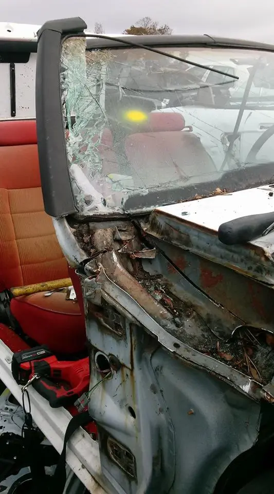

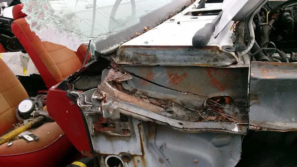

I had two options- part it out or fix it and seeing its my baby,,,, i'm going to try and save it.. Luckily my buddy has tackled this type of job many times and is taking the time to do the job right. I should have more pics this weekend when I go see the car
Pretty scary :poo:.. If I didnt fix this with the power this car makes, I shudder at what may have happened to me at some point in the future.

did you end up repairing or scrapping it? If you saw pics of my car, you would have never imagined this carnage underneath. The car is mint otherwise
It's a common failure point due to drains easily being blocked. Also another area that you don't know how bad it is until it's really bad is behind where the door hinges bolt to the body. I'd have your body guy check that area good while he has it and is doing the work.
At least you have someone working it who knows what they're doing. Better to find and fix it now than when the car has trouble staying together.
