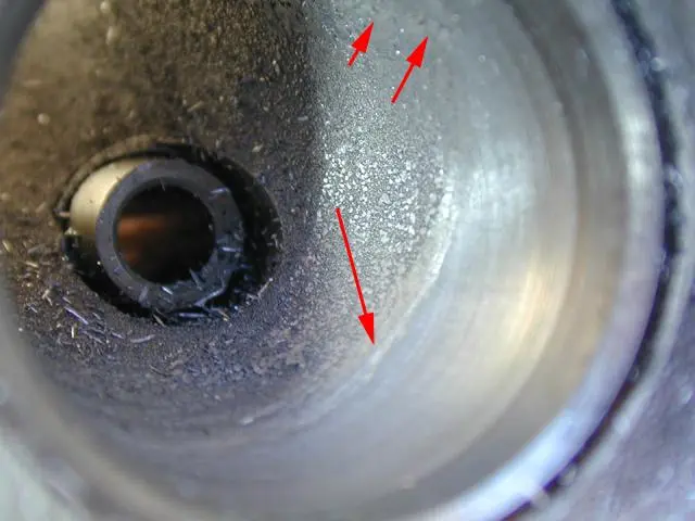

25th: I still dont know how you guys do this with stock cams!! I know your degreeing the thing, but are you advancing it or retarding it? I know that if you advance it to 2-4* it will pick up some, but I guess I dont get it? I dont get how you can make so much power with a stock cam.... more like RUN so well with a stock cam...
geez, ill have to try that one day..... lol
It was retarded 4 degrees on my dads race car, and now 2 on the street car. The 40Ps always seemed to run strong, and we have a half dozen friends with GT40P cars running 12.3s and faster. All with stock cams, and very very similar mods. Ours at the end of the last year with the race car seemed to be a bit faster (always went 112 mph, and 12.0xs in the heat, where everyone else went 12.2-12.4s). Never snagged the 11.xx but got screwed on the last race of the season where it went solid 7.48-7.49s with me driving it which were 11 second runs, but the track was shortened to 1/8th mile due to huge winds.
