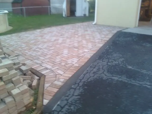

better then parking on dirt. and we have more brick then what we know what to do with

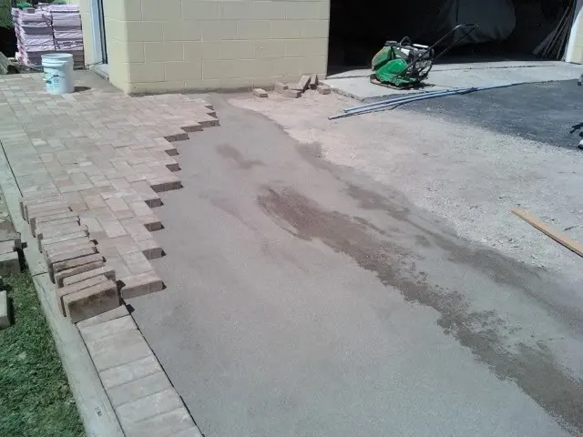

my dad broke his foot. ( not driving the mustang for him anymore ) and is in cincy for the weekend and has wanted to do this for weeks but with his foot he cant. so he left at 5 am today and i started at 6 am.
2 tons of compact able gravel. spread it out then compacted it. went to sunbelt told them i was from the civic association..got a weird look and he gave me the 50% off price 20 is better then 40 then 1 ton of sand. 1 inch thick.
anyway. pic. im not done. but im done for today. im tired. i got alot of cutting of bricks to do tomm when he gets back monday he better be happy or imma be pissed atleast a thank you or something. and the gutter sitting there is only temp. were going to get rain and i dont want the water washing over it. tomm after the cuts i need to put sand on top and vi berate it all in to lock it all together. fun fun.
and yes. it slopes. away fromt he garage in both directions..(dont want water to sit.)
see what i mean by more brick then what we know what to do with!

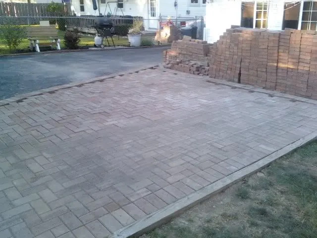

all done. he comes home in 12 hours. so we will see what he thinks.
