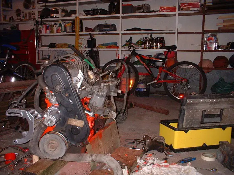

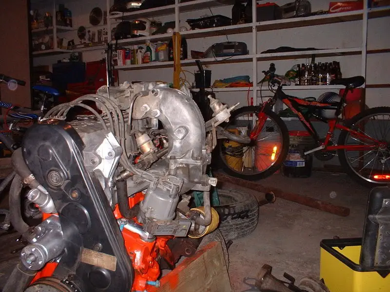

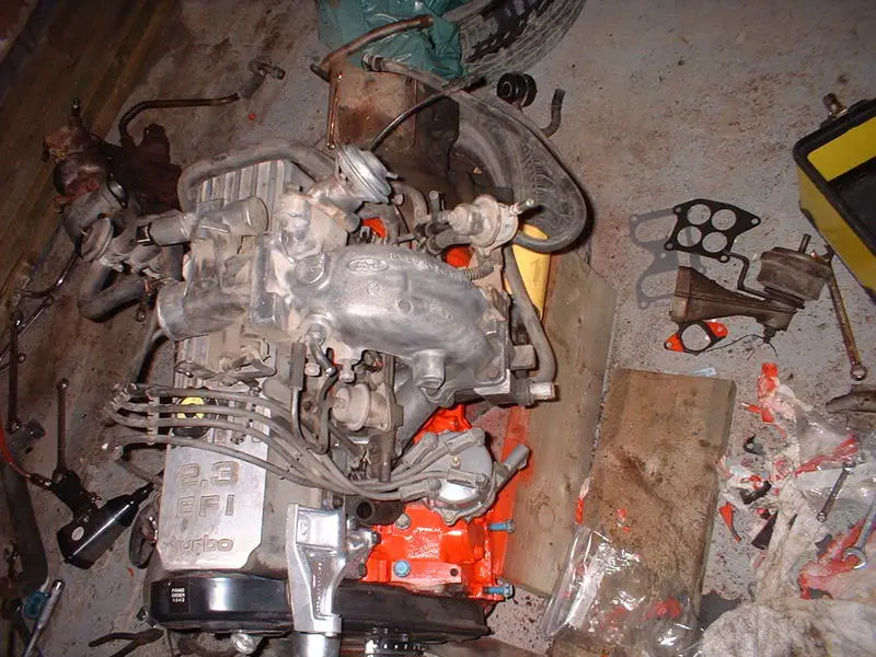

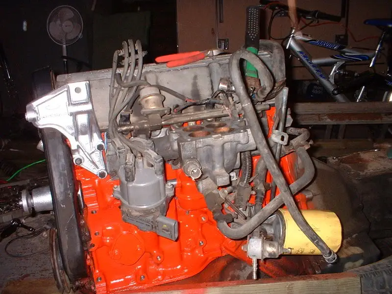

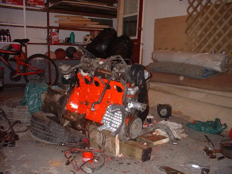

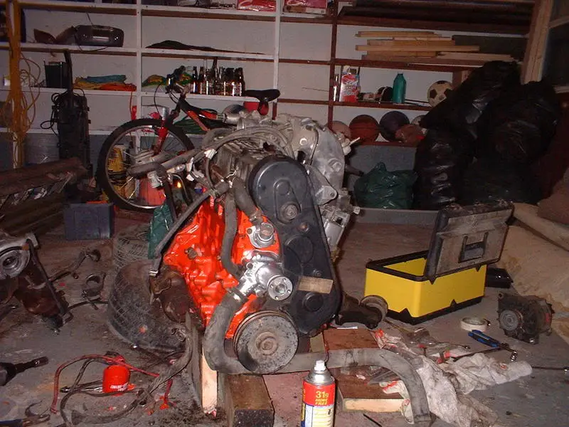

This is as far as the engine is now, just have to remove the turbo from the manifold, drill holes at the end of the crack and cut a V grove in it, get it welded put it on and its ready for the swap
what kind of paint did you use to get that chrome like look
