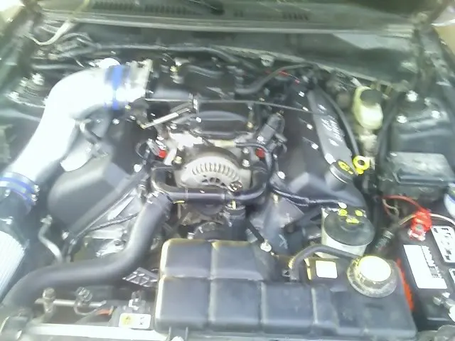

Crappy cell phone pic tommorro ill get my digital camera out if i got time or monday ill clean the car up and get some better pics
After a long feaking time waiting i got my motor done. I got my 2V swapped for a beast 4V
Bottom end Iron block bored over (i dont know how much :shrug: ) kellogg crank good to like 2000hp, Manley rods,probe pistons,ARP everything, Cobra C heads ported polished with bronze guides, turbo cams, 2004 mach 1 intake manifold painted crinkle black port matched to heads, QA1 Tubular K member, coil overs, narrowed my axles .5inch on each side. 8.5.9 comp. MMR 10qt oil pan with billit oil pump.
I cant remember the exact details of the internals i know im missing some on my list but there in the beast. The motor was built to hold over 1000hp.
Next month im taking it back for my turbo kit a single Precison 76MM. And all my suspension work for the rear and of course bullet proof the rear end. Whats kool about this guys kit is you wont see the turbo or any piping except the big feed pipe going into the manifold, it will look like a cold air intake. :D

If you don't mind me asking, what did that set up cost you? Did you just buy a stock 4v long block and have new pistons/rods/crank installed?
No I got a bare block and everything seperate and had a Place called Sunset Race Craft do the machine work to it. And my mechaic did the rest, he found everything new on it except the intake we got it off some wrecked mach 1. i could have got it cheaper but i went with the good stuff. The motor was around 11500 the part that kicked my butt was all the little stuff i couldnt believe how little crap you need to convert a 2v.
Well im going to have 3 tunes on flip chip. Full race gas around 24psi, 50/50 tune, 10 lbs pump gas tune. I wont have 1000hp numbers because its going to have a C4 tranny but the car will be faster that way. But if it did have a T56 or something im pretty sure i would be over 1000hp.
I hope I dont get any tickets :( maybe for my window tint :D i aint driving it fast anyway just breaking it in. It sounds freaking mean i cant wait to get on it WOT.
