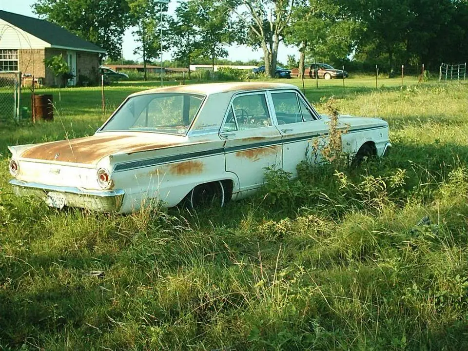

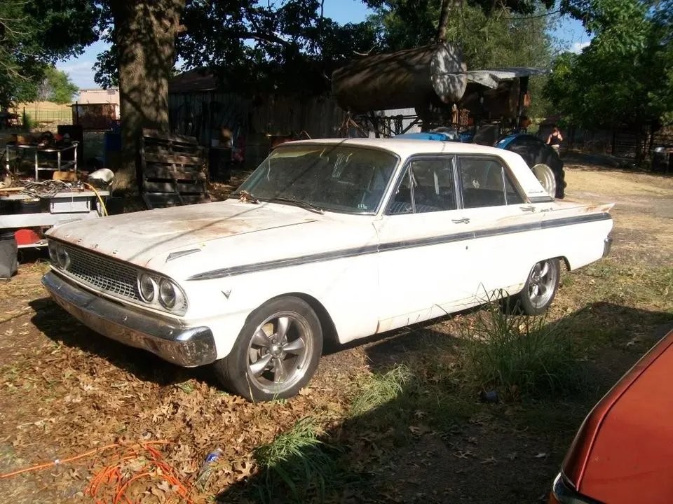

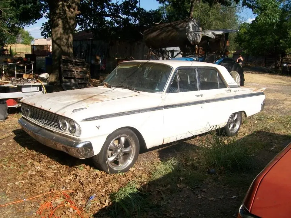

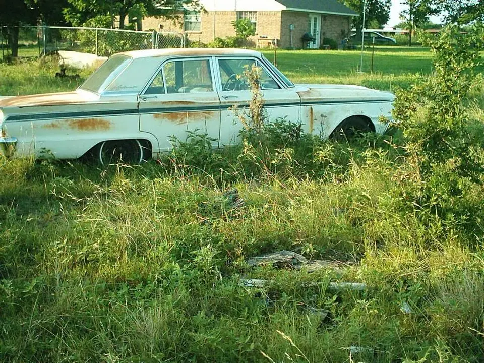

Anyone like Fairlanes?:D I'm bringing my 63 Fairlane 500 with a 221 V8 on Saturday. I've had it for about 2 years now, but I'm now getting really excited about it. It doesn't really need that much to run.
I'm going to take the heads off, and make sure everything is fairly clean and nothing is wrong with, and to clean the rats nest out of it. I've got a spare performer intake and carb I can put on it. Then I figure I can replace the fuel lines, clean/replace the tank, do the typical tune up stuff and it should run. Do a brake job and suspension check/replacement and it should be driveable. My ultimate goal is for it to look pretty much original except for torq thrust wheels, and of course the intake and carb, and a disc brake swap.

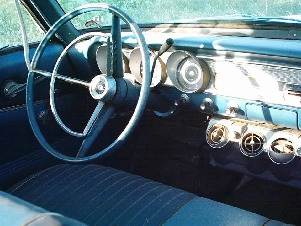

I can't believe how nice the chrome is on it. Especially the window trim, its nicer than the stuff on my 68 Coupe.
Its only got 46k original miles on it. My Great Grandmother bought it in 1968 (I have the title transfer paperwork and title), she was the 2nd owner, I'm the 3rd.

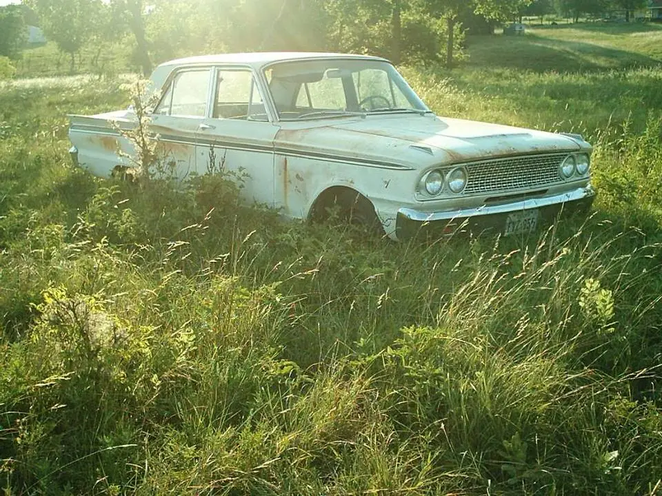

Hmmmmm....... that could be a lot of fun!

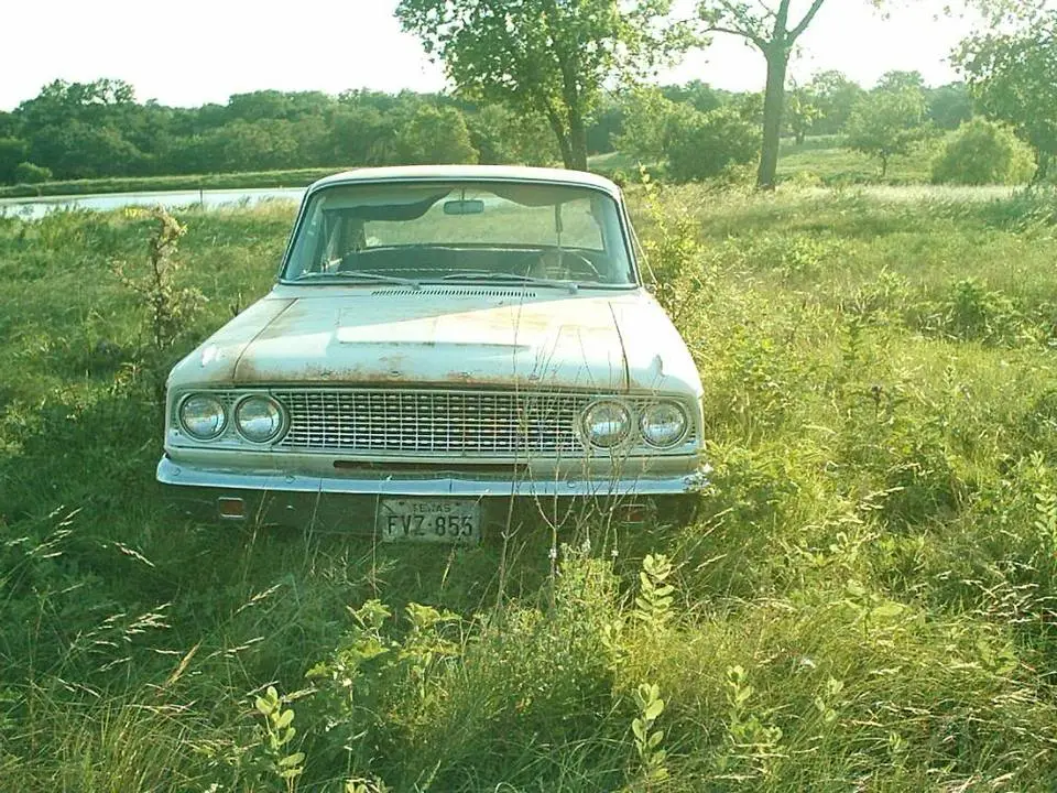

First of all, you are on lucky Dawg! Not only is the chrome trim in good shape; bt that grille looks prisitine for its age :nice:

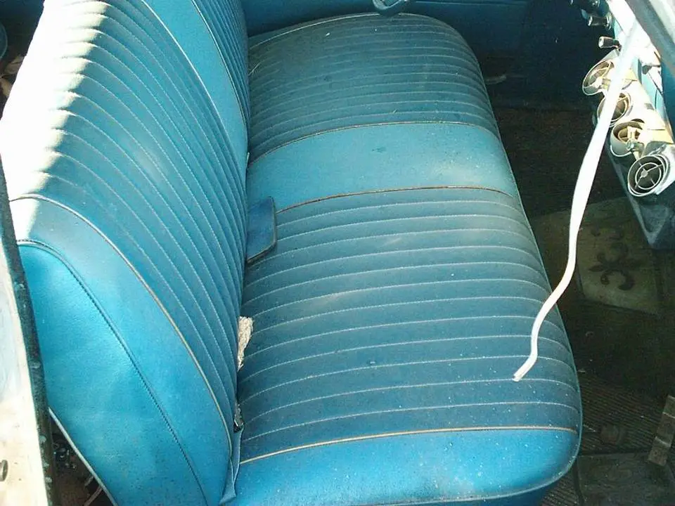

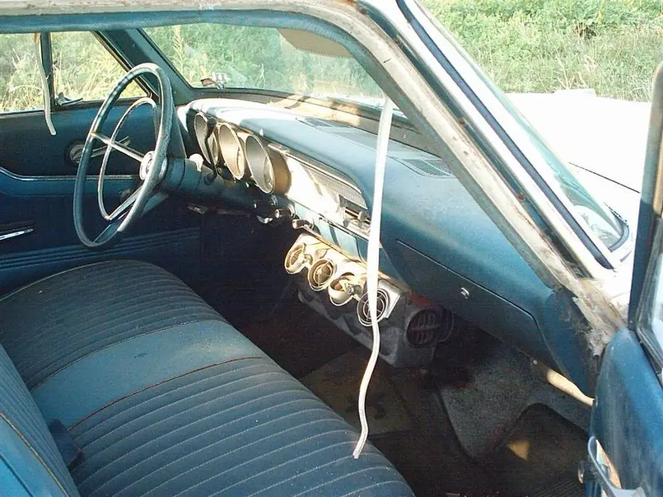

Is that a factory or dealer A/C unit? I asked because it only needs different louvers and a "Sears" emblem on the front to be identical to the one that was in my Dad's '70 F100.
Four doors, automatic, nice bench seats, and a generator; long-term, are you going "original" or modding it out? Lotsa room under a Fairlane hood for an EFI'd roller 5.0/GT40 heads..... back it up with a built AOD (find a place to hide the "AOD OFF" button and keep the original gear indicator) and a 9" LSD, stuff a relatively quiet dual exhaust (Maggie's) underneath, maybe lower it a little, but keep the body original with factory paint - something different for cruise-ins and weekend car shows. Take it out and run it; then show everybody what's under the hood :D

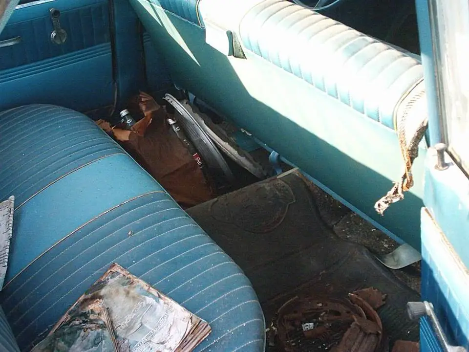

OBTW: Love the 70's-era magazine laying on the back seat - and the matching glass Coke bottles on the floor! :p

I don't know what you are wanting to do with the interior (which really the original doesn't look too bad) but a white exterior and a red interior would look killer! After you get her running, first thing I would do next is ditch that single master cylinder and go with a dual. Not only would it be better brakes but safer if you lost a brake line.
