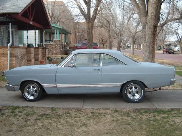

I rescued a 67 fairlane a few years back. It was a 289 auto. I really liked driving it.

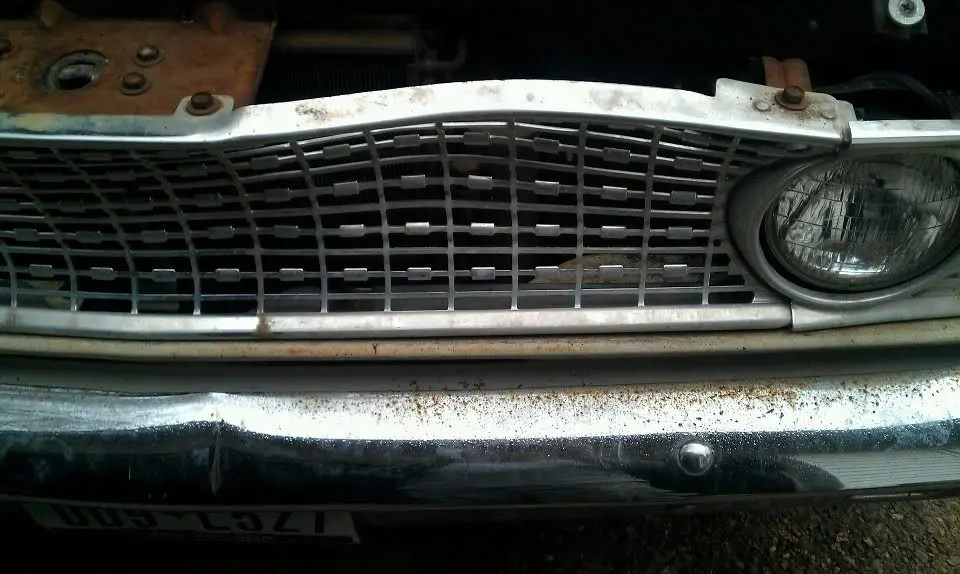

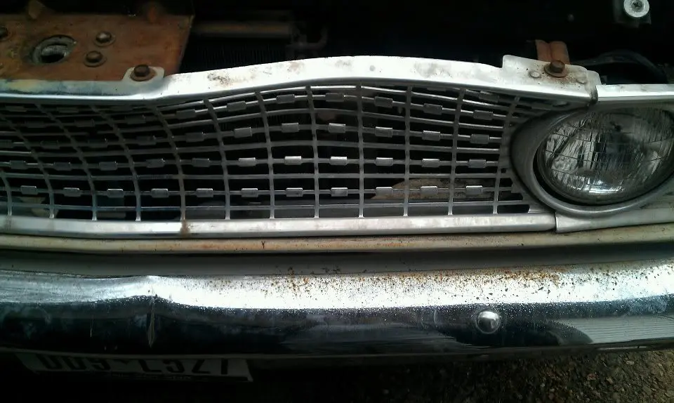

Last weekend I hit a big ass owl. He screwed up the drivers side of my pristine original grille pretty bad. I spent about 3 hours on it and got it looking pretty damned good, but not quite like it was. This is before I fixed it, I don't have any after fix pics yet.

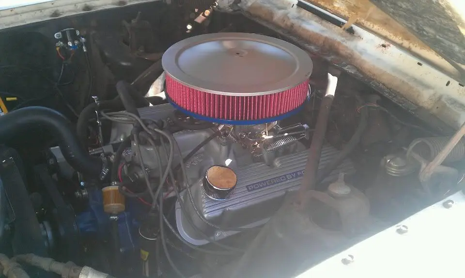

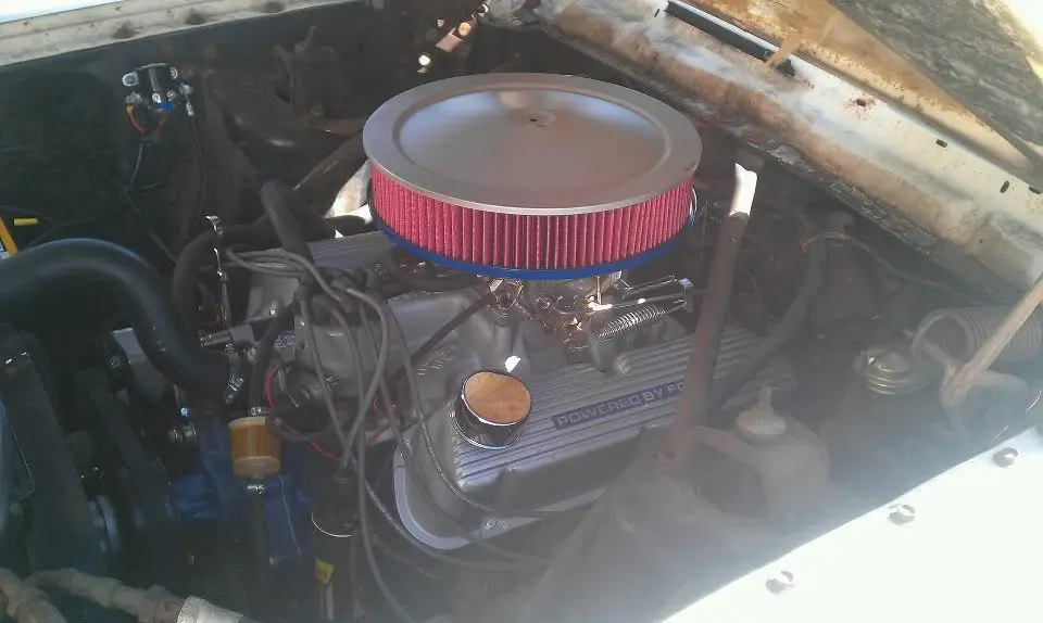

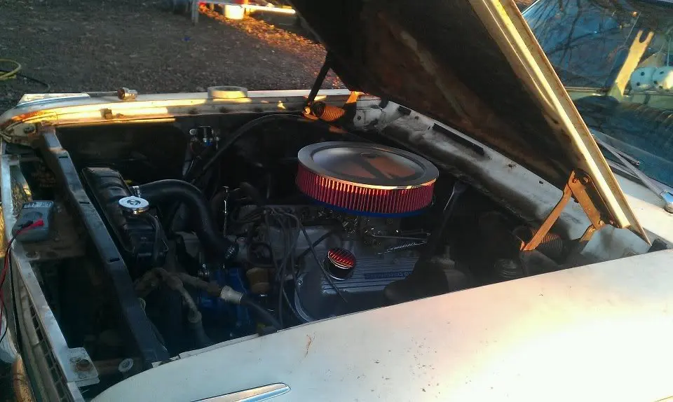

I also fixed up the mid 80's "Powered by Ford" valve covers I had laying around and put them on, and repainted the air cleaner base and lid, with a new filter. The gold was old!

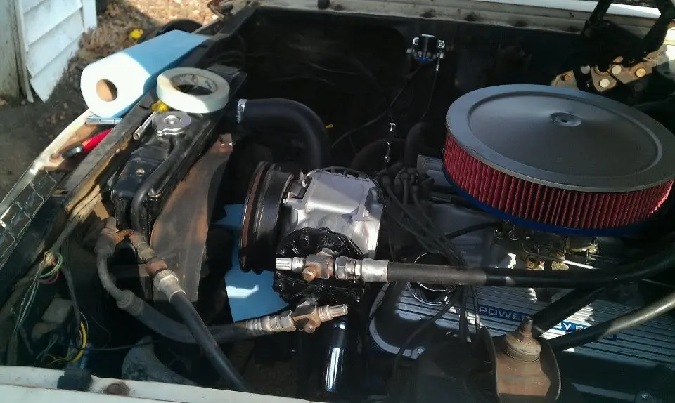

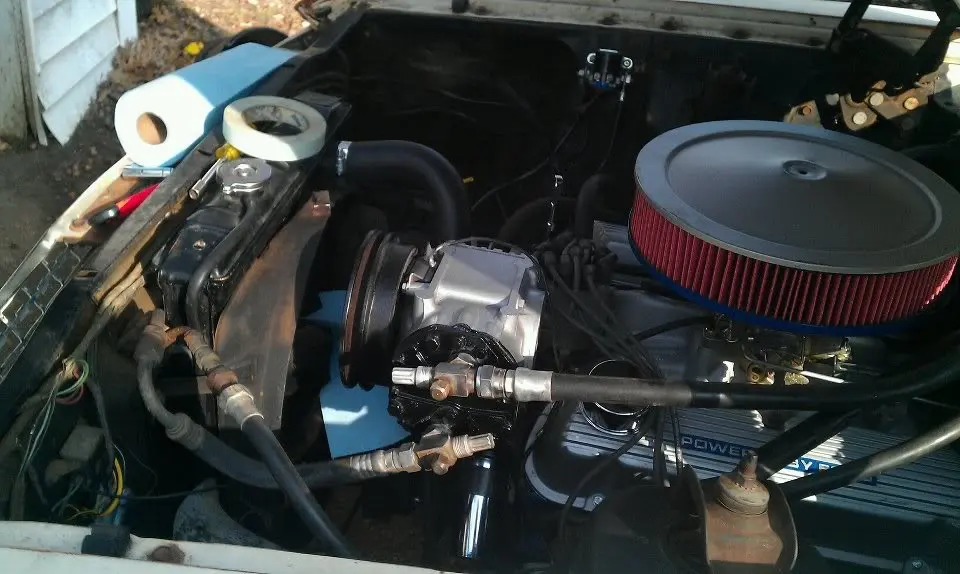

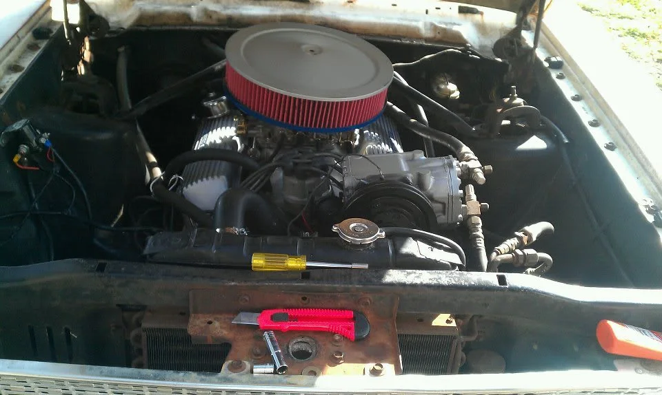

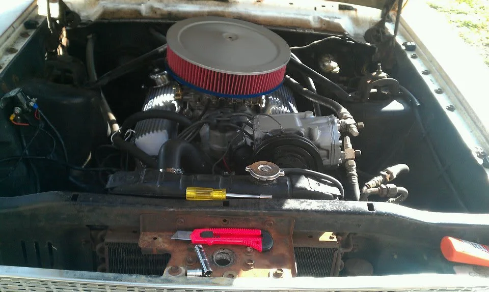

My newest project for this car is getting the a/c going again. I'm driving this thing to Tulsa this June for the Mid America Ford and Shelby meet, and I want my a/c working.

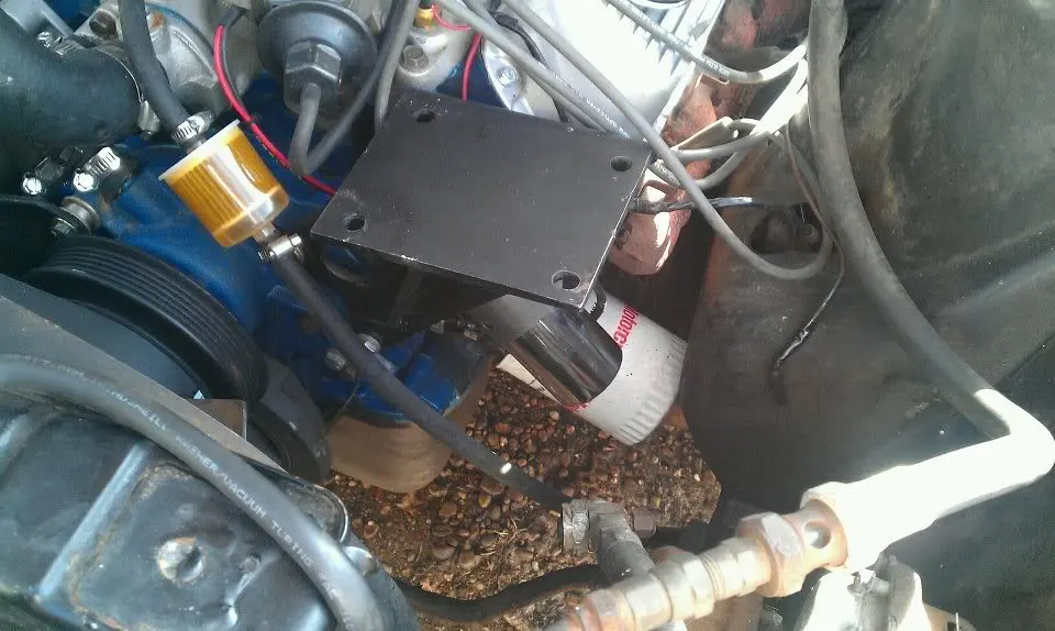

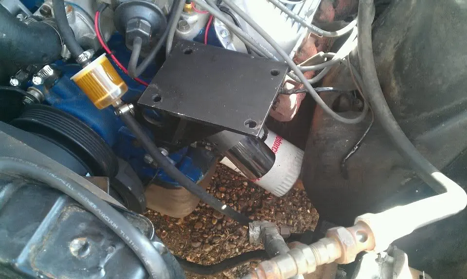

I cleaned up and repainted and mounted the stock a/c compressor bracket, which is the only a/c component I removed from the car. I also had to move the coil. I can't put it in the stock location with this intake, so I moved it down under the a/c bracket.
The compressor went right on, just like before, except the braces that originally came off the back of it and bolted the intake won't fit with this intake. It should be fine though, this bracket is stout as hell as it is.
Since these pics, I have also cleaned up the a/c hoses and fittings.
I plugged the wire in to the a/c coil, and my when I turn on the a/c blower motor (which still works :)), the clutch still engages! My main problem now is to see if I can find a clutch with a 6 rib serpentine pulley, and to see if it will line up with my existing pulleys.
If it comes down to it, I might have to ditch the water pump and all the brackets I have on it now and switch to a complete fox body front dress (parts I already have), but I really don't want to do that.

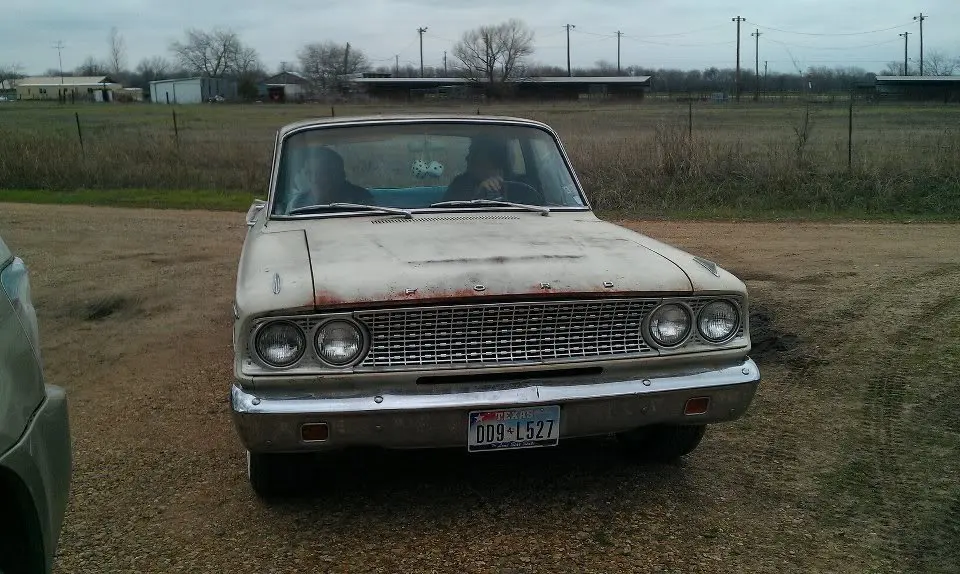

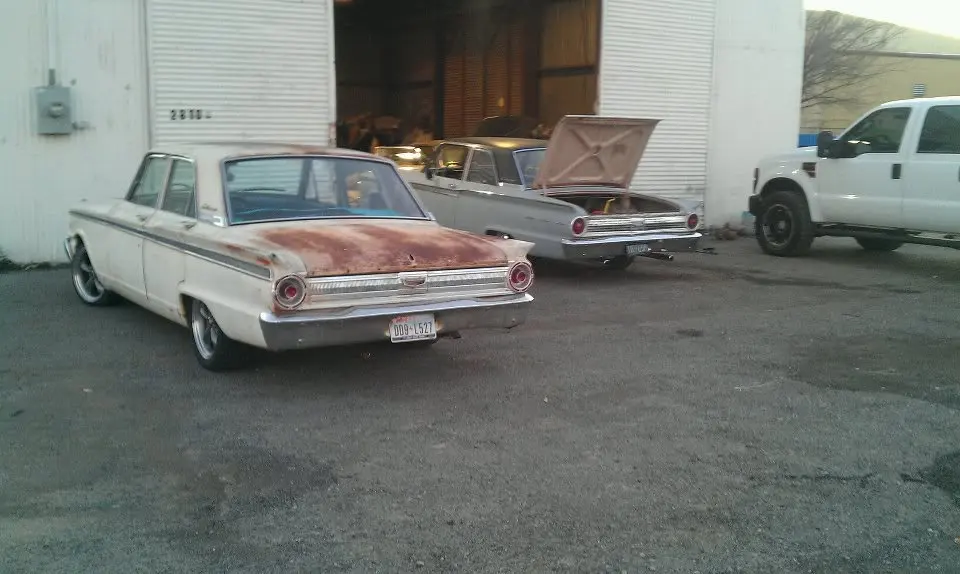

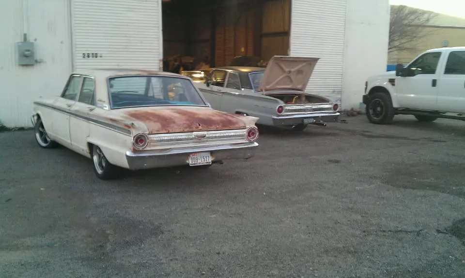

Oh I almost forgot. She met a buddy today. I went to an upholstery shop to have him give me a quote on some work and they had a 62 Fairlane 2 door Sport Coupe up there that they were putting a full interior in.

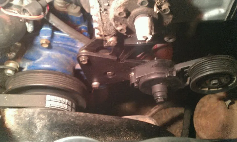

Worked some more on the a/c stuff yesterday. I still needed a way to tension the belt, so I found this bracket I had laying around, modified it a little bit, and put a spare foxbody Mustang tensionor on it. Not ideal, but it will work.
It seems to line up good. I also found a 6 rib clutch for this York compressor that will line up correctly according to my measurements. Boy, my engine looks dirty in this pic.
