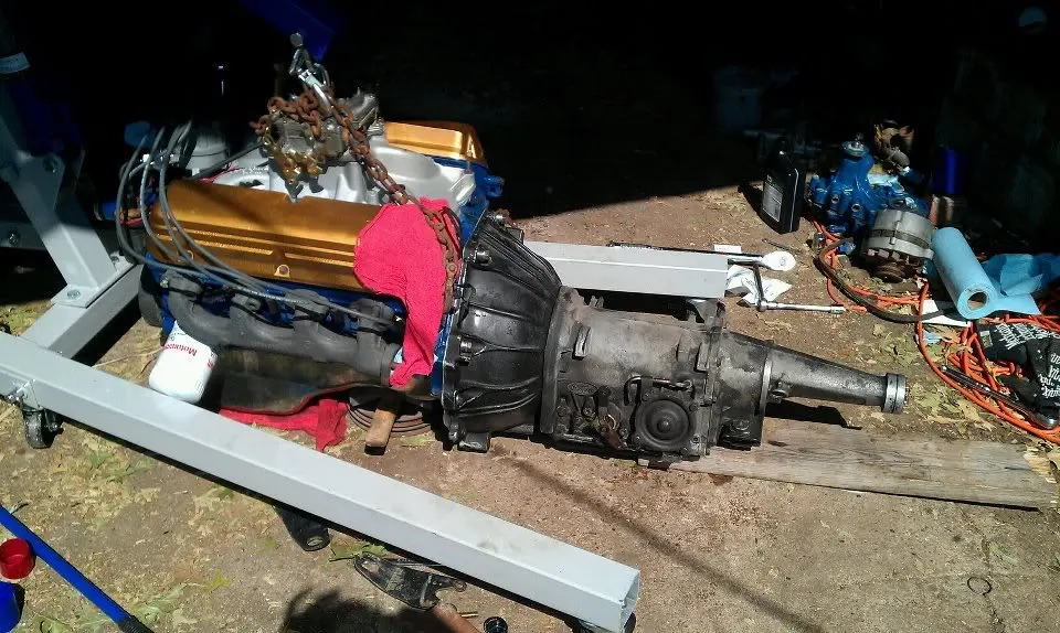

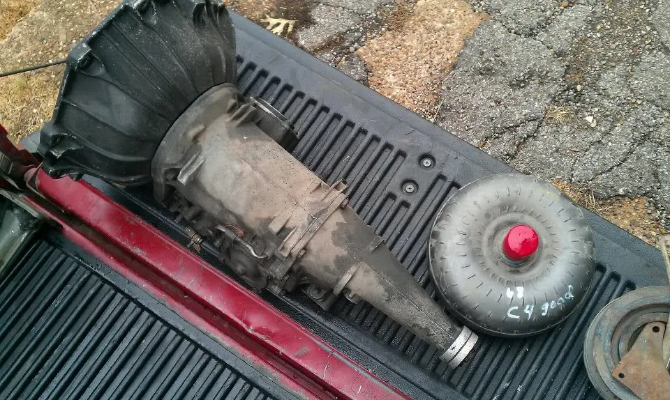

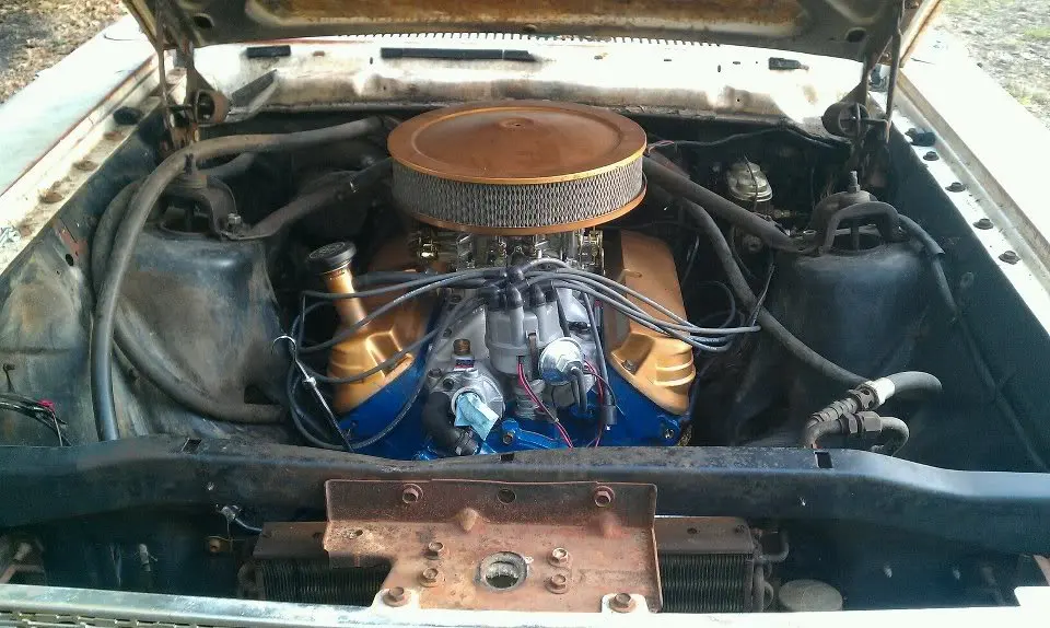

Well, I got the new motor and tranny in. I picked up a C4 and a torque converter Monday.
I still have some engine bay cleaning to do, and I still need to figure out what I'm going to do about pulleys, because the 221's crank pulley is a 3 bolt. I need a matching set of v belt pulleys with a 4 bolt crank pulley. I have fox Mustang stuff I could use but I wanted to avoid that because I want V belts on this one and I don't want to change the water pump. I'm also going to change the valve covers to the mid 80's finned "Powered by Ford" covers that I have sitting around, after I paint them aluminum. I'm also going to repaint the air cleaner, probably blue, and order a 221 sticker to put on it.

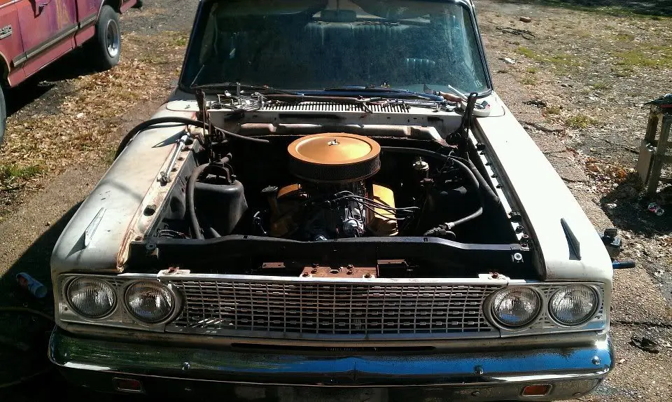

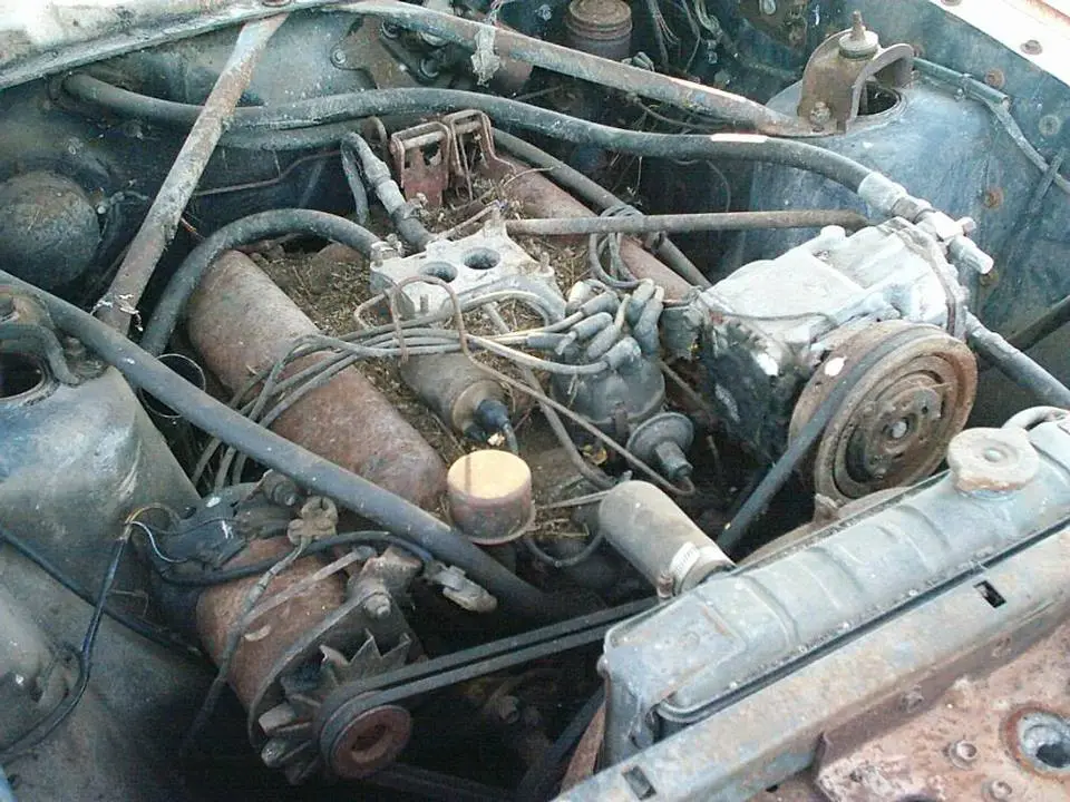

Oh, here's a before pic.
I'm about to go see if I can mess with the wiring some, make sure it's okay, and fix whatever I need to.

Well, I made some good progress today.

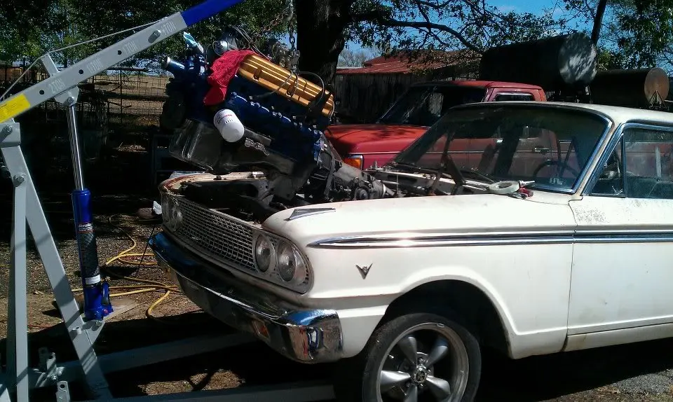

I had to lift the engine back up to replace the top two trans to engine bolts I was using. The ones I used the first time were too long so I put a spacer on them, but last night I realized that the bolts were hitting the firewall which was causing problems getting the trans, trans mount and crossmember aligned and bolted up for good. I got all that stuff fixed and finalized.
I also got the exhaust manifolds installed. I started trying to fab up some new throttle linkage but ran into a snag. I'm not sure what I'm going to do about that.
I'll probably post up some pics of my before and current throttle linkage situations tomorrow and see if you guys have any ideas.
I dropped off the tank and radiator this morning, then spent over half the day and 100+ miles on my truck to find a stupid water pump pulley I could use.
I also made my own arm to attach to the original throttle bellcrank (I didn't want to modify the stock one because I want to go back to original one day) and also made a linkage rod from it to the carb. Works great, looks pretty good, and it doesn't bind or anything, it feels like it should.
While I had my confidence up, I also ended up successfully making my own pivot for the shift linkage since the 91 block doesn't have a place for one. It allowed me to use my original pivot bar for the shift linkage with the new engine.
