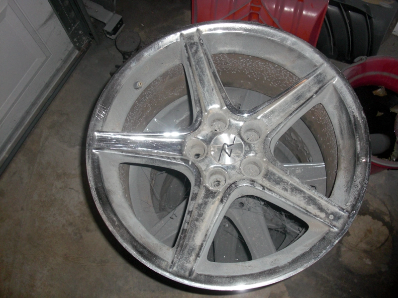

Here's what they started out as... that's rust with scratched and peeling chrome.

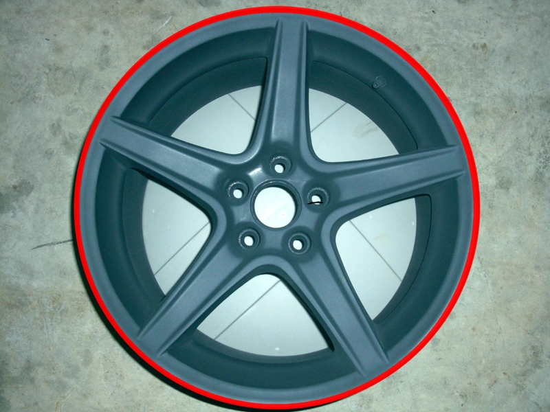

Here's what I wanted to do...

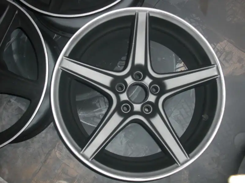

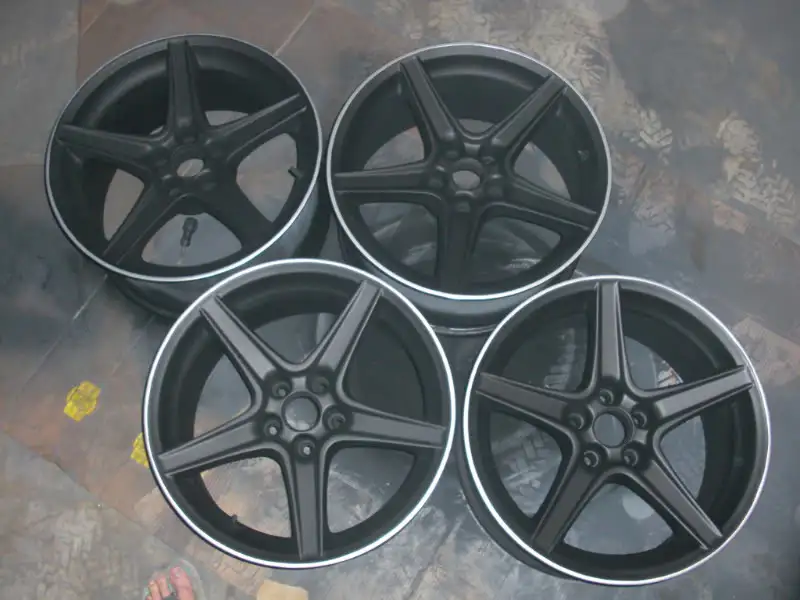

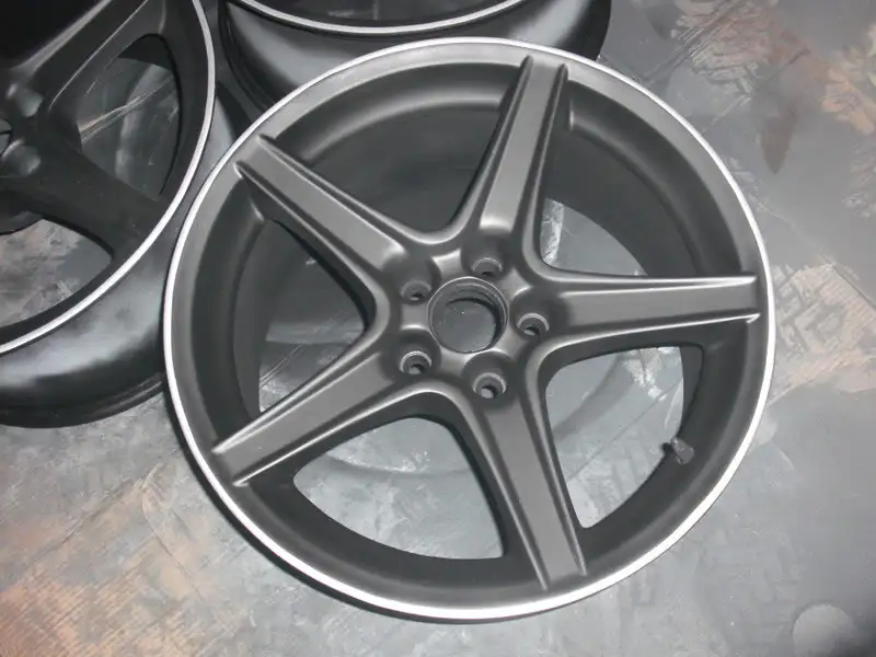

Here's what I ended up doing. They are going on my silver vert. I had to strip the chrome, sand, primer, sand, primer, sand, paint 3 coats, sand, paint 2 coats, pinstripe.
I used a flat black industrial paint used for high temp and abrasion resistance. The pin stripe is just car pinstripe that you can buy at Advance Auto. It gives me the option to change colors later, but it sticks incredibly well. I think they turned out really well. I already dropped one and it didn't damage the paint at all.
