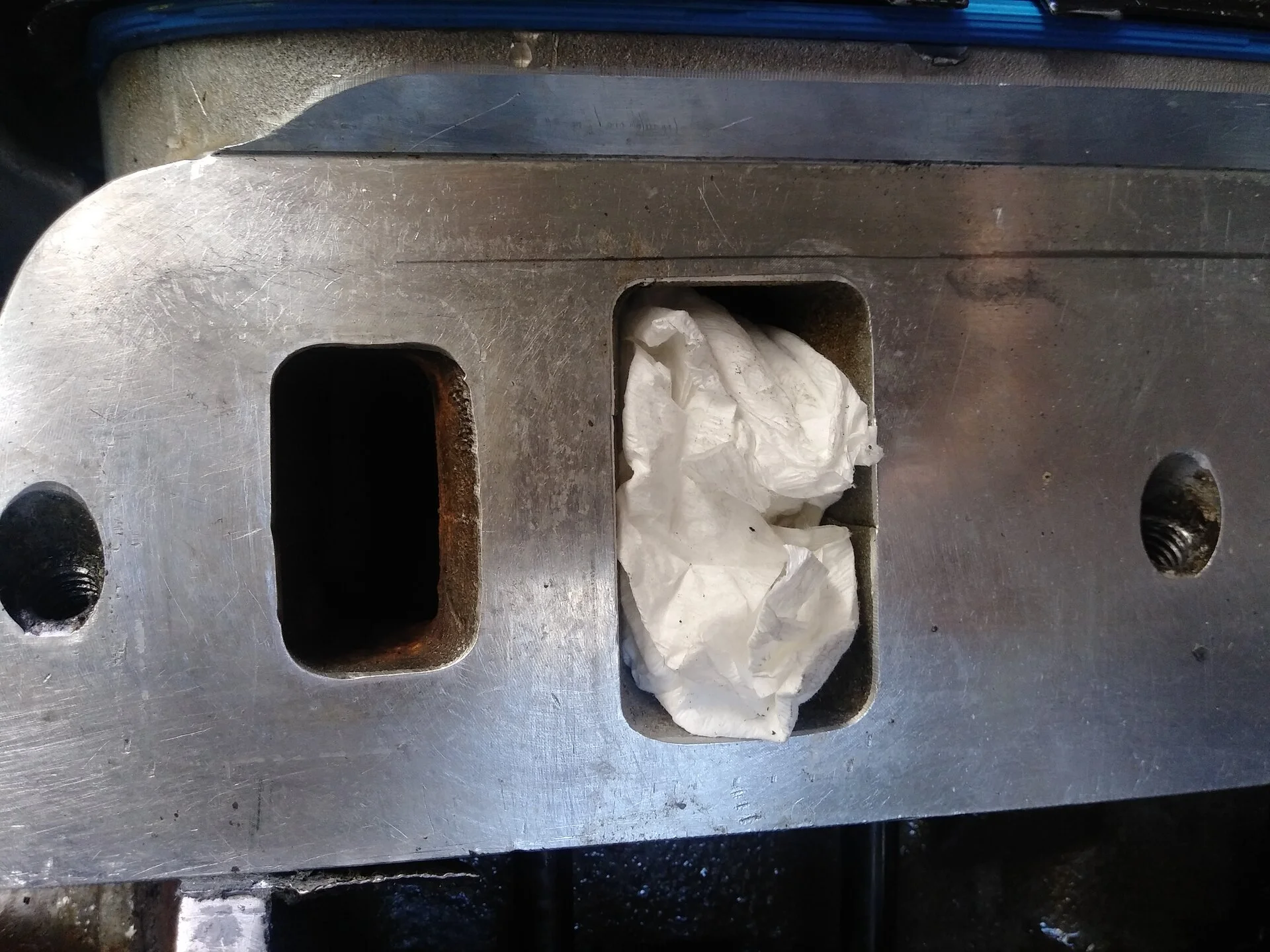

Please take a moment to look at the pics.
In the first pic I have drawn a pencil line where the top of the intake sits.

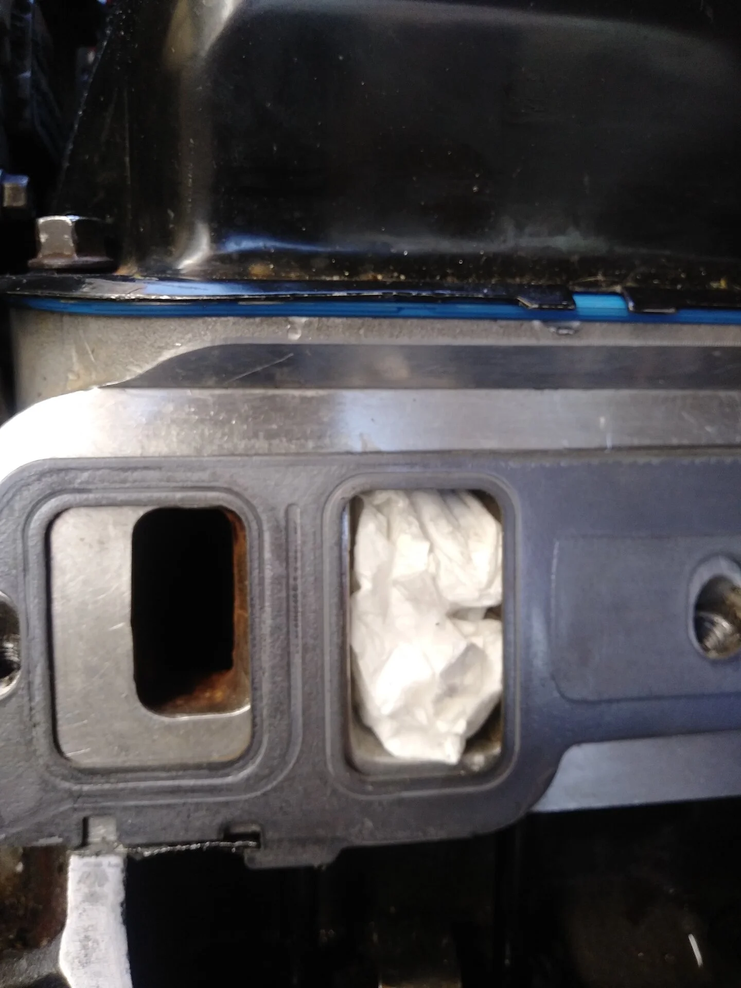

Then the second one shows the lower intake gasket in place with the head gasket tab set into the notch on the bottom of intake gasket. As you probably notice, that does not leave much gasket extending above the intake port for sealing. I have tried an install with the gasket adhered higher up but with the same result, which is low vacuum, engine shaking and running lean. Im running a tfs stage one cam. Also notice the disparity between the cooling port and the gasket.
Please anybody that has any insight would be greatly appreciated. I would live to enjoy my vert this summer but I cant keep throwing intake manifold gaskets at it and expect a different outcome. As stated the heads are pretty much brand new and the block has never been decked. Just laying the intake on the heads without gaskets im getting .007" clearance at the runners and the same for the china rails.
Looks like you need a felpro 1250s3. I got mine from O'Reillys but Autozone and Advance should be able to get them, too. The reason I use a local parts places is so if it doesn't line up you can return them. Follow the instructions on the paper in the pack and you won't have any issues. The only thing I do different is trimming the length of the cork valley gaskets and using a thin bead of Permatex Right Stuff on both sides. The Permatex has to cure before start up.
I'm not quite sure why you have so little space at the top off your gaskets. I did a google image search on "intake gasket ford 302 instructions" and found quite a bit of information. One thing I saw was putting some studs in to help hold everything in place until you get it bolted. Maybe that would help. Sorry I don't have more to offer. From a lot of the pictures there is not a lot of gasket on top on most applications. Good Luck
Ive tried two different gt 40 intakes with the same results. One of them I personally remove from a 97 Explorer so I know it wasn't milled. I have also tried the 1250 gasket not the steal configuration but the regular 12:50 which with the same results as I stated in my previous post I have .007 clearance at the top of the runners and at the China rails which seems to be pretty consistent with what it should be and that's with no gaskets and the intake not snug down. I'm getting ready to go over to a local automotive machine shop this morning and talked to the guys over there and see what they can offer. But you guys are the experts so I would still really appreciate any and all comments thanks so much guys. Oh yeah and by the way it is a 302 and I do use four studs on each head.
Let us know what the machine shop tells you.
I had the opposite problem when assembling my current engine (393w) .
The lower intake would not sit far enough down in the valley due to deck height ,
had the intake milled to correct the problem.
I thought I had a lower intake problem that caused me to remove the lower intake several times, the last gasket I used was a felpro 90361, this is a gasket that is actually used for 351 engine, the thing that I noticed most was the size of the water jacket that is on your head, it is smaller than my E7 and gt40p heads, I think this is of no concern but the gasket I listed may help with the fit for the intake port.
Get six studs. Four for the corners and two for the center. Then,gasgacinch or indian head the gaskets into place. If the intake gasket is being held back by the notch where it connects to the head gasket,cut it off. Then you can place the gasket exactly where you want it. I always run a THIN layer of rtv around the water ports.

Thanks for the info JR . The guy at the Machine Shop said to tape the gaskets on and then lady intake manifold down and measure the distance difference between the China rails and the bottom of the intake.
He actually laid me on a set of intake manifold gaskets made by Jegs the part number is 210200 and they actually look like they really fit my ports good almost perfect all except for the water ports. He said if everything looks good just line the ports up the best you can install it that way. The heads in question were purchased from eBay the vendor said that they are his castings it looks like hes sold a ton of them . I have tried fel pro 1250 and also the 1262 gaskets but these jegs gaskets fit the best. They are listed for pre 1980 302 and 351.
