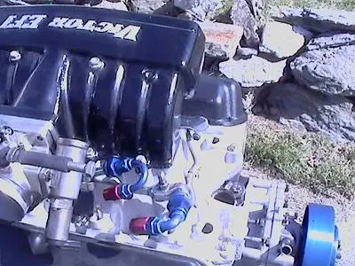

This is the bundle of parts that I used to fab up stainless lines up until the stock fuel filter. When I got to the fuel filter, I cut the original metal lines and clamped the stainless lines onto the metal. This kit should be used only if you have alot of room under the throttle body, or if you get 90* fittings instead, you can run straight to the firewall instead of under the neck of the intake manifold.
EAR-812008ERL
EAR-818006ERL
RUS-640870
RUS-640880
SUM-230615
SUM-230815
All the part numbers are from Summitracing.

Revived from the dead! Nearly a year ago 69Clark was trying to replace his OEM fuel lines going from the fuel rail to the hard lines in the back rear corner of the engine bay. 69Clark, did you ever complete this project? I'm looking to replace my OEM cheap lines, and I'd love to hear what you ended up doing.
