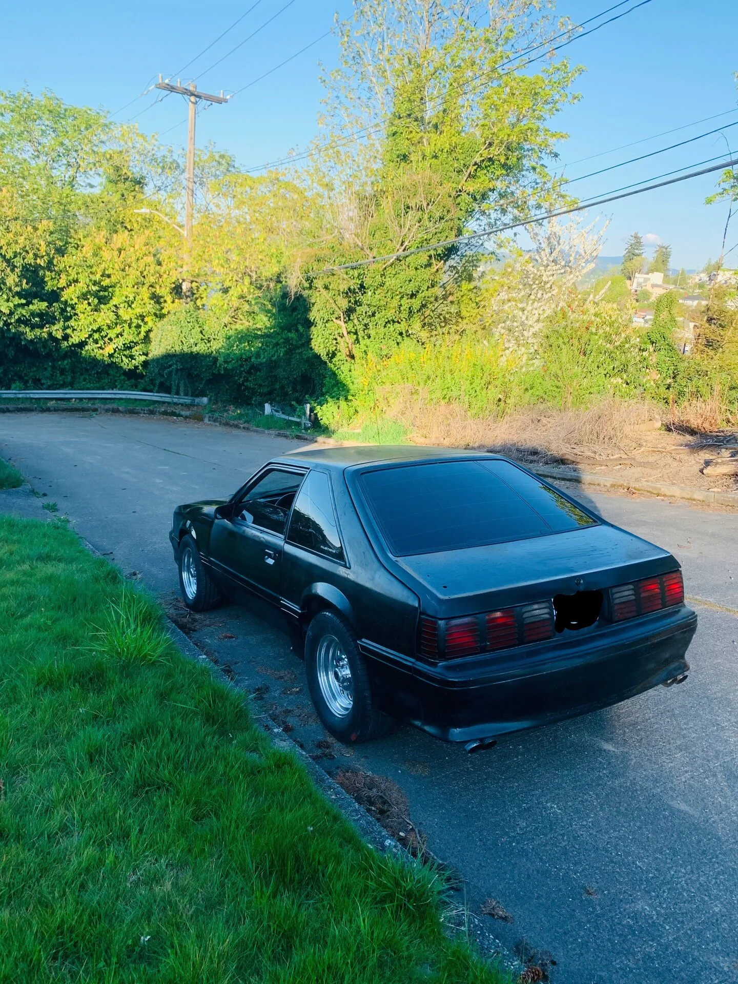

Not sure if this should be in welcome wagon but I got my second foxbody (first was my first car, a 4cyl 15 years ago)
The body and frame will be toast in about 5 years due to rust (according to a body shop) safe for now, but the engine/drivetrain are solid and it runs great. No regrets at $3500 in this market, going to get my money's worth f'ing around with it this summer.
Planning on getting a 4cyl with a clean body in the next year or two (when my 2 car garage is finished) and swapping out the engine, drivetrain, suspension of this one into the new frame, are there any components that you wouldn't suggest upgrading before that swap? It's pretty much stock at the moment except for GT40 intake and air filter.
Not going to do torque box reinforcements or subframe connectors since body is getting tossed in a few years. It has super nice 4 lug Weld racing wheels so putting off that conversion for a while.
Upgrading radiator and fuel pump since they're going out anyway. Nothing else NEEDS to be changed.

Hey! Welcome from another newbie :coff:
Sounds like a good set up you've got on the go! How is the rest of the car looking rust aside? Any kinda funky interior options? :pop:
Those quarter windows look pretty excellent unless the photo is a touch deceiving?

Strut towers are :dead:
Paint job is terrible DIY disaster, rust that's been bondo'd over and floor pans are flaky. It's safe to drive but not worth rebuilding.
Interior has a janky touch screen radio and "The Lean" but otherwise pretty great!
