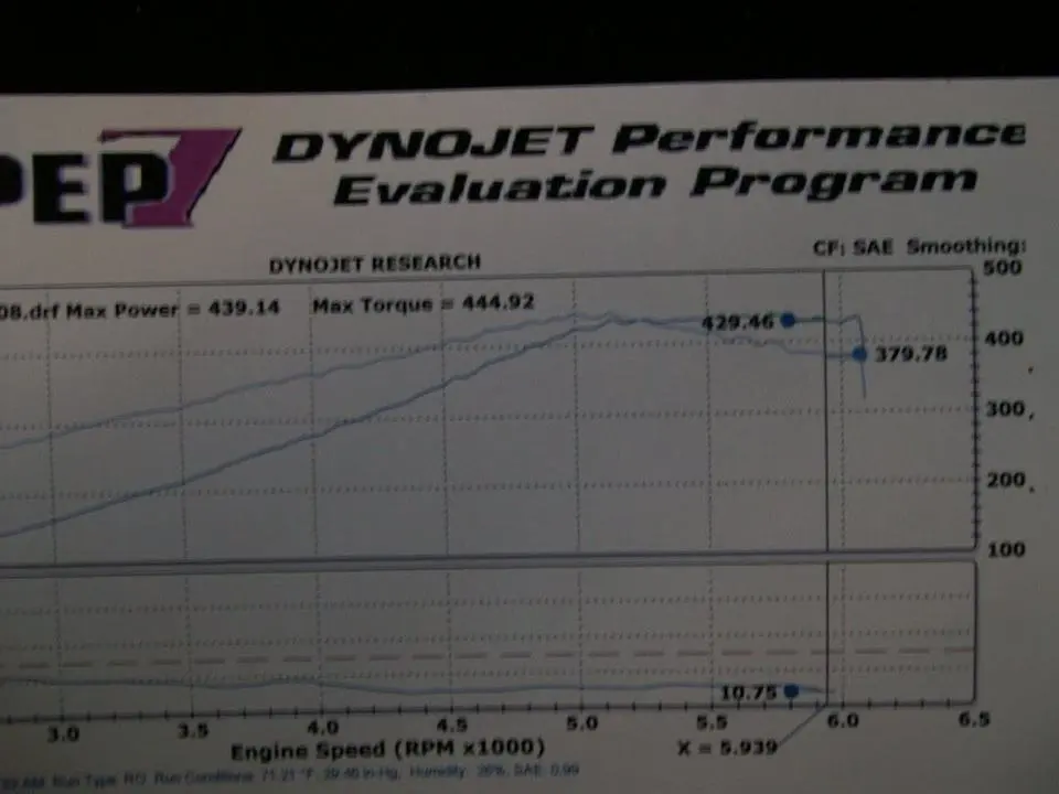

Title spills the beans :D This is my OFFICIAL BEFORE dyno. I will be doing an after run soon to compare VT STG 1 cams to custom turbo cams. Made 3 different boost passes. 7.5PSI, 9.2PSI, and 11.4PSI. Timing varies with VE, so it was ranging from 15-16*s or so.
7.5PSI

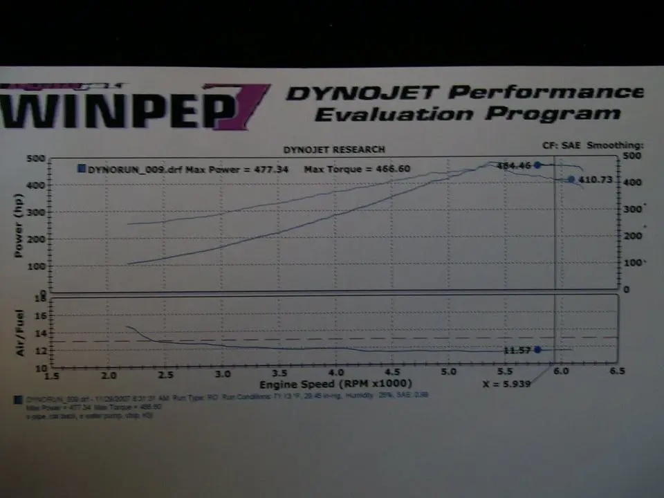

spiked to 9.6PSI...thats what made peak #s 477.

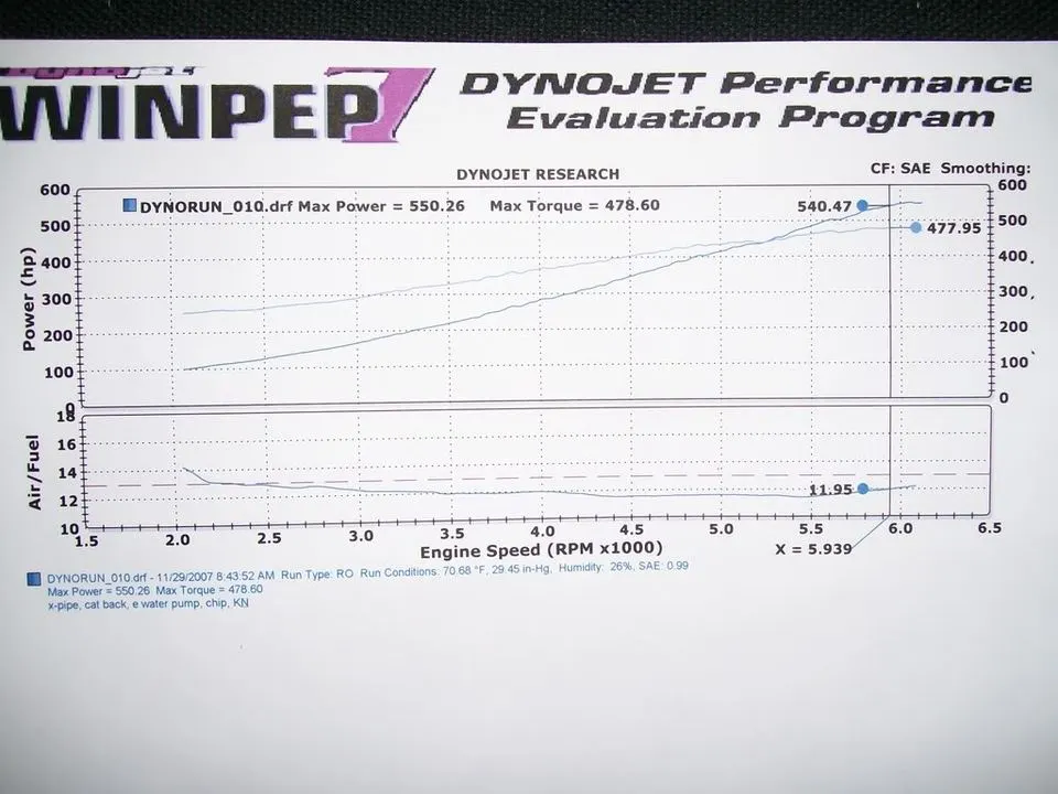

And this one was @ 11.9PSI...last 2 frames showed 11.9 so...
It was only gaining 18HP per # of boost from 7.5PSI-9.6PSI. But gaing 31RWHP per # of boost from 9.6PSI to 11.9PSI. These turbos LOVE more boost....they are just getting started @ 12PSI :rlaugh: . Just think, another # would put me to over well over 580 :eek: . Dyno A/F is 1 point leaner than my wideband shows....and that was confirmed by the workers whos widebands differed .5-1 point from the dynos tail sniffer.

I love what you are doing here! You are very knowledgeable about tuning... and you have made sure there is no detonation or going lean. You are testing the real limits of the stock block. (And rods I would think!!)
You need to get 10's on the stock block and 600 HP... that will show the nay sayers what turbo power can do.

11.9PSI was all she would get on the dyno :(
Wastegate blockoff plates :D
