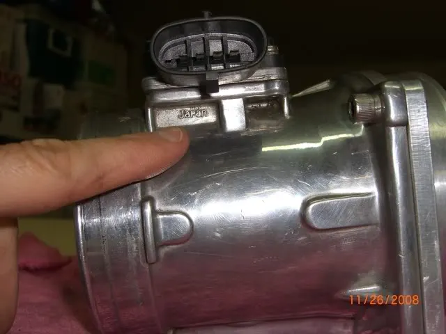

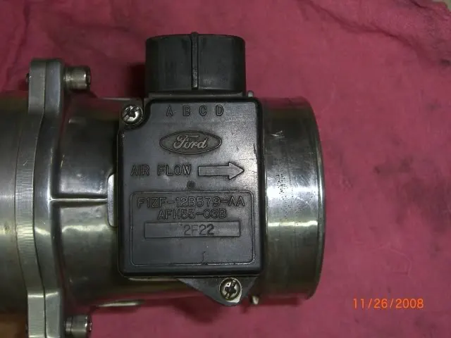

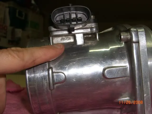

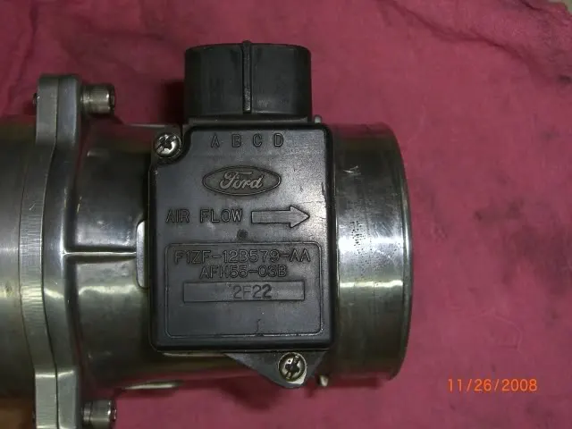

Hey guys,
I am not really sure which MAF I have here. It has ford electronics and the part number points to 1991, but this came off a blown application with 30#'s. Are lightning MAF's metal?
Thanks,
Eric

Looks like a factory sensor on an aftermarket housing
1988-1993 Mustang 5.0L (except Cobra and `93 California)
1991-1993 Ford Thunderbird & Mercury Cougar w/5.0L or 3.8L (except `93 5.0 California)
1989-1990 Ford Taurus w/3.0L
1991-1995 Mercury Sable w/3.0L
1991-1995 Ford Taurus & Mercury Sable w/3.8L
1991-1995 Taurus SHO
1991-1994 Lincoln Continental w/3.8L

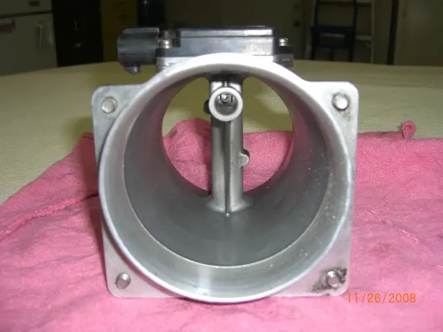

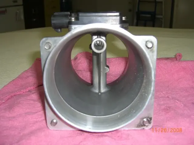

The housing looks like a stocker to me, too. Here's a pic from a '94 '95 GT MAF
Notice how the post running down the inside center of the MAF is identical to the one in your picture, even with that little bump/ protrusion on the lower right side of the post? So, I think it's either a stock mustang MAF housing, or at least a production ford housing. How wide is it across? I think the stock fox-body MAFs measured 58mm.

It's a mismatched Frankenstein meter....
The sensor is the same one used on a Fox 5.0L from the factory... you know the one that was only 55mm...
The housing looks like a 70mm unit (similar to the 94-94 Mustang), but there are several housing sizes that used the same design features. You'll have to measure to make sure.
I've never seen that sensor on a housing like that. Without a custom tune, I don't see how this combo could run well....
What year/model was this unit used on?
Did the car have a custom tune via the J3 chip/port?
I'd really like to know more about the vehicle that was running with this meter....
