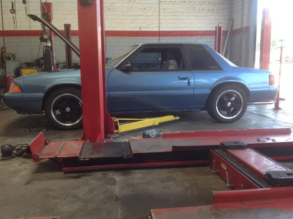

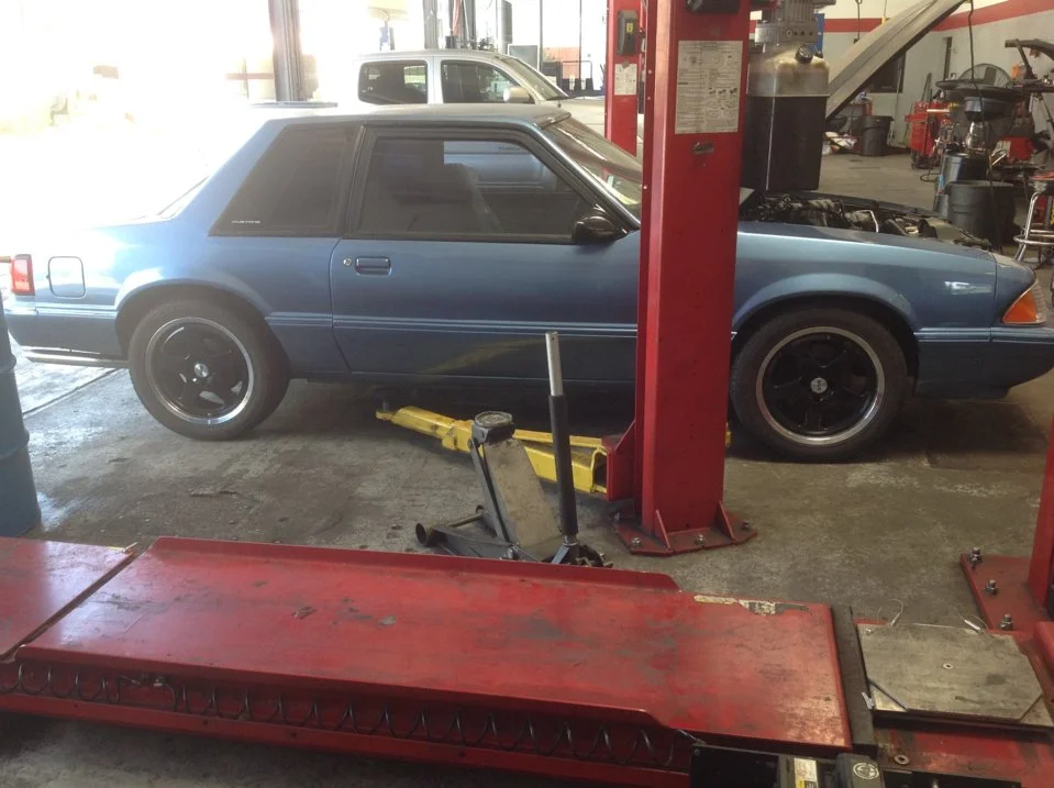

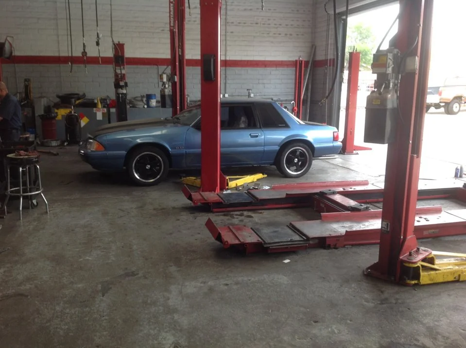

UPDATE: Ride height fixed, lopsided crap fixed.
Reactions: A5literMan, 89oem, FoxMustangLvr and 1 other person
joetrainer31
Mar 31, 2013
869
364
114
SC
Sep 3, 2015
#199
  • Sep 3, 2015
  • #199
No Mo 4X4 or gangsta lean.
