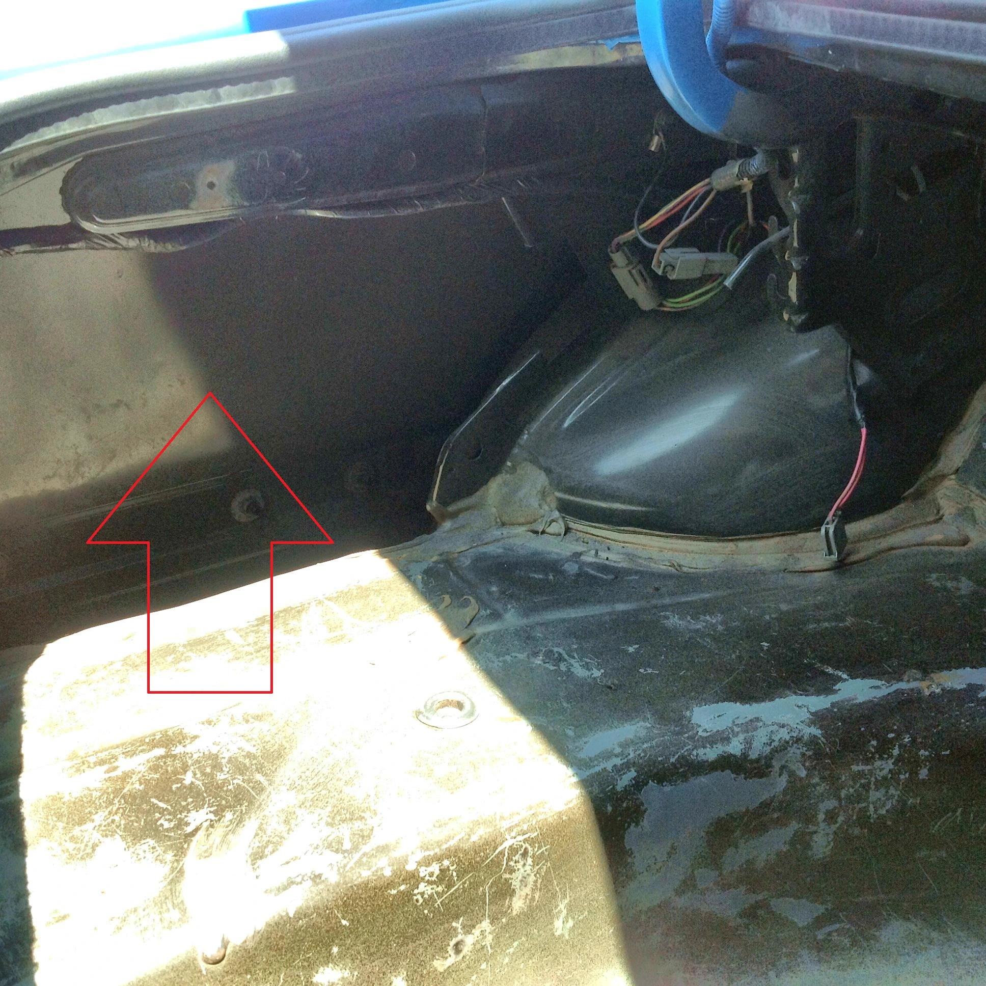

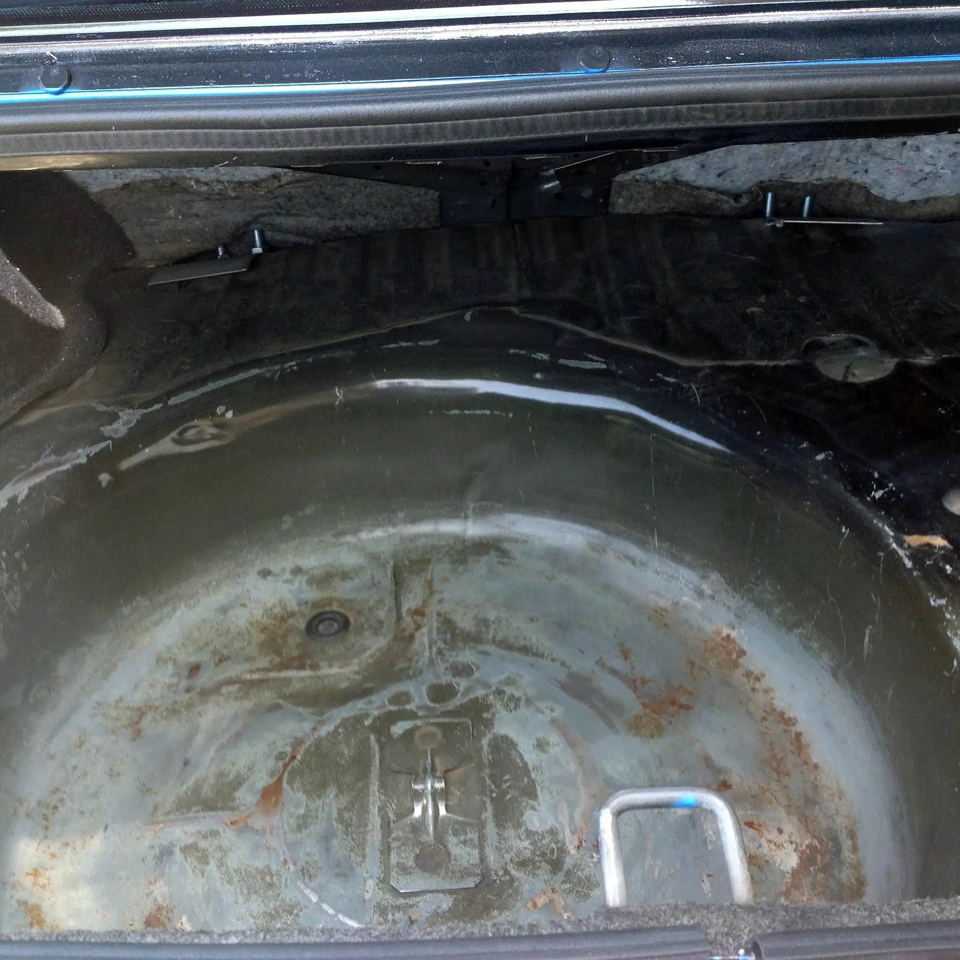

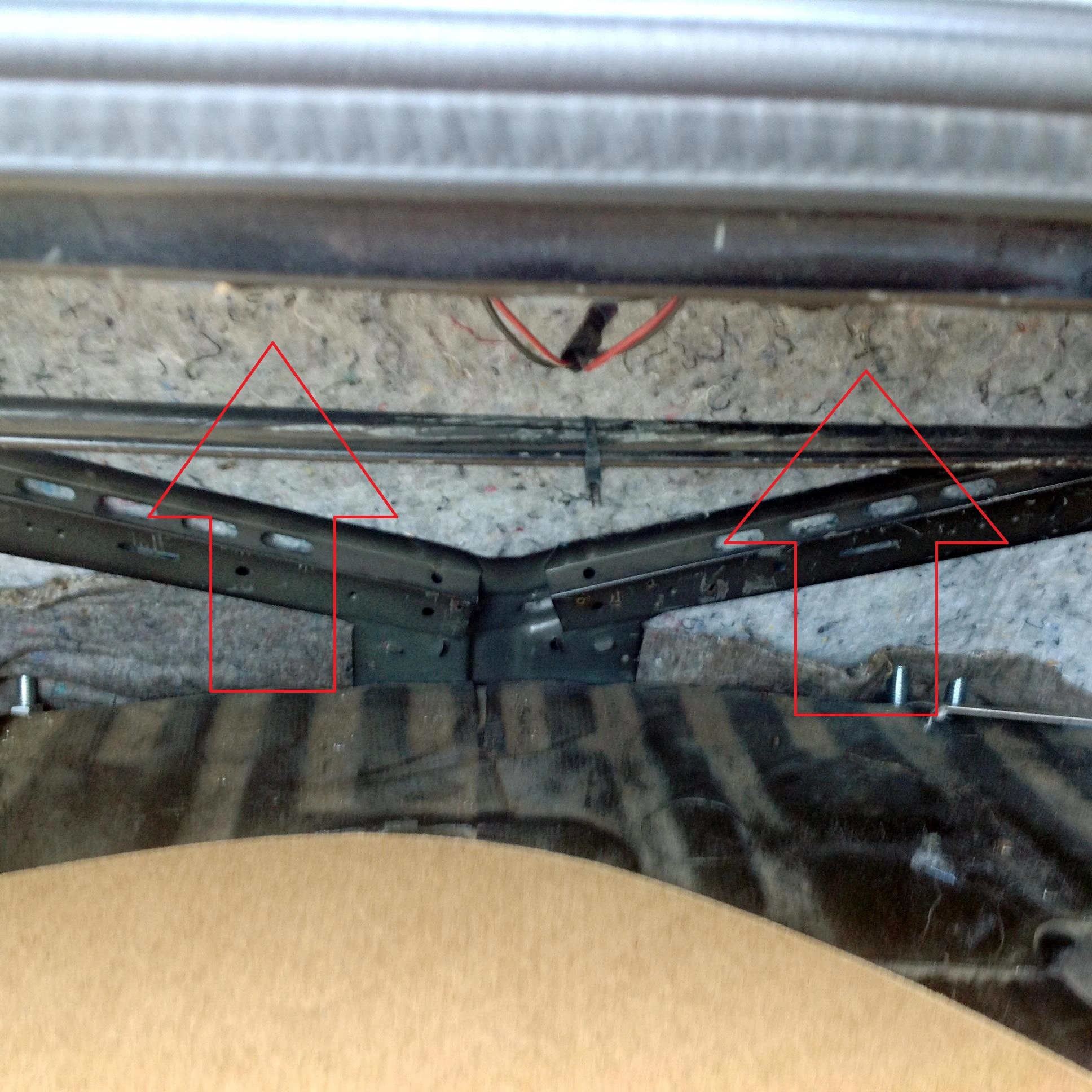

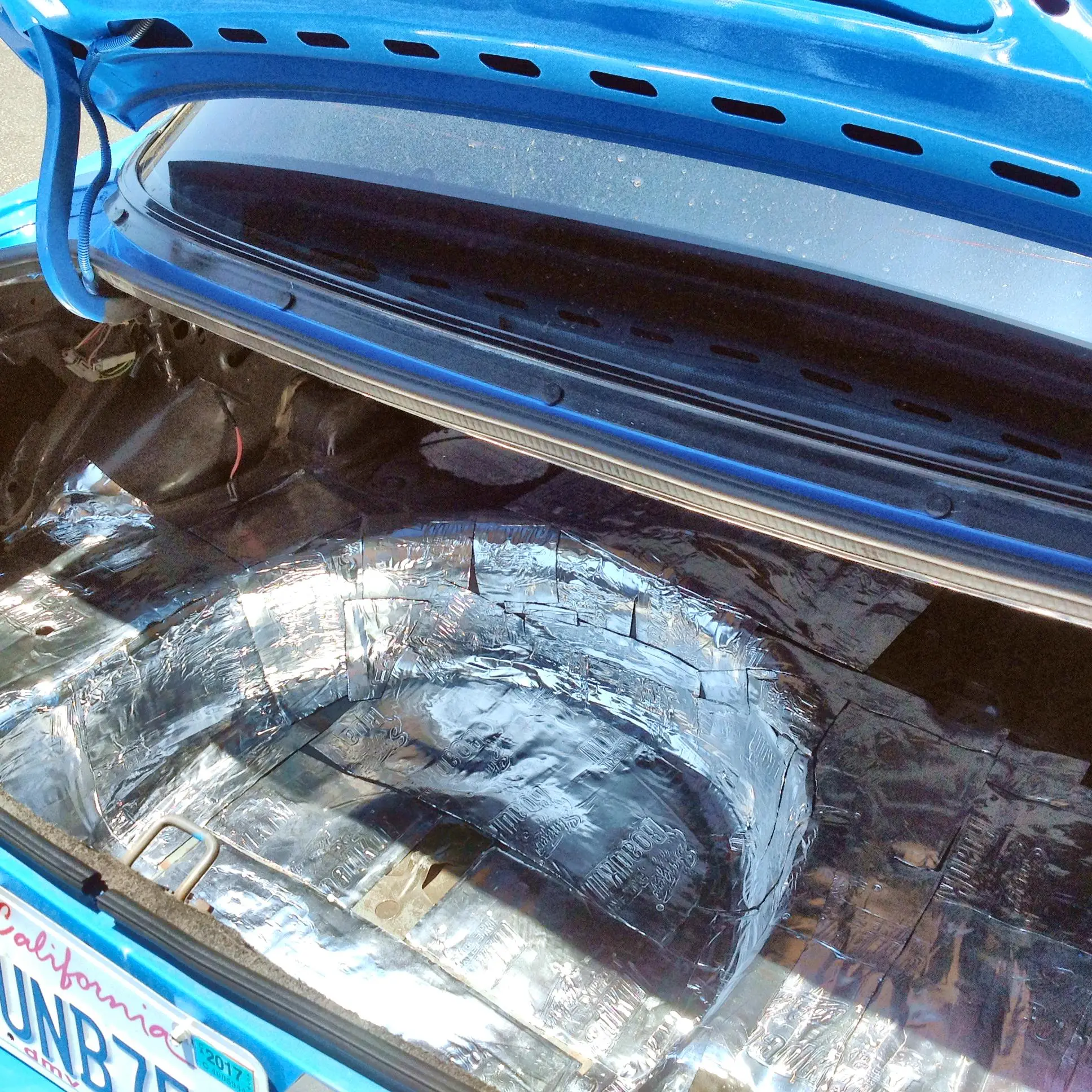

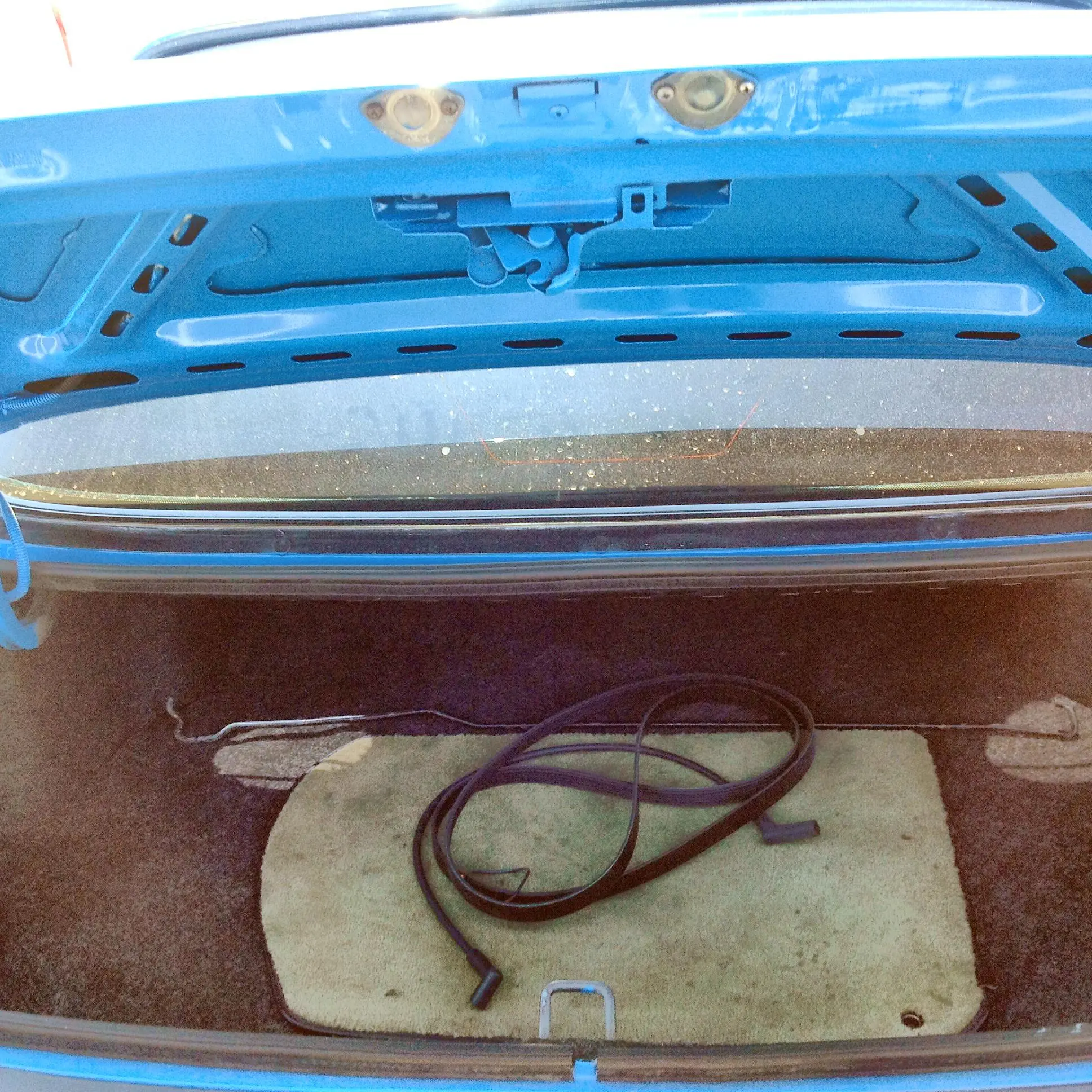

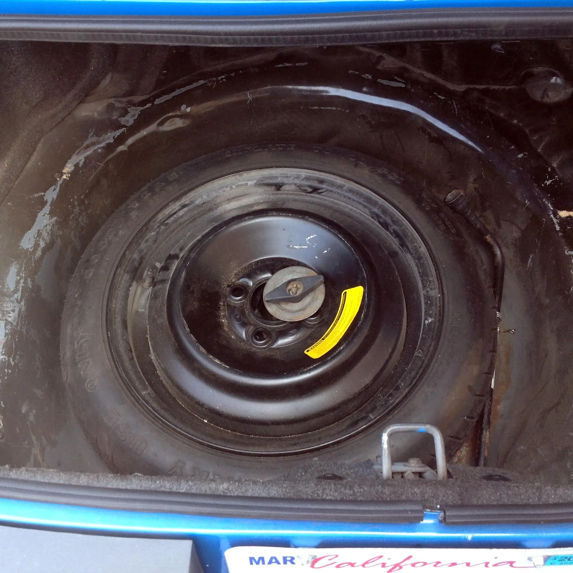

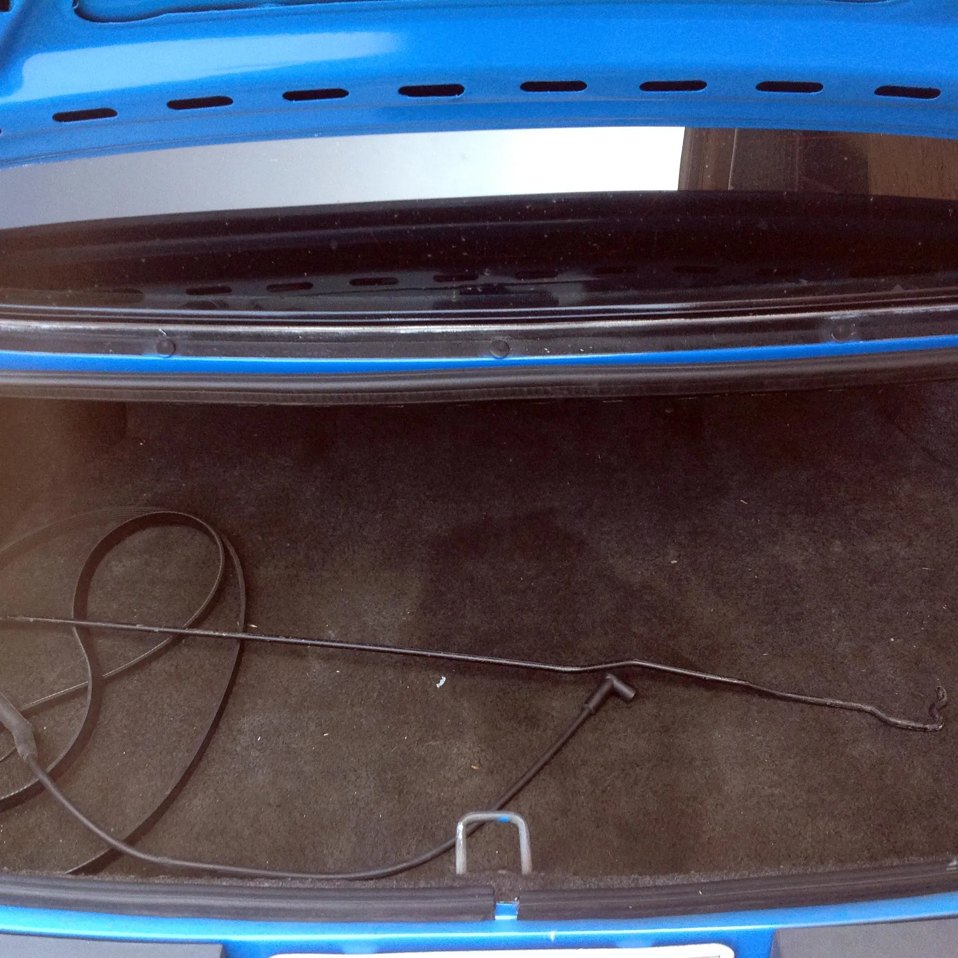

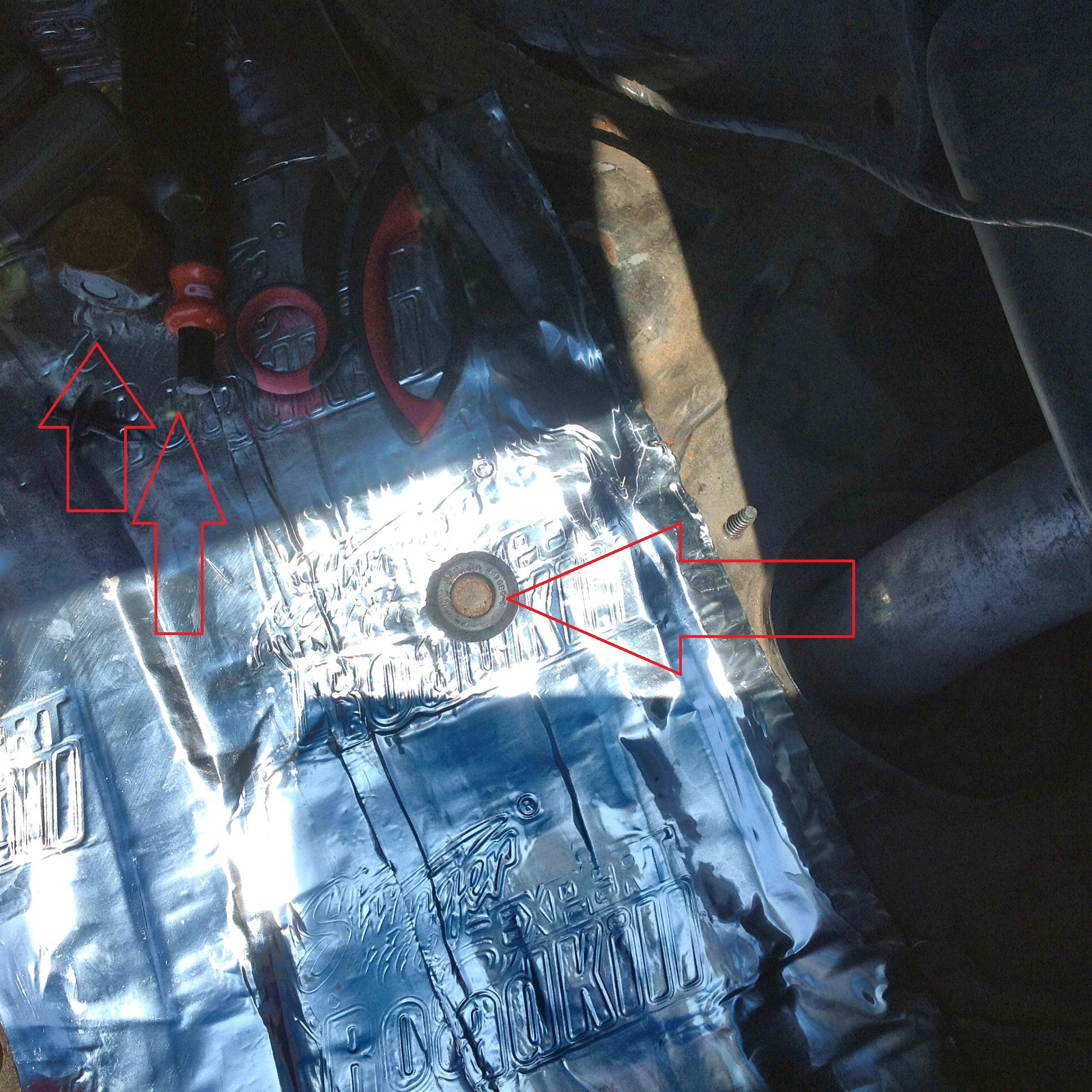

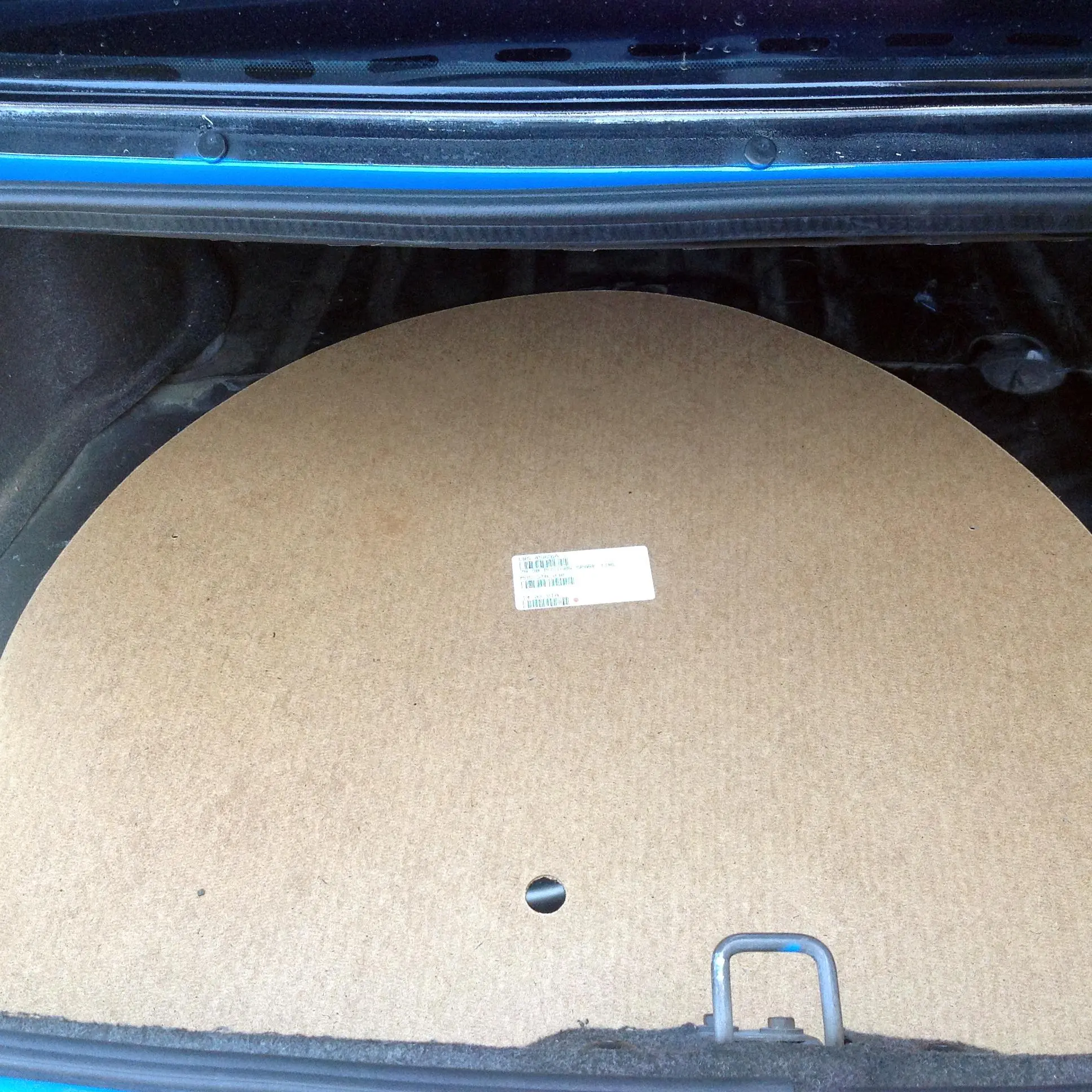

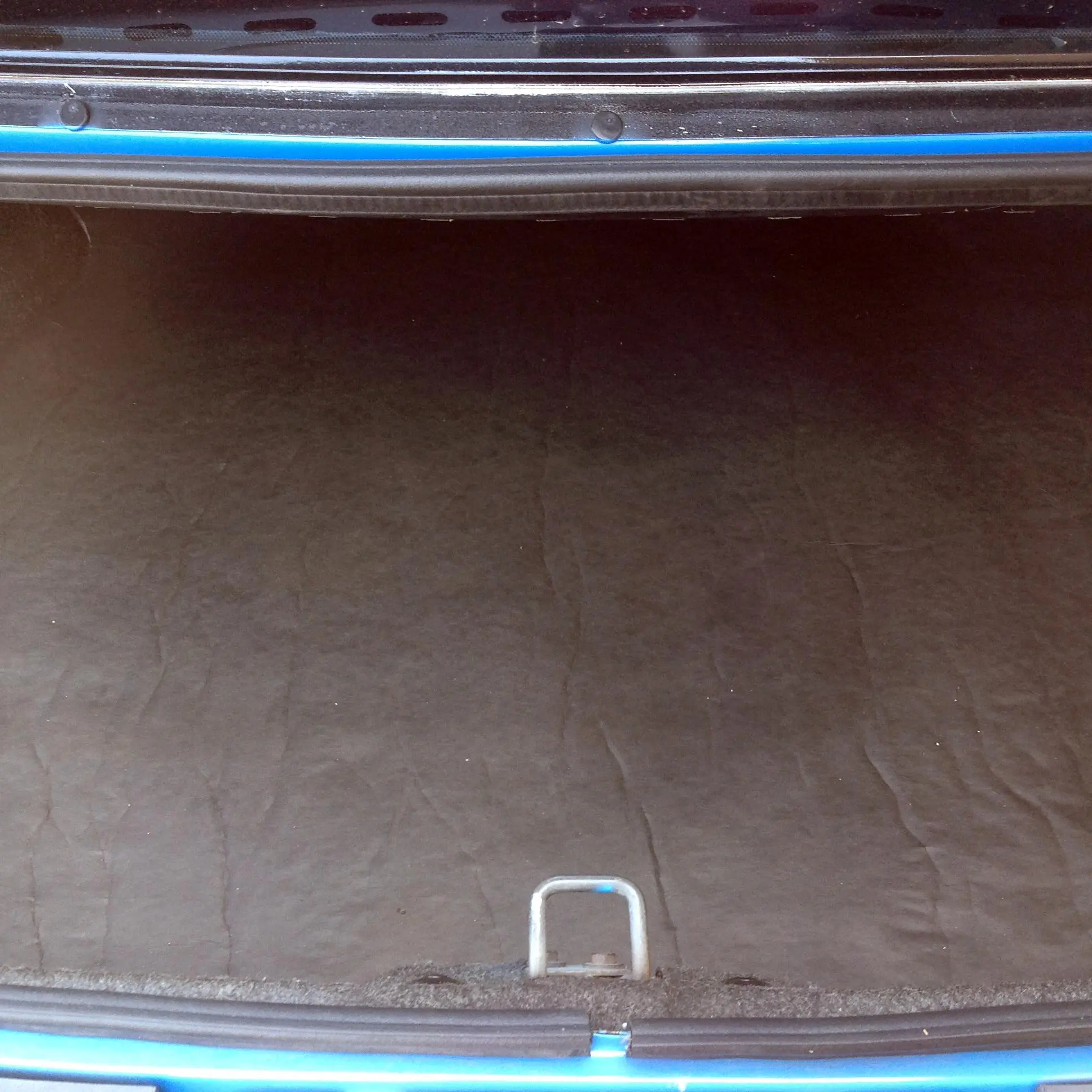

Update: Tamed Trunk.
So, @92NOTCH01 convinced me to go ahead and put Roadkill in the trunk area. I went and inspected the trunk area. When I knocked on the bare metal pan it sounded like knocking on an empty tin-can. That is [horrible] for noise and heat transfer. Therefore, trunk taming was necessary...
First, take all the junk out of your trunk, remove the trunk carpet, and promptly place it in the washer machine or some other type of cleaning apparatus. That thing is old, stained, and it smells of automotive fluids in many cases. Just because our cars are old doesn't mean they have to be trashed.
Next, if so equipped, remove the factory insulation carpet...
Then, remove the cover to the spare tire and jack. If you don't have the cover get it. It's cheap and keeps your trunk floor level. Why should we have holes and unevenness just because our car is old?
For a coupe, make sure you have the proper rear seat back sound deadener blanket. It really does matter when it comes to heat and noise. If you don't have it LMR has them cheap.
Next, remove the spare tire, jack, etc and inspect floor pan for holes. Mine had several holes from some numbskull who was drill happy. He also had a battery in the trunk at some point. I filled all the holes with a clear silicone. I'm not a fan of exhaust fumes in the cabin.
Thoroughly vacuum the entire trunk and wipe down with alcohol...
Next, remove each side of the trunk trim carpet after deciding not to be lazy. There should be 2 push pins on each side. You may want to consider buying a box of replacement pins [before] pulling your old ones out. The pins usually deform after a use or two. Then, clean the area the trim carpet was covering...
When applying the sound deadener make sure to retain the trunk drain plugs in case of water intrusion. In order to line the holes up when laying down the deadener I simply go slow, use an ice-pic type tool to make the target (far left), then use a bigger punch (to right of pic), to bore the drain hole out...
You can cover the entire trunk area. Just make sure to make provisions for all drain plugs and the spar tire :J" bolt. I didn't measure as precisely as I should have so I had to cut some filler pieces. While it doesn't look as good as it could, it [is] under the carpet, and still does the same job.
Replace the washed carpet in the trunk, put various items back in the trunk, decide if you still want to use the factory deadener blanket/pad, and close her up!
While I did not test drive the vehicle yet I did start it up. I could already tell a difference in cabin noise reduction. The exhaust sounded like it was out back, out "there,"and separated from me instead of with me -if you know what I'm saying. I plan on test driving later and posting the review.
Lastly, if you're keeping track: 1 box of Stinger Roadkill Expert covered the entire roof, both floor pans and trans tunnel, and the trunk. That's a great deal for $90, some labor, and some sweat. If I knock on the trunk pan now there is no empty tin-can. It's a thud.

Update: Roadkill Results.
The driving expierence is [way] better with all the Roadkill installed. Each section (e.g., roof, floor pan, trunk) added a level of compartmentalization to the interior, but all three are really nice. The interior is way more quiet inside. I can now hear a little squeak inside that just won't do. It also stays cooler inside. The A/C seems to be more efficient with the added insulation.
I chose to omit the factory sound deadener mat from the trunk with the Roadkill installed. The Roadkill does a better job anyhow and I don't see the need for the extra 12bs of insulation.
