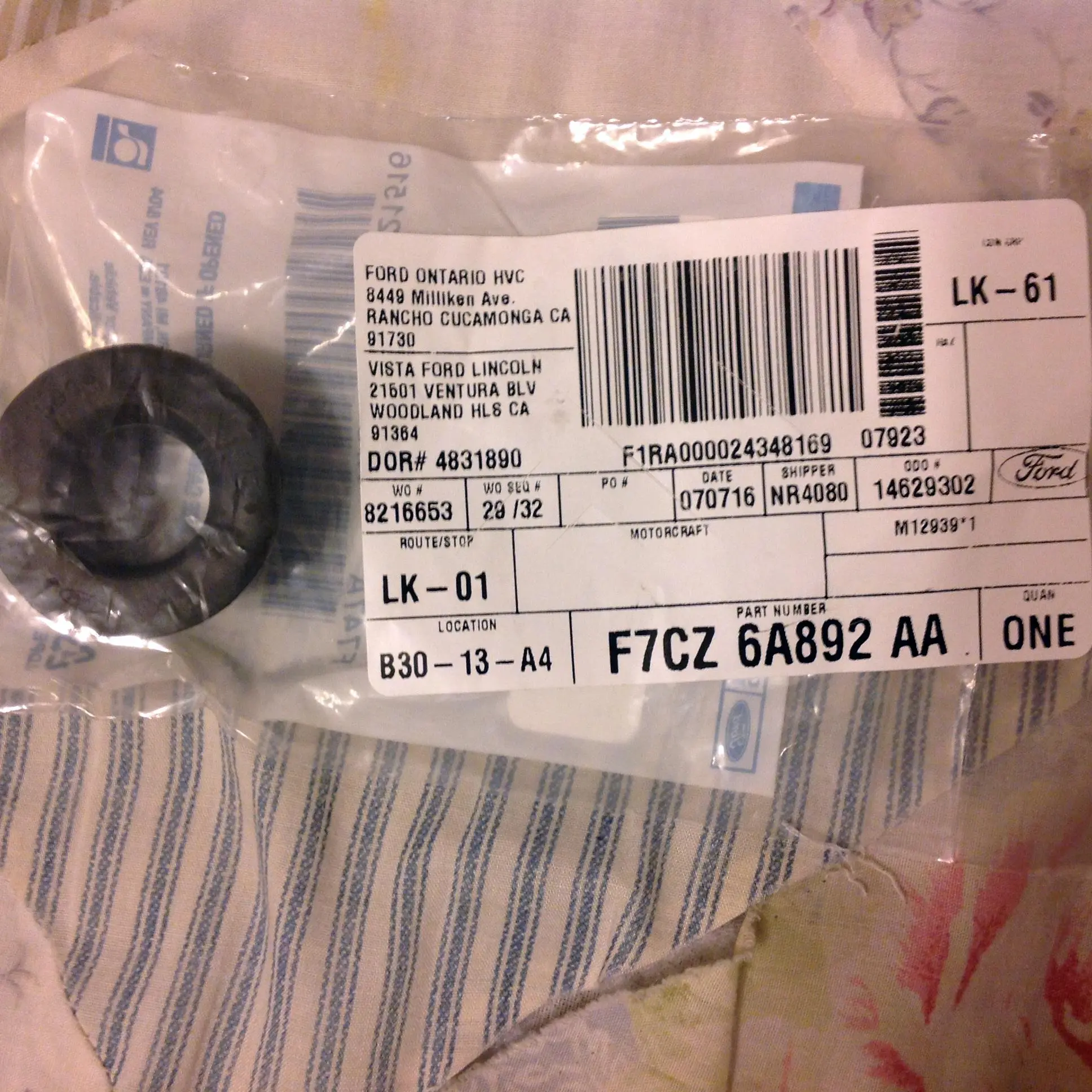

Update: Vacuum.
Think I just solved the faint whistling noise (i.e., vacuum leak)! A friend suggested that I check the PCV system for proper installation since there have been several redues.
I checked the system and the grommet was butter loose in the manifold, the PCV was butter loose in the grommet, and the vacuum hose was butter loose on the PCV. Since this is the second aftermarket PCV grommet on this manifold (and I had 2 on a previous manifold), I went to the dealer for better part fitment.
The dealer grommet fit more securely in the manifold and the PCV fit more securely into the grommet. Then, I got smaller (i.e., 3/8"), better quality vacuum hose for the hookup. This seemed to resolve the problem. In order to double check for leaks I took a can of carb cleaned and sprayed around various vacuum hoses and the plenum to manifold connection. I did not observe any engine fluctuations at this time. Once I corrected this issue the car also idles a little cooler.
Then, because I was there and go faster I bumped the timing to 14* BTDC, adjusted the idle down a bit, and verified TPS voltage which was at 1.01 volts. From what I've read that voltage should be fine. Although, I'm open to data backed correction.
Lastly, you might ask how I got a dealer PCV grommet for a 1990 Mustang when Ford has a 10 year obsolescence program. Well, I didn't. I got a grommet for a 2001 Ford Explorer 5.0. In case you go looking for the same thing here is the part number:

Update: Vacuum Test Drive.
Took the car on a test drive after PCV grommet & hose R&R, and timing increase. I observed:
1) Cooler idle and running temps after vacuum fix (even w/increased timing)
2) Rock steady idle and idle recovery after vacuum fix.
3) More healthy sounding engine after vacuum fix.
4) Noticeable increase in performance with timing bumped to 14* BTDC.
Interestingly, there is no pre detonation sound at all, even at WOT up to the redline. This is interesting because I have about 10:1 compression and am running 87 octane. It seems that it's true that aluminum heads allow you to run more timing than cast iron heads. I know with my old cast iron heads that I could not think of running 14* timing with 87 octane and stock compression.
Side note: I am running a stock cam w/1.72 RRs if that helps shed any light on why I can run higher timing on 87 octane.
