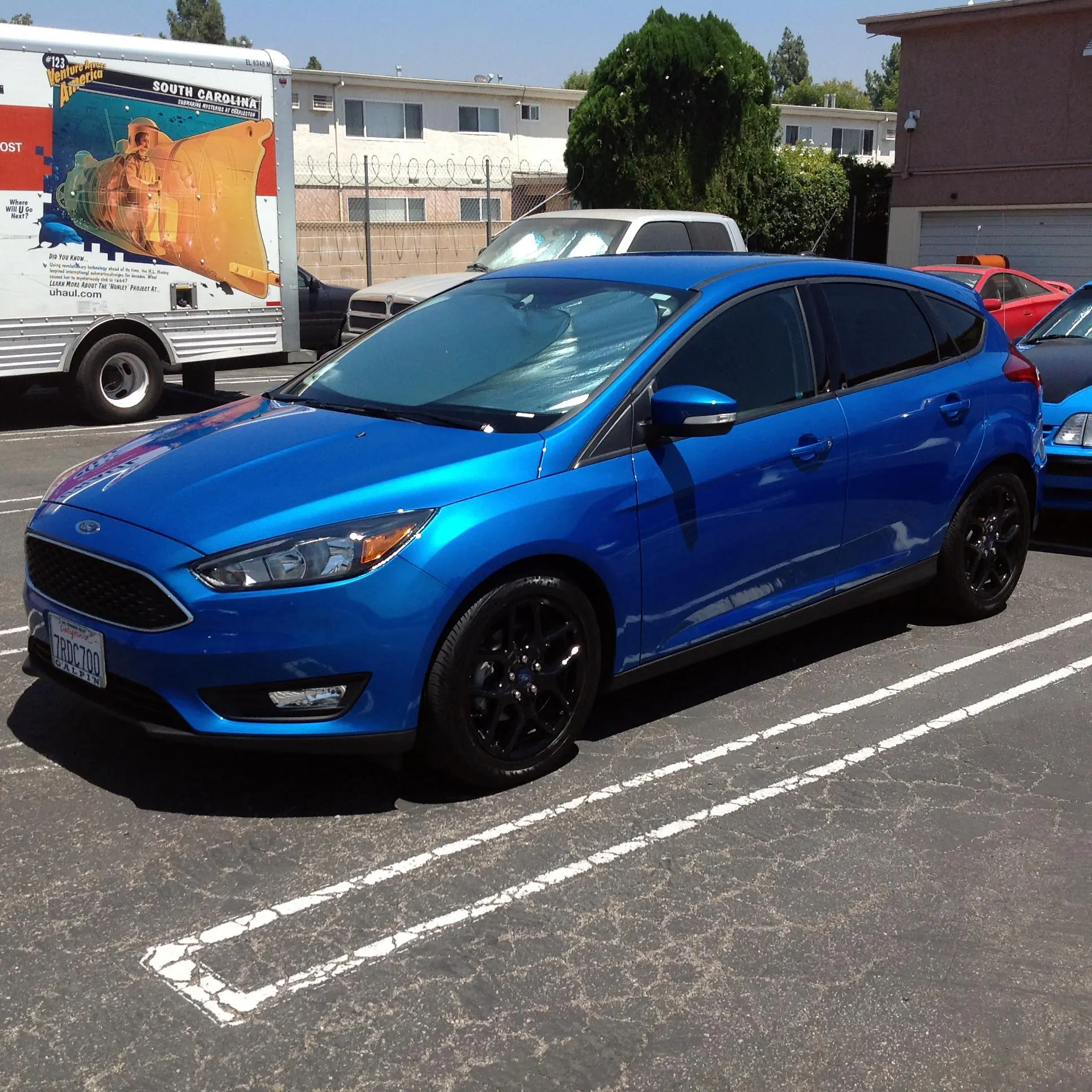

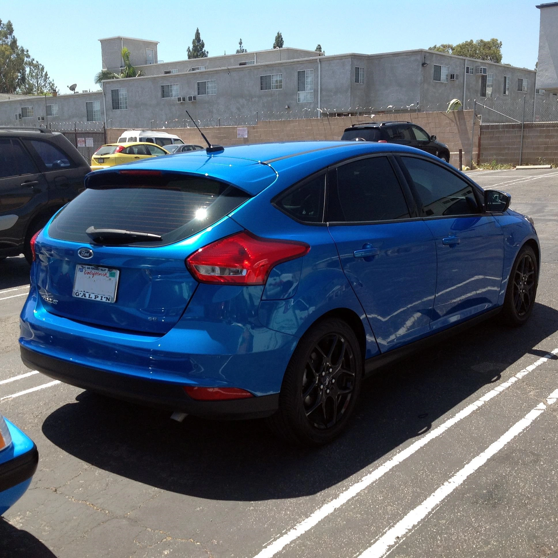

Update: The Other Car
While it's not a Mustang it is a Ford and the wifey's car. I was finally able to get it all cleaned up.
