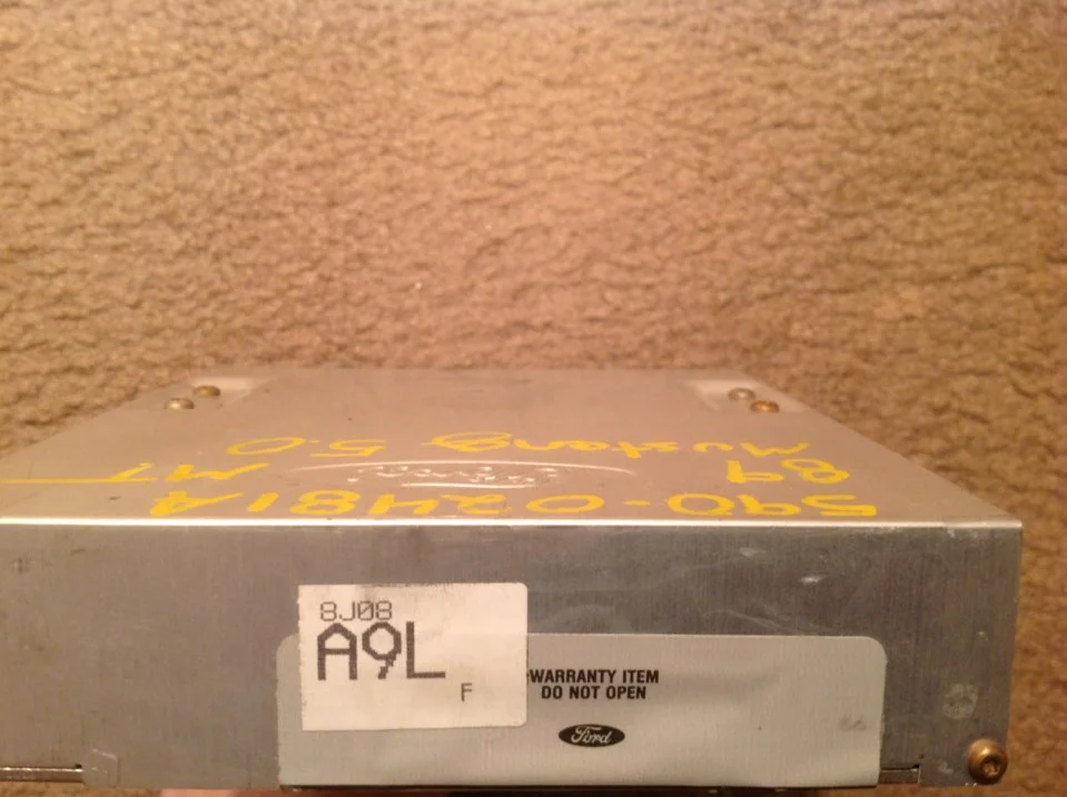

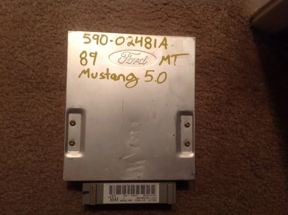

UPDATE: The replacement ECM has arrived!
It's getting difficult to find a replacement A9L these days. This one came from Oregon and cost $175 including shipping. I remember being able to get them from Autozone for $99. What happened? Anyhow, this one is still sealed from the factory.

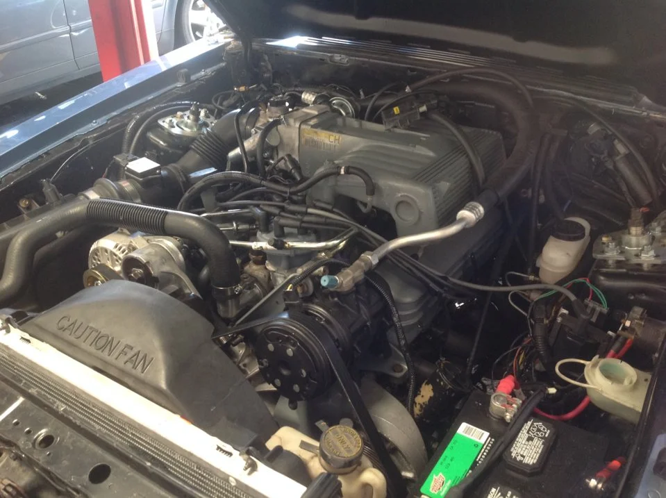

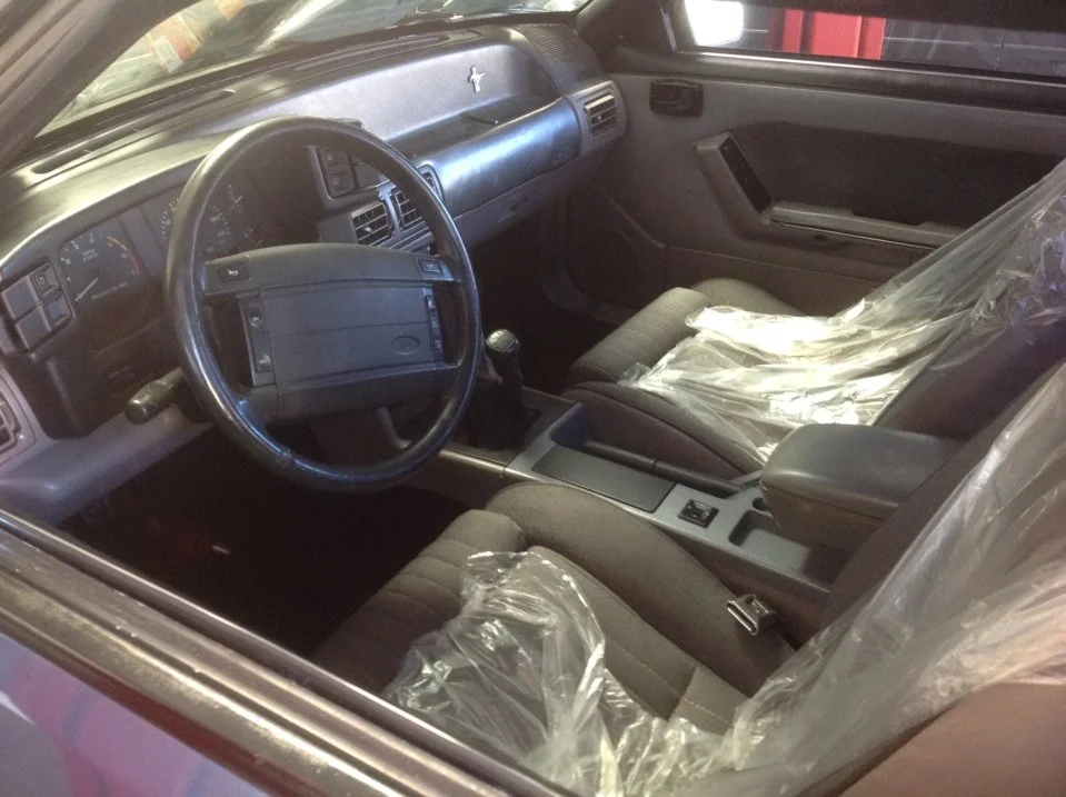

Update:
Interior coming together. The A/C is BOSS when all components are new!
Underhood coming together...

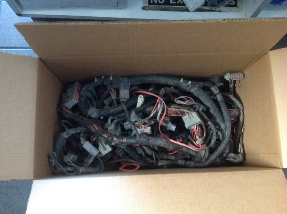

UPDATE: We figured out the solution to MAF/IAC non-operation - R&R the entire car wiring harness. We found a functioning donor car and snagged every wiring harness it had for $450. Pics forthcoming...

Update: For those of you who woke up this morning wondering, "I wonder how much all the fox body wiring harnesses weigh?" Well, wonder no longer, sir. An entire car's wiring harness weighs right about 18lbs...
