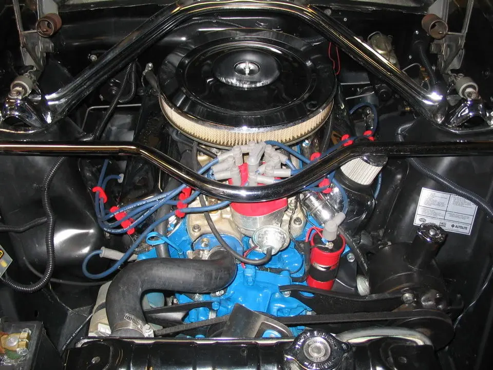

My 65 gt350 clone with a standard 289 and automatic tranny has started doing some peculiar things. It will start and run fine at a high idle speed (1200 rpm or so) but when you put it in drive it stops immediatly unless you rev it up to 2500 or so and pop it in gear. It seems more electrical that carb. It has a electronic accel disributor. Any ideas? thanks Here is a pic when it had the MSD dizzy
