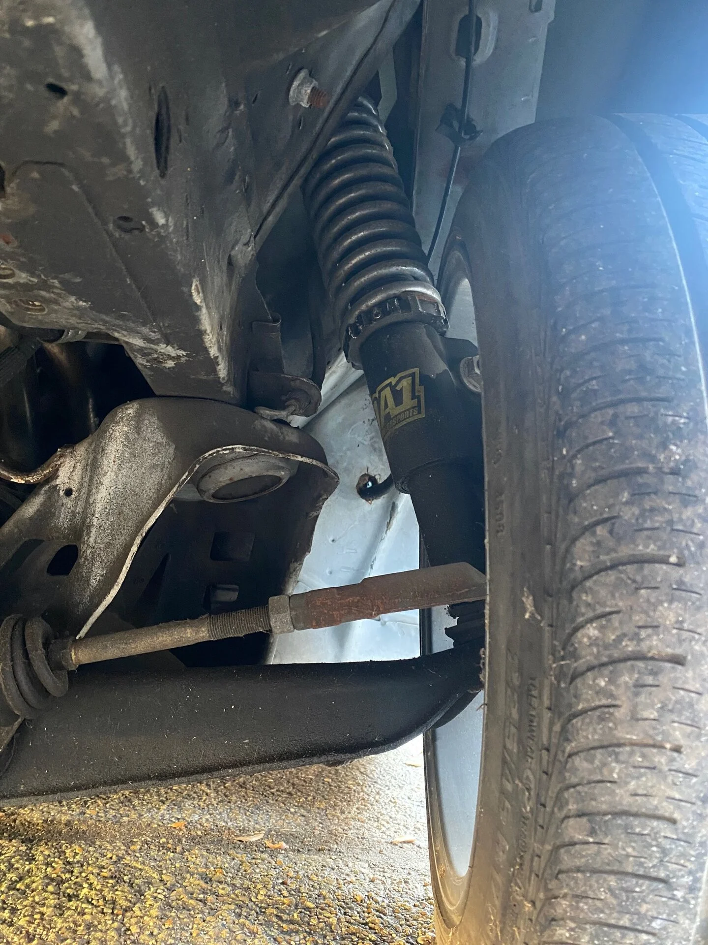

@KRUISR I stopped by the storage today, here is what mine looks like. I am starting to wonder if just a 1/4" spacer would do it. I am going to do a test fit next week.

Personally I'd avoid spacers at all costs unless you're talking like a 1/8 or 1/4 just to tweak fit, put your stock stuff back on and save your pennies for a properly fitting setup. Unfortunately, throwing on some used odds and ends from another car does not work for reasons like this. Suspension mods have to be well planned out and include things like spindles and wheel selection to make everything fit properly. There's no shortcuts to be had especially going to coilovers.

It works fine, it's not a suspension issue, it's a wheel offset issue. I would have the same problem if I bought a slip on coilover kit designed for fox struts and didn't pull these off another car. New spindles aren't required for coilovers, I just need better fitting wheels. I don't have the stock stuff, so spending money to go backwards isn't what I want to do.
Everything I've read says wheels spacers are safe, why avoid at all costs?
A 1 /2 inch spacer (hub centric) is not unreasonable to me, a crutch but not a big deal, I wouldn't do it but that's me, see if there is any adjustment on the strut to spindle bolts, check to see if the top of the tire is not tipped in, best backyard advice I can give.

A spacer will wear out the outer wheel bearing sooner
Not a big deal each one but there are several reasons spacers are a bad idea
+1 the tipped in tire at the top
The camber should be -.5 degree
There should be some slop (play) in the strut bolts to spindle (bigger bolt holes than bolts diameter)
Pull the wheel away from the strut with the bolts loose and then re torque them
A quick question ... do you have offset rack bushings? If so, are they offsetting the rack down? If they are, I would recommend offsetting the rack up. This will get your tie rod arm more parallel to the control arm line between bushing and ball joint. This will help with any bump steer you may be experiencing.
The tie rod looks odd.
Looks fine to me. We just can't see the ball joint portion.
@mob ... I would get the alignment before further messing with wheel spacers, because to get proper camber/caster the strut/coil may need to be closer to the rim/tire. Just my 2 cents

It's put on correctly, the car is just too low which I think is giving it the angle. Next week I am lifting the car back up to a proper ride height. 10 yrs ago I thought it was cool to slam it, now I can't even fit a jack under it.
Camber adjustment up top won't affect the spring to tire clearance.Both are attached to the spindle so that relationship can't change.
If the strut attachment hole is slotted,loosening the strut and pulling out on the hub/tire can gain you a small amount of added clearance.

Car is just too low, I am going to raise it back up. and that makes sense about the alignment
That’s what two of us said to do.
