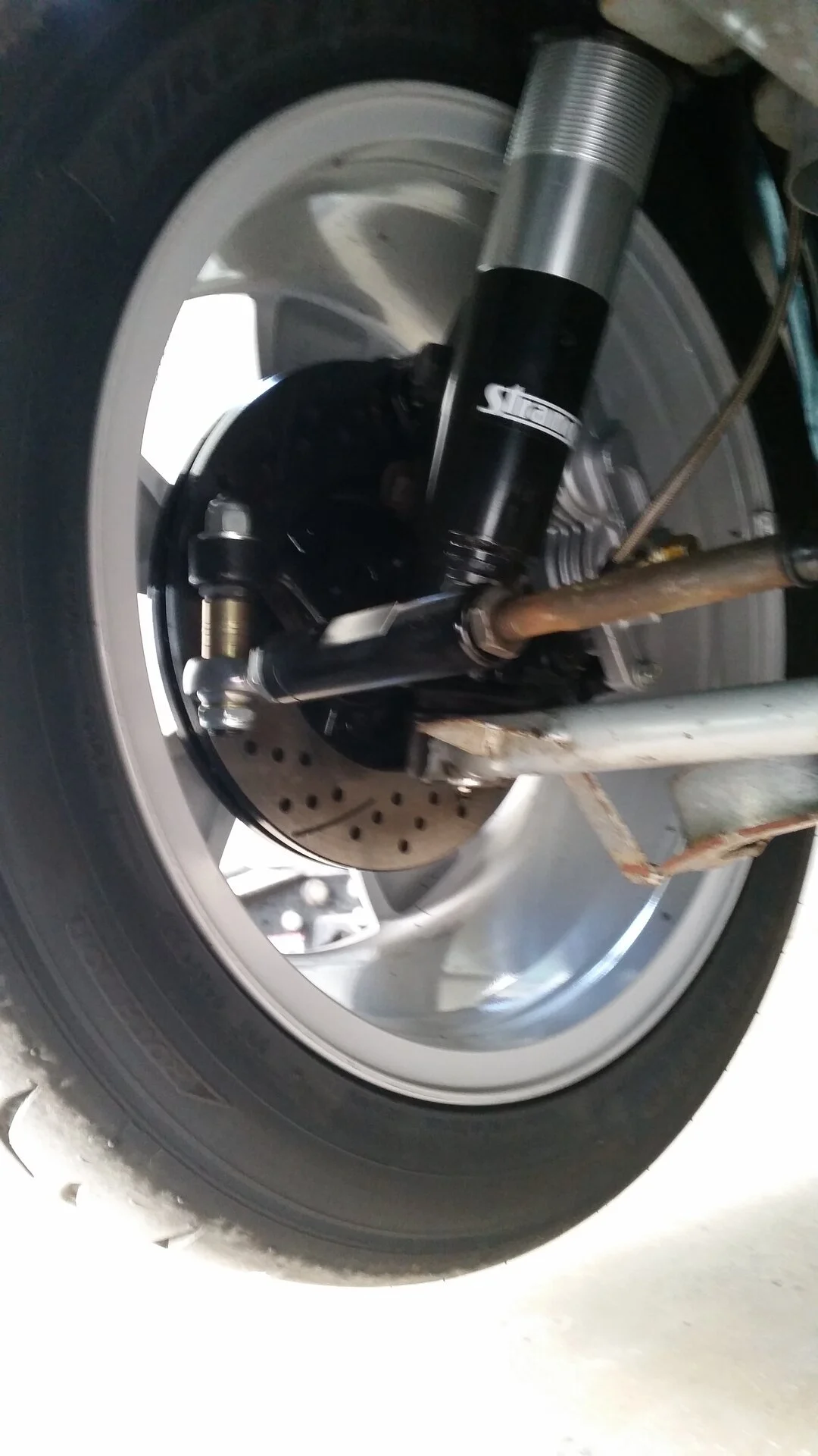

What I found depending on driving setup. I put 150lb springs in mine instead of 175lbs. This drove the spring higher on the strut to set ride height. As you can see it is above the rim lip on the 17" rim.
