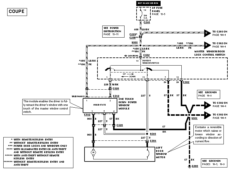

my power window wouldn't go up or down anymore so i changed the motor and it seemed to do the trick, only problem now is that the switch on my door won't do anything. so what i'm assuming it must be some sort of short circuit. any help would be kindly appreciated
Here is a coupe:
Here is a convertible:
