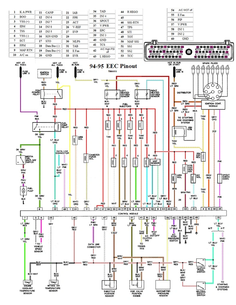

Also.... Since it's a 95... This might help you greatly:
Step by step... You will find the issue(s) :nice:

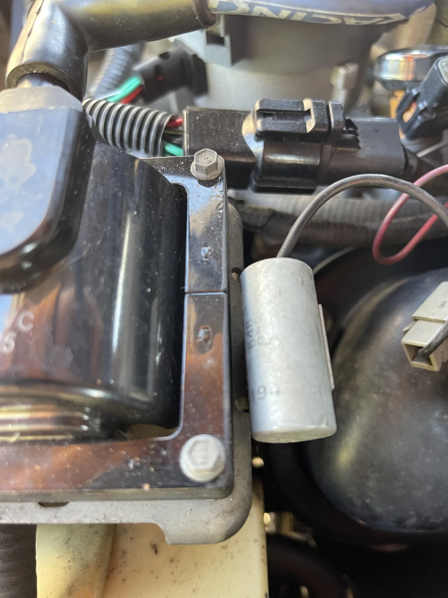

Anyone have an idea whats this is called and if can cause my problem its almost the only thing that hasnt been replaced, looks like a old school condenser but cant seem to find it anywhere

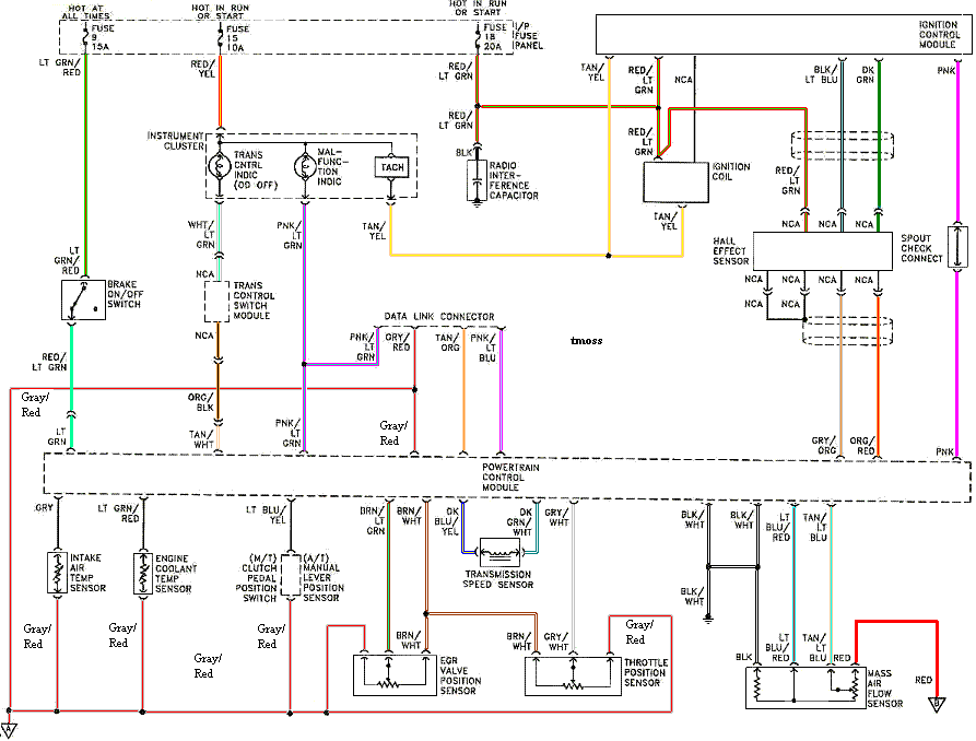

Yea spout connector is in place checked connector wiring also, distributor is new, ignition module new, im starting to suspect the ecu based on this wiring diagram.
