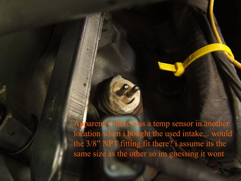

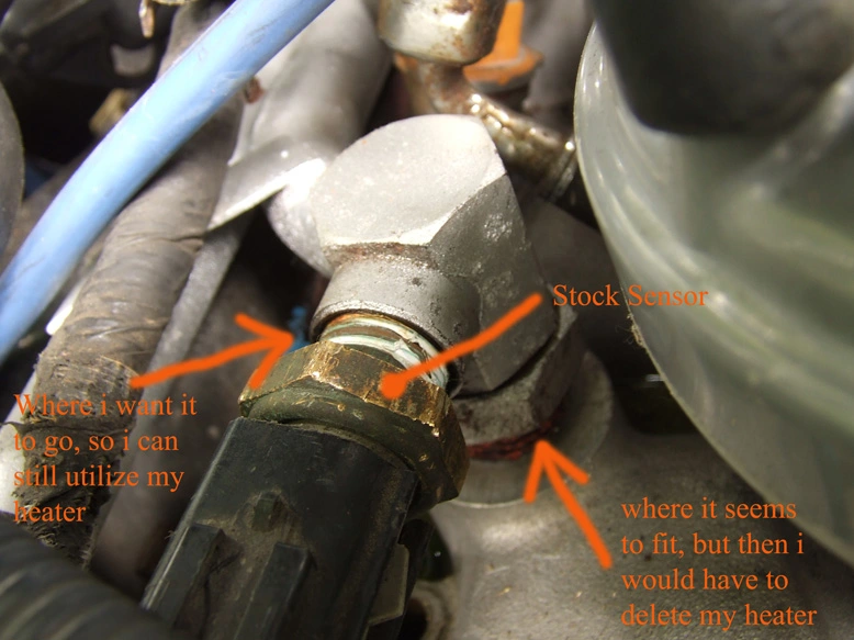

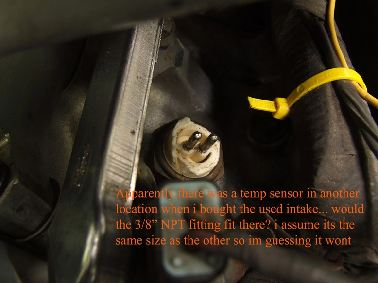

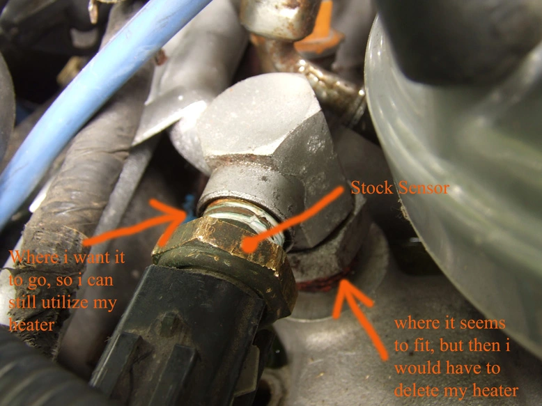

ok guys, just recieved the new fitting in the mail, and its the same thing! i think we are talking about different things.
what size fitting do i need to put it where the current sensor is?

You have the ECT pictured. YOu dont want to hose with that sensor - leave it be.
The stock sending unit for the temp gauge is behind the dizzy. That's where you should put your new gauge's sender. Then you can relocate the stock sending unit to a dead port on the rear of the lower, the t-stat housing, etc.
