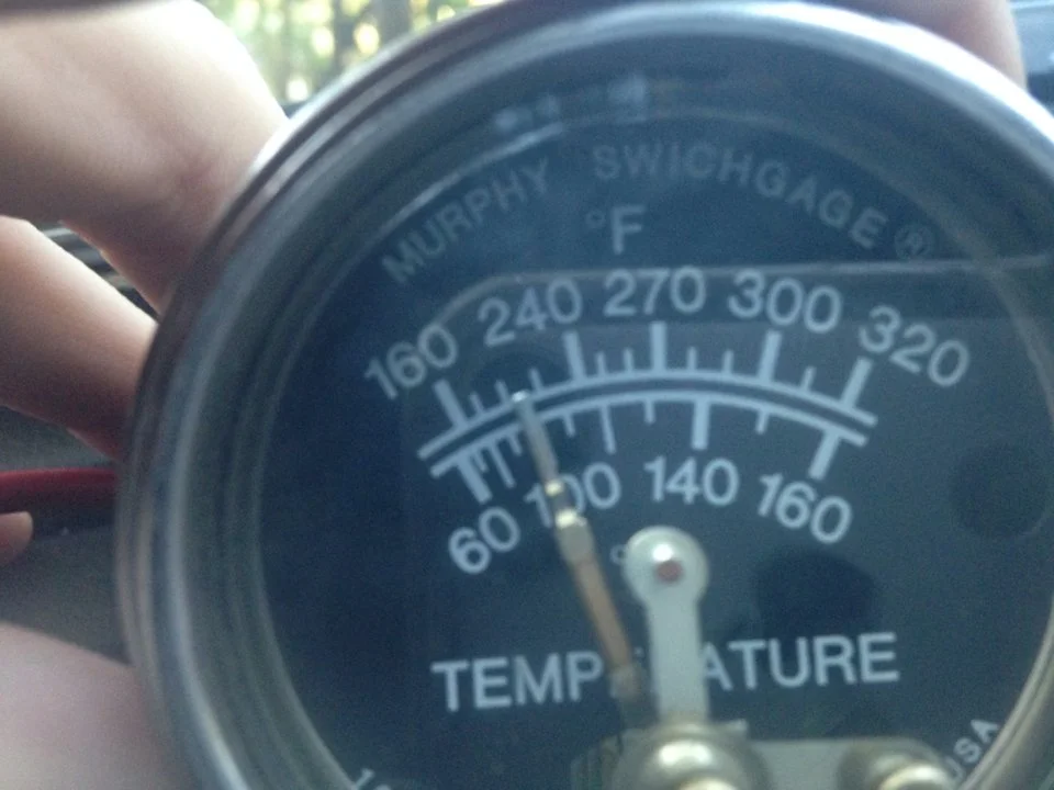

Here's what the mech reads

That gauge is reading 210. That is too high for my liking. Have you done anything since I last commented on your problem?
