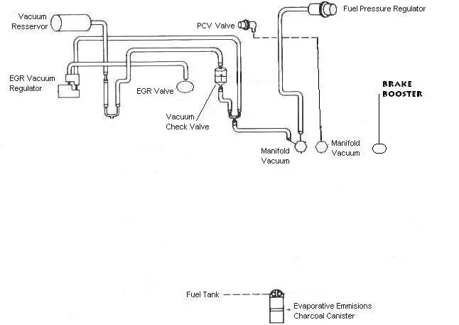

No doubt...a great site. I'm going to try and attach a pic that is close to what I have left.
