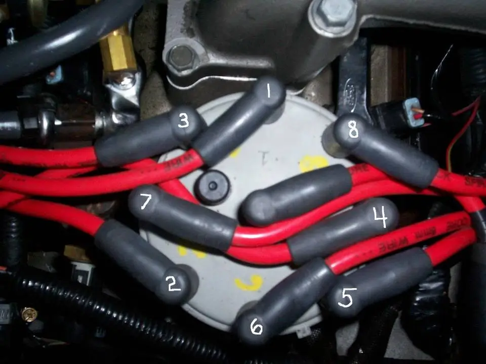

OK so me and my friend decided to give my car a tune up today, and we did. First we started with the sparkplugs disconnecting and changing them one by one. then we disconnected the distributor cap,rotor and wires and changed them. Apparently this is where something went wrong:( . Now it won't start. We try and start it and it will turn on for a couple of seconds then shut-off. I think the firing order is: 1,3,7,2,6,5,4,8. thats the order we connected the wires after installing the distributor cap. We've plugged and unplugged and check the sparkplugs and wires and can't figure out what went wrong!?Please any help would be greatly appreciated.( It's a 94 mustang GT with 57k miles.)
wires definatly crossed somewhere pull plug number one, crank untill you feel air pushing out of hole, put a pencil in there and feel it till its at the top. now pull your cap and the rotor is pointing at wire number one, mark your cap according counter clockwise as per firing order, then check your wires to make sure they are going to the right plugs

D.) Firing order off: HO & 351 use a different firing order from the non HO engines.
HO & 351W 1-3-7-2-6-5-4-8
Non HO 1-5-4-2-6-3-7-8
