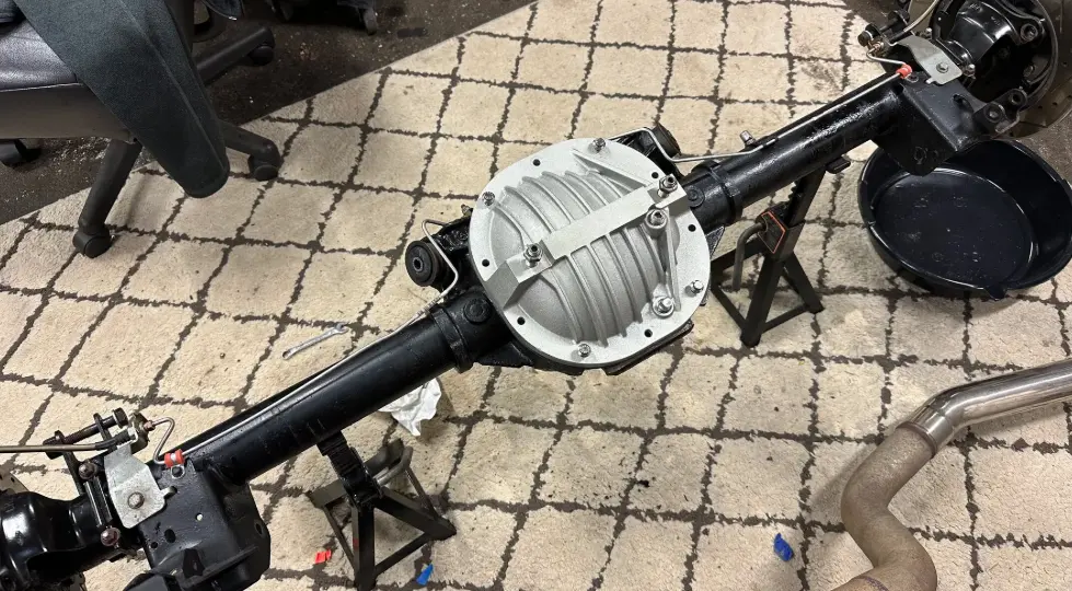

I think on one side the hole was existing, but not tapped. On the other side i had to drill. I forget which was which.
The alignment tab fits into one hole, and then the bolt goes into another. Like i said, one side the holes are there. The other side you'll need to copy and drill into the shock mount

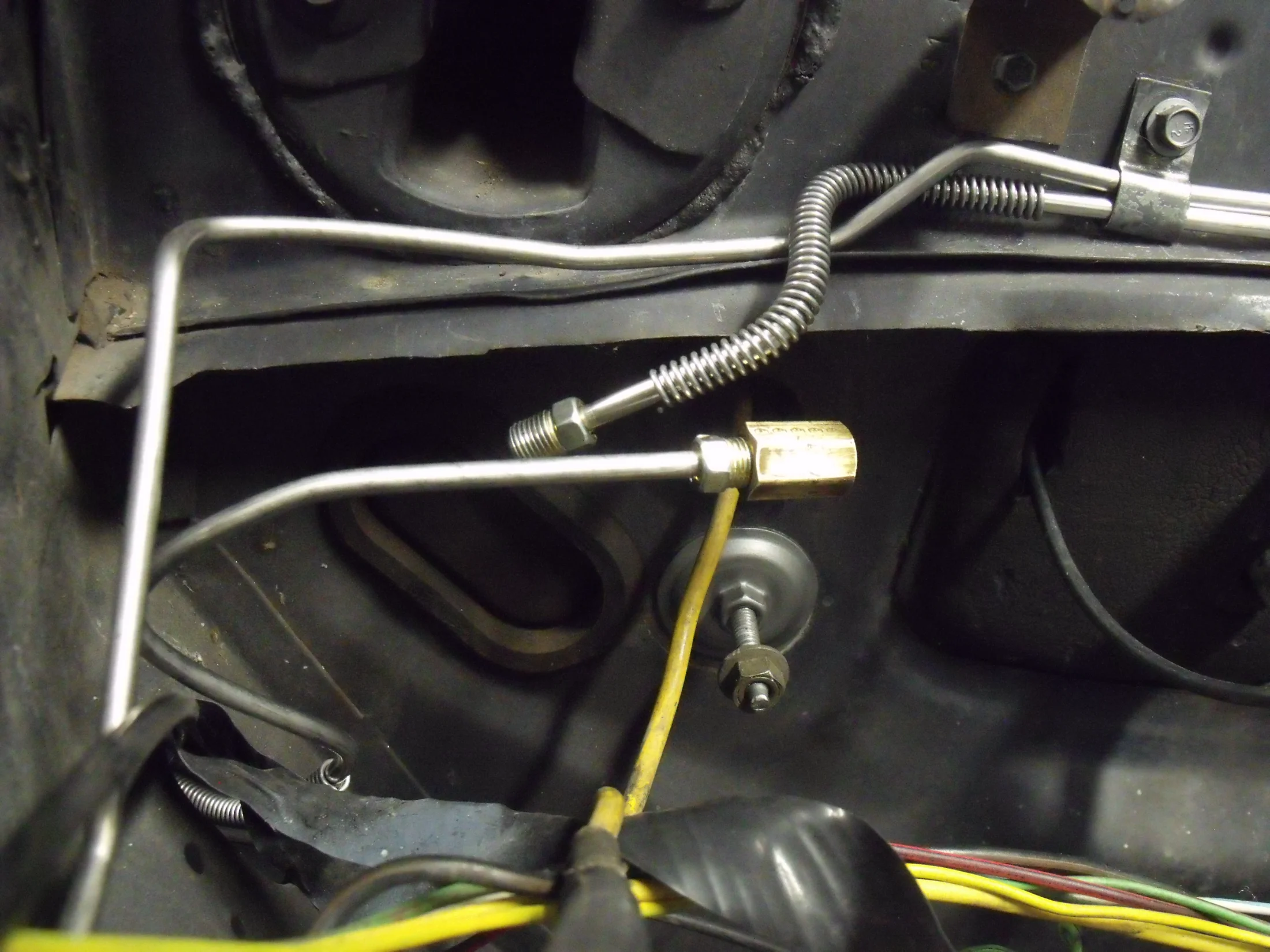

Nice thanks for the pic, I might have to bend some of my brake lines a little to get the bracket to reach the shock mount.
They are never perfect.. ALL pre bent lines I have ever used for all different makes needed some massaging.. I removed the line, on the attached pic, and took it over to a local place that bends and flairs lines to cut and flair the end on their machine...
