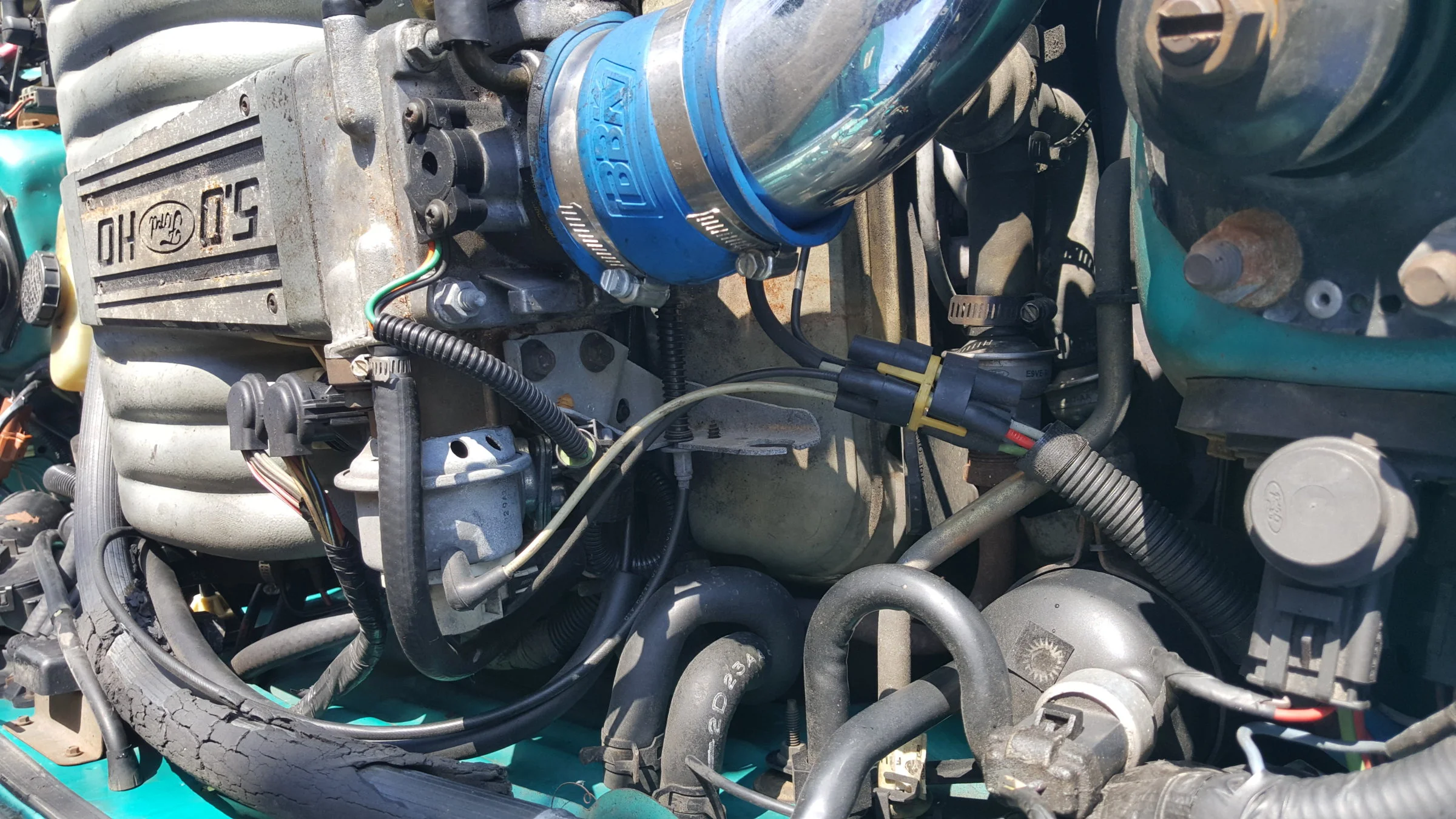

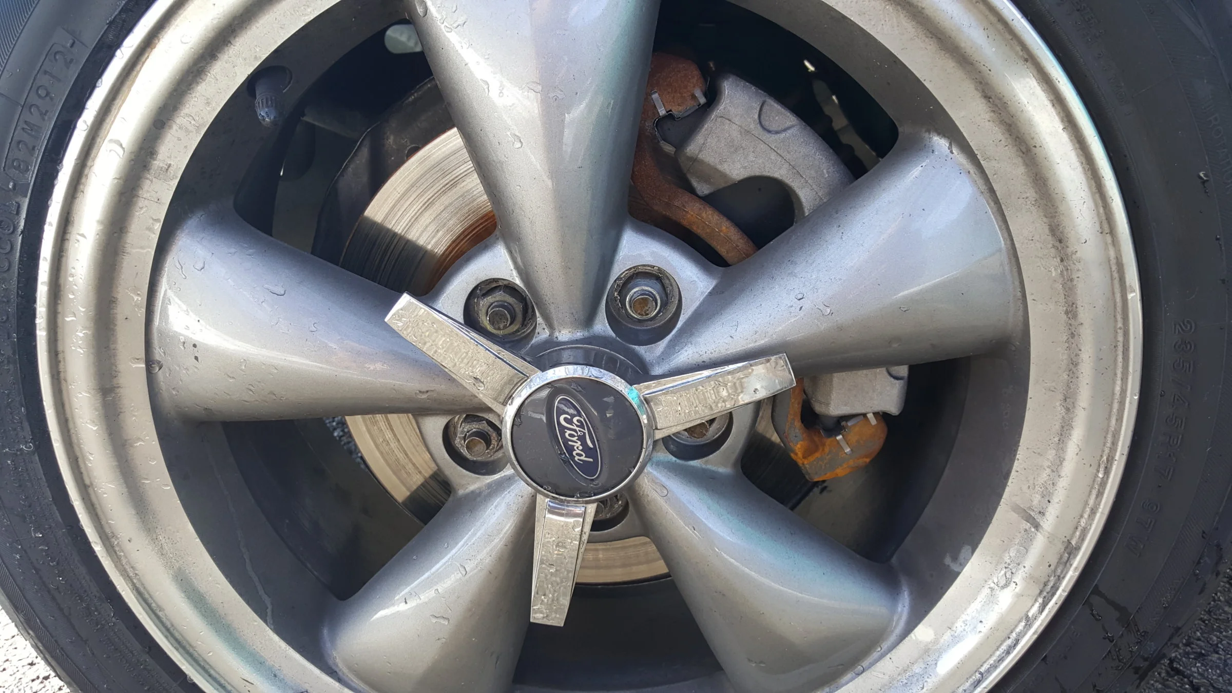

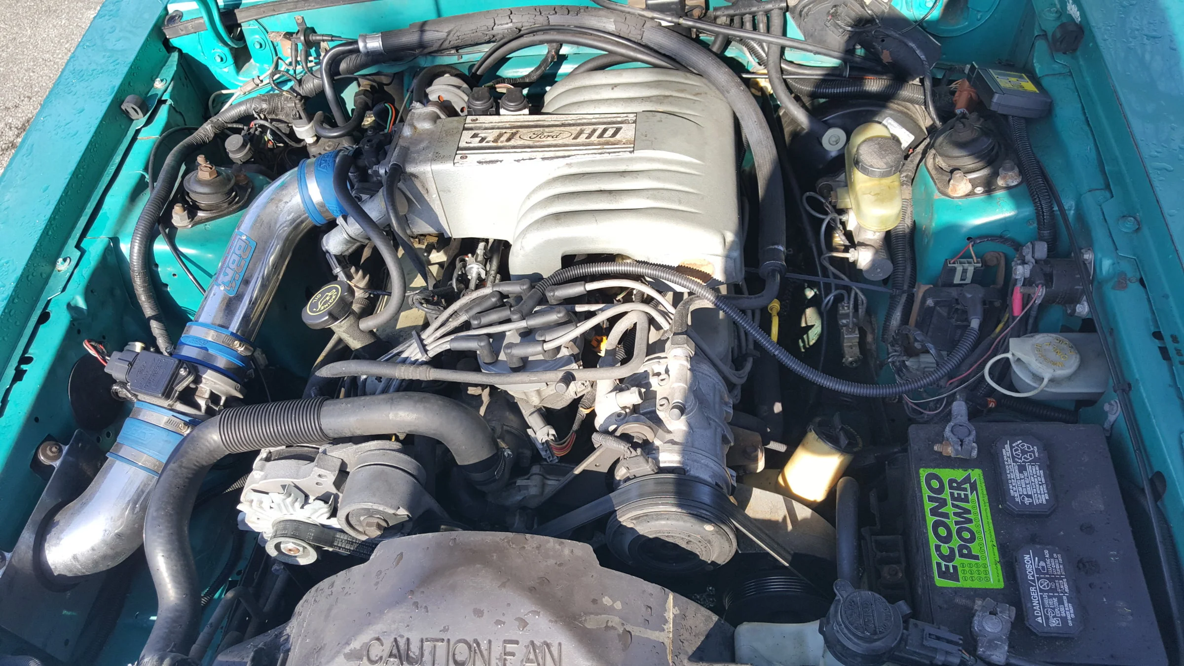

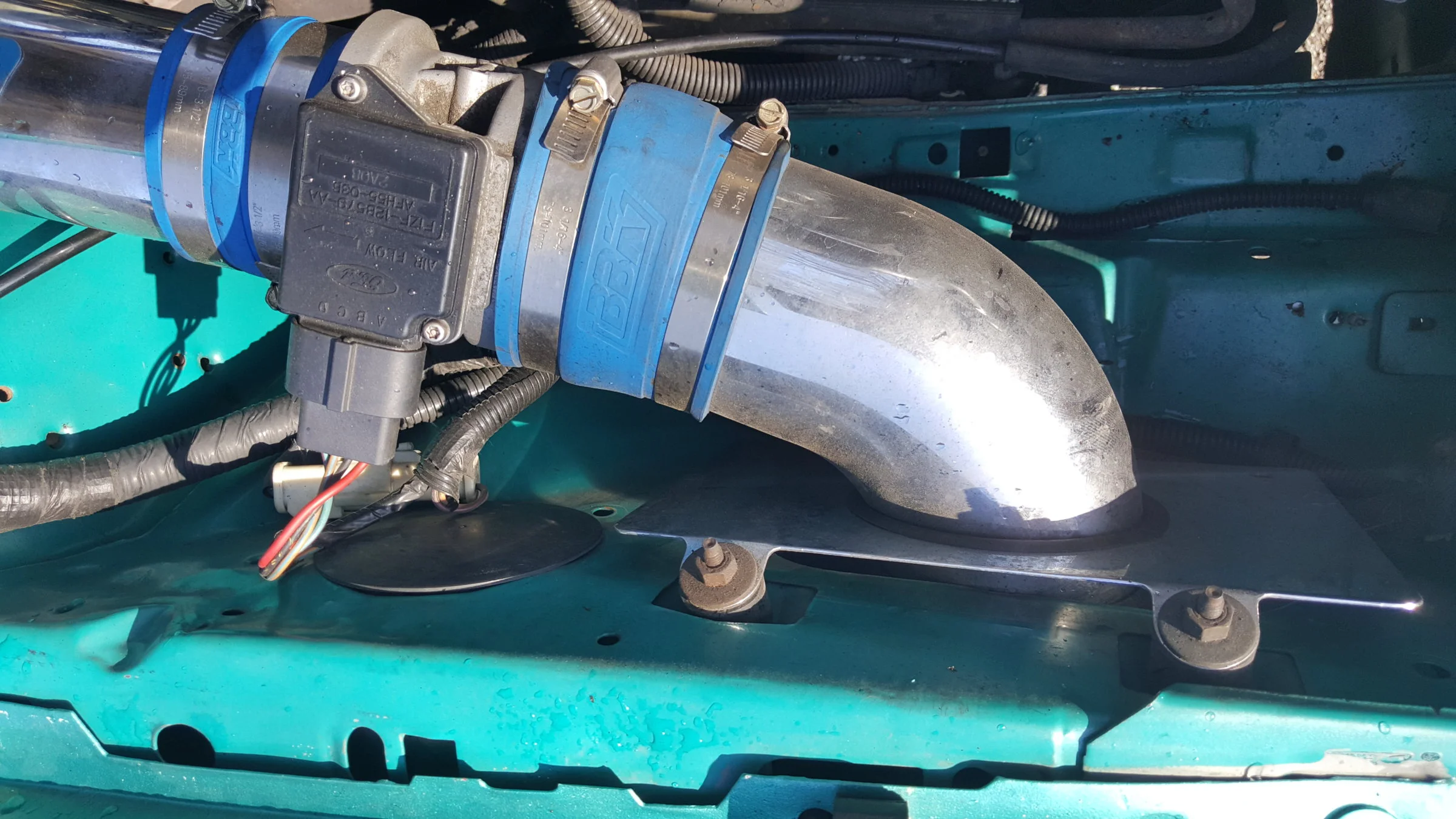

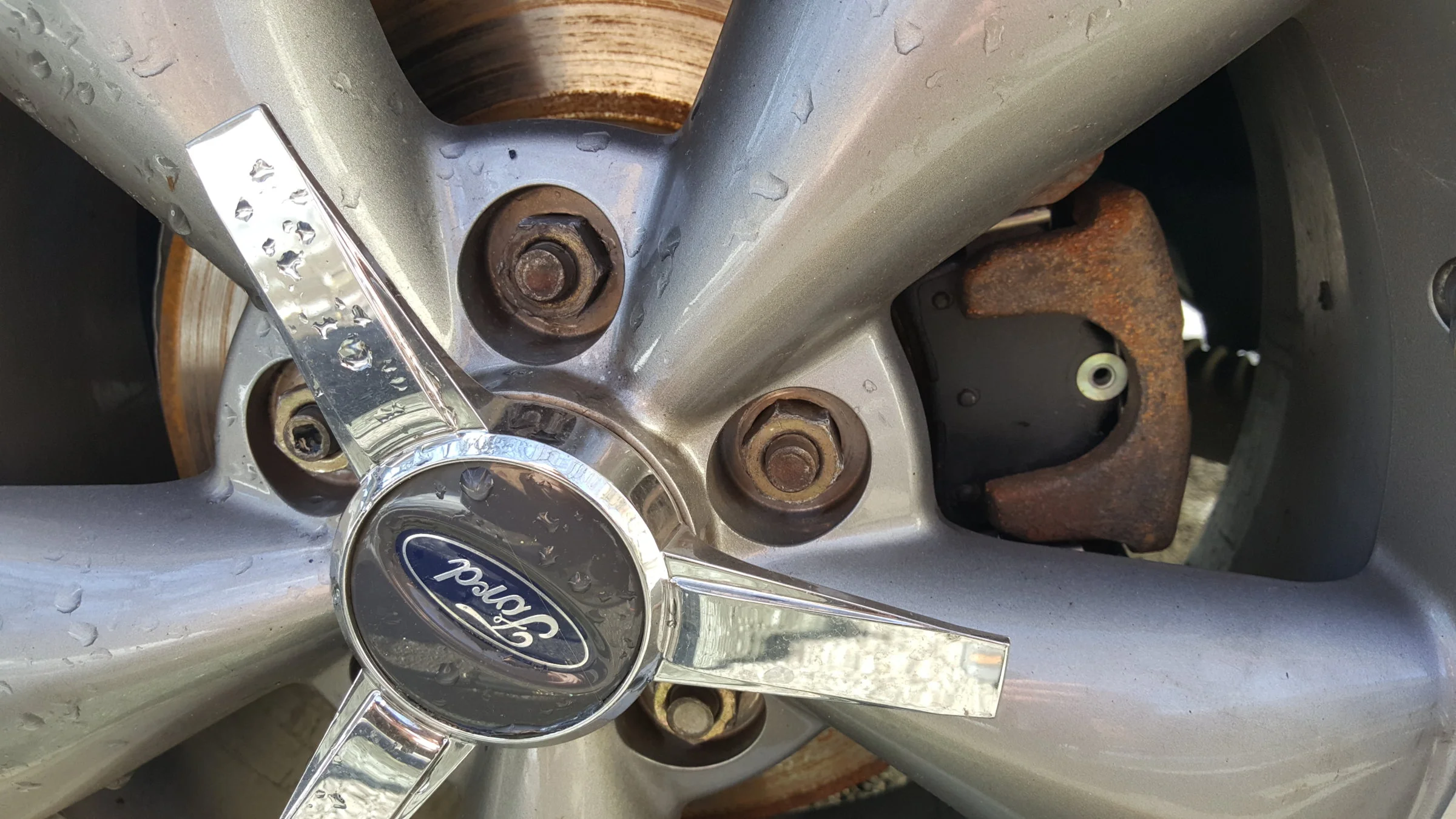

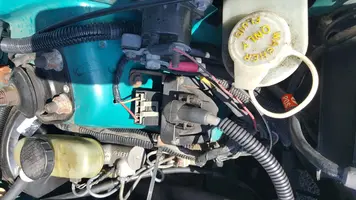

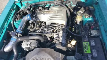

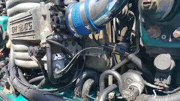

Fellas,
I finally took a few photos of my 92 LX. As far as I know the only mods at all are that BBK cai, tower power shifter, and 5 lug conversion. Previous owner says front brakes are off of 03/04 cobra. Rears off the same. I apologize for only having the limited photos I do. Just curious if you guys see anything I don't, or isnit all stock minus what I listed? Thanks for any help.

99-04 GT/V6 brakes. However the wheels are 05+ Bullitt wheels with optional spinners
Those lugs are incorrect for the car. Looks like they are using a washer. You'll want conical seat acorn lugs Those other lugs look like they can allow the wheel to shift a tad and that's how you snap lugs off
99-04 GT/V6 brakes.
The spinnners are added on
Yup just ordered a set. Those look terrible on there lol

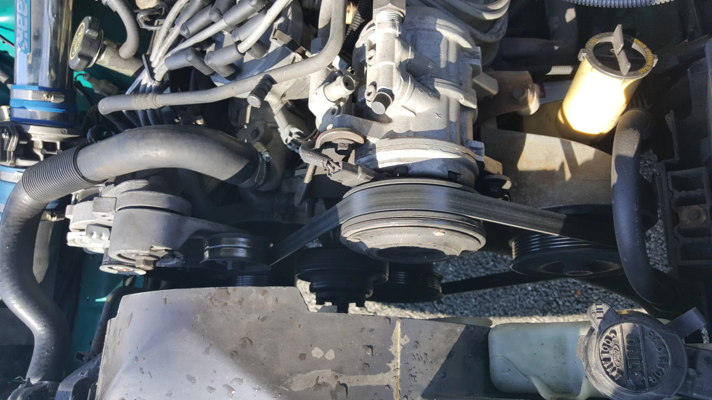

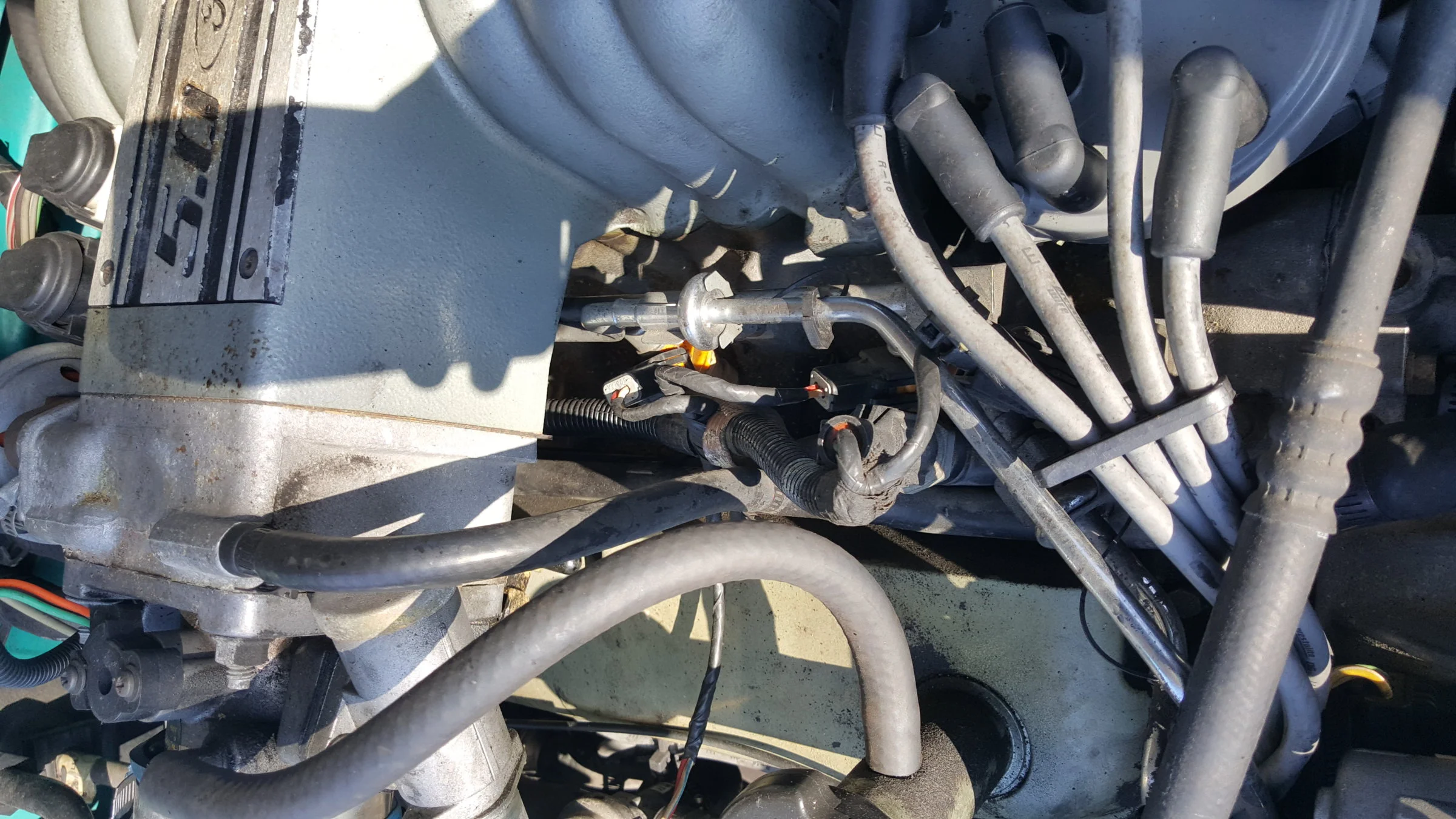

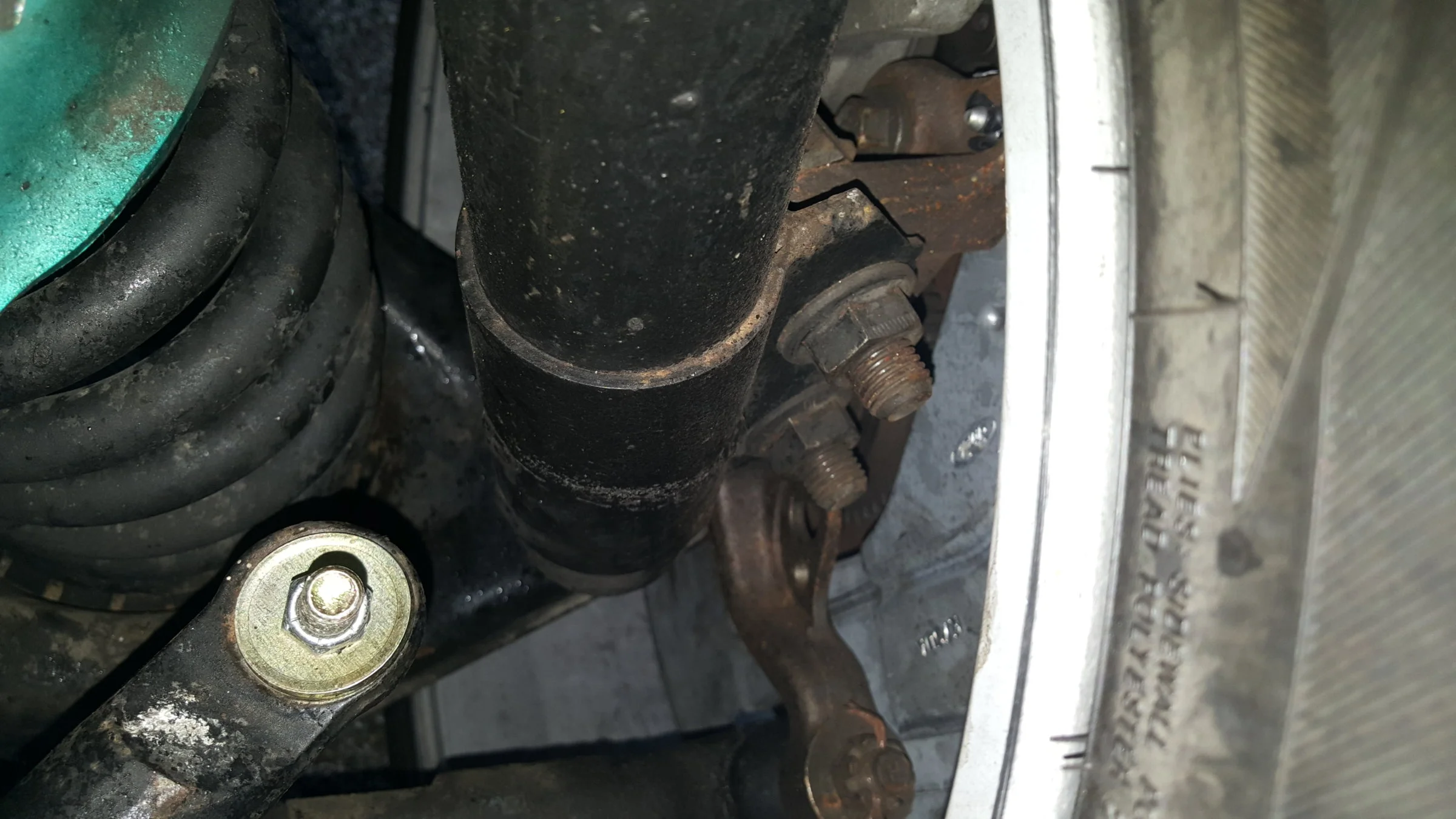

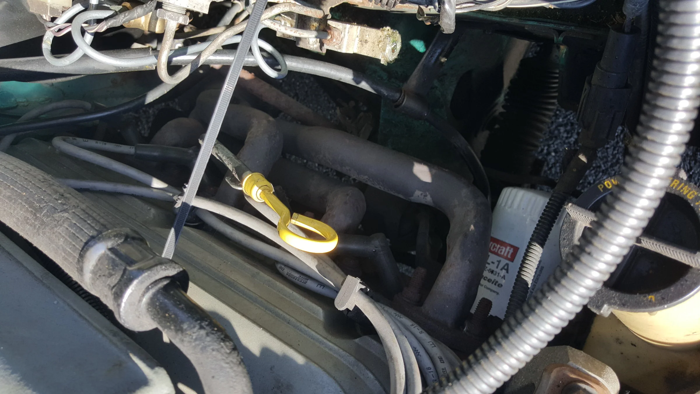

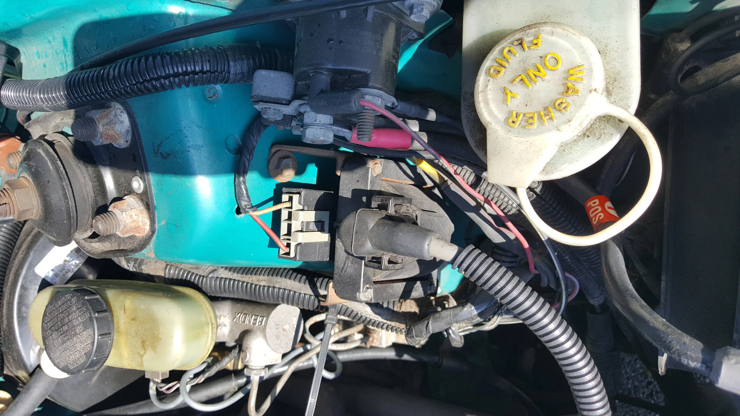

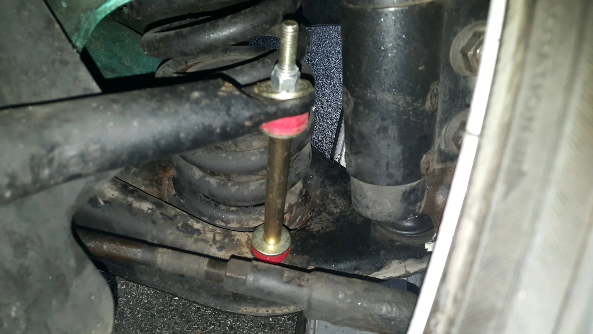

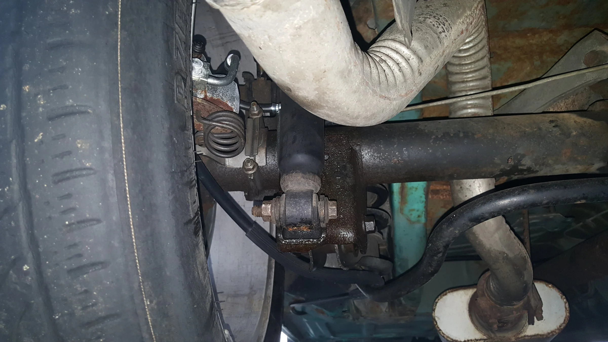

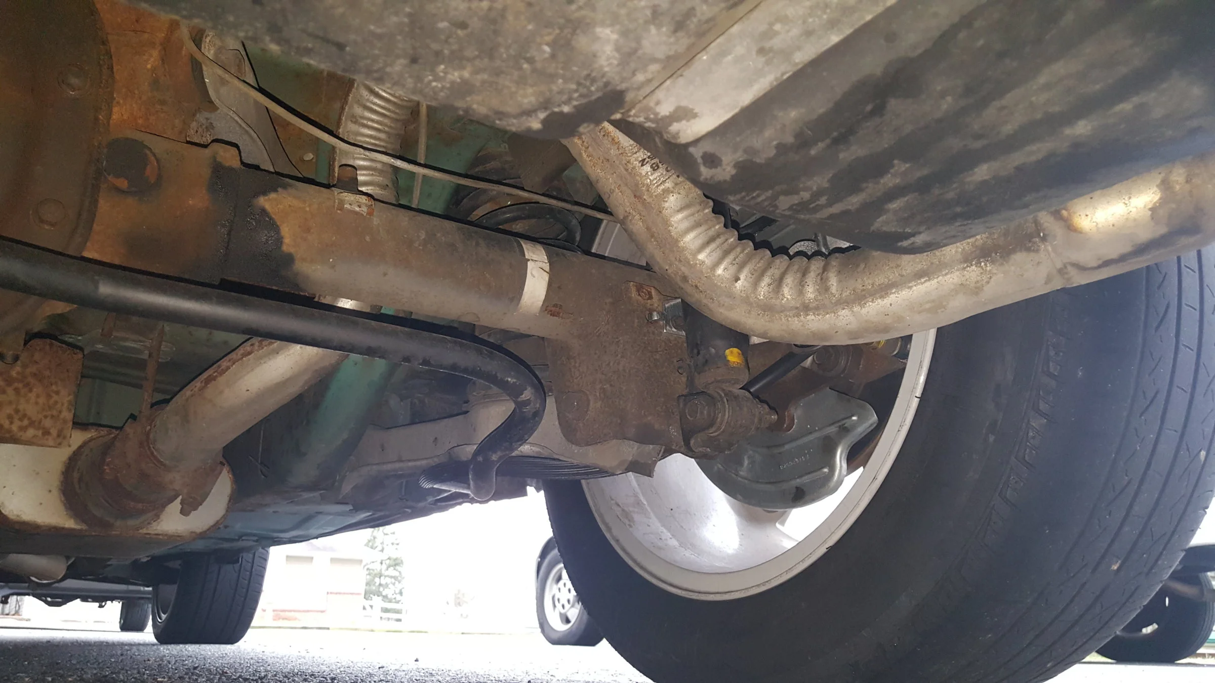

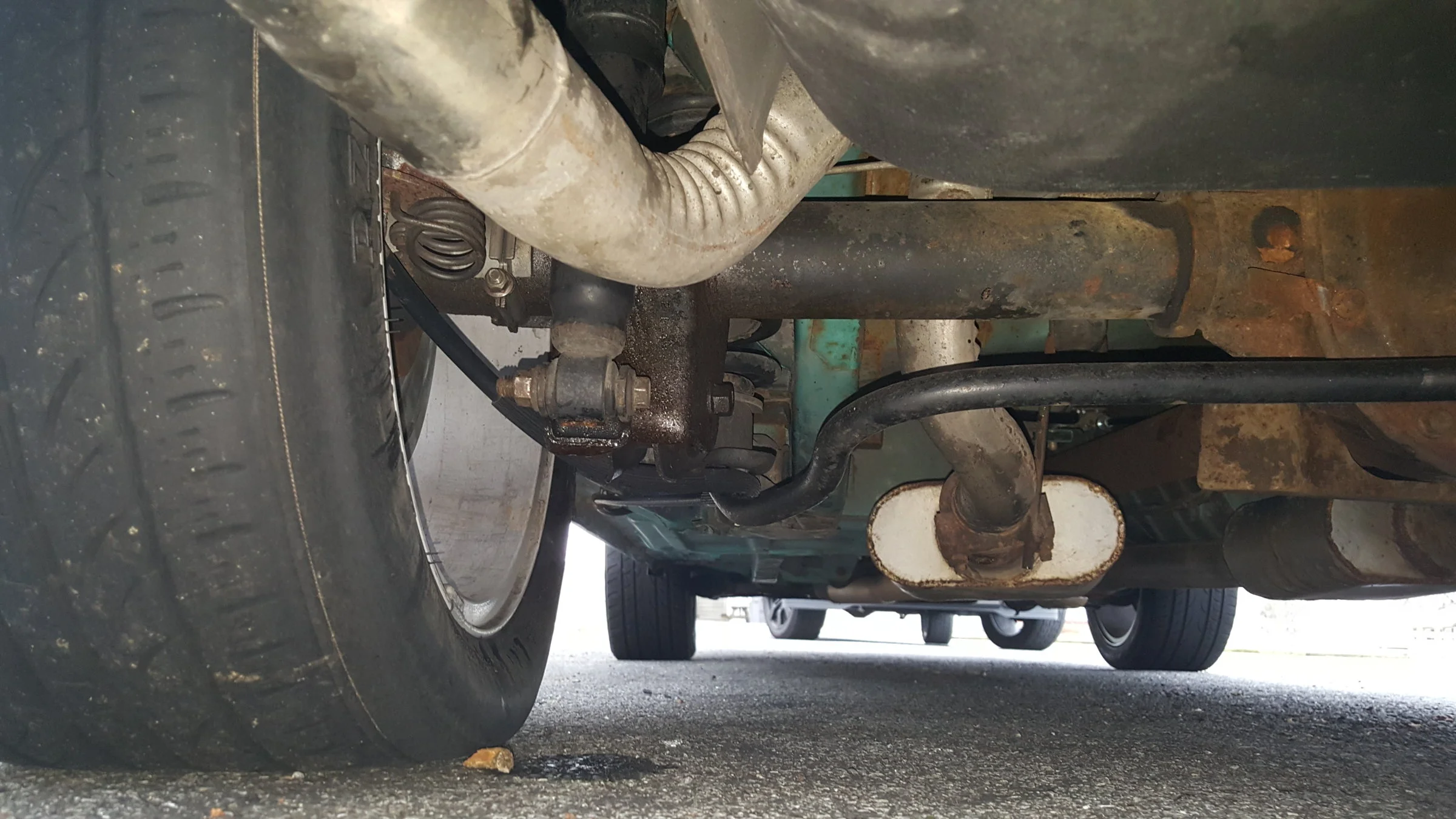

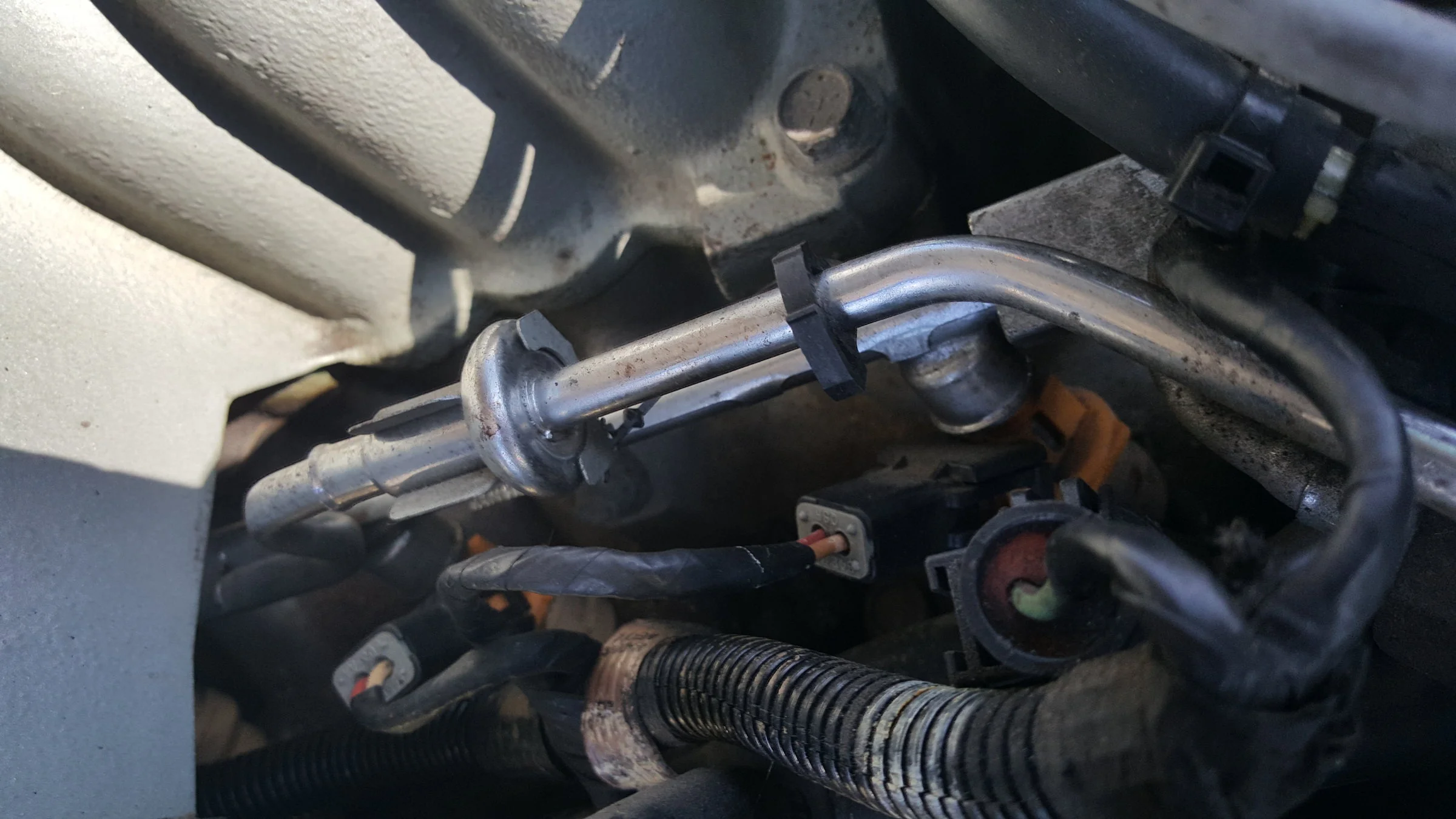

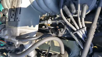

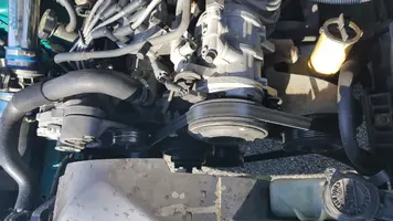

Thanks for info. Im.currently watching my son for the day so am away from car. I asked my father to send me some photos and this is what he sent. I'm not sure how helpful it will be. I can post additional photos tomorrow. Let me know what you see. Besides a leak of some sort by rear driver wheel.
