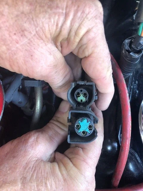

I need to buy a MAF sensor and pigtail but (first) need help identifying the correct plug.
Here's my dilemma....
I bought a 68 Mustang with a known bad motor (Fox 5.0L). It did run and drive but it had a cracked head and tons of water in the oil so I swapped it out.
The donor engine block is a 306ci with AFR 1472 heads and a Wolverine 1087 cam with a ported GT40 intake and a 70m throttle body.
I dropped the engine in the hole, hooked it up and it starts and runs pretty good.... but not perfect. I noticed that the Throttle body was running open without a MAF sensor...and I remembered that the old engine also did not have a MAF sensor attached.
I'm assuming that it's probably running on the default fuel/air tables and is in limp mode...and needs a MAF sensor.
--> In order to find the right MAF sensor and pigtail connector, I need to know what the MAF harness plug looks like. (NOT THE PLUG THAT PLUGS INTO THE SENSOR...but the end of the harness that th pigtail plugs into).
OLD ENGINE:
I was told (unconfirmed) that this engine harness and the old motor came from a 1988 / 1989 Fox Mustang so that should be the harness I'm trying to connect to.
1.) I found 2 unused plugs on top of the lower intake but would like to know if anyone can identity these plugs and what they go to.
2.) If I buy a MAF sensor for a 5.0L (1994 cobra for example) can I splice that pigtail into this engine harness and would it work ?
3.) If not, what is my best option ?
The photo is below:
Thanks for any help,
Mike Nelson
Denison, Tx
Important question. What ECU are you running. If the donor engine is possibly from an '88, then it could be a speed density setup which doesn't use a MAF sensor. 1989 does use a MAF. The wiring will be different between those two years as well.
If you are running a speed density ECU, then that brings us to the problem. Speed density doesn't play well with aftermarket camshafts.
This statement makes no sense to me.
The MAF harness plug IS the plug that plugs into the sensor. There is no MAF pigtail.
I thing he's assuming he's missing a subharnnes (which doesn't exist) which plugs into one of the two plugs he's holding in his hand (one of which is the charcoal canister plug)

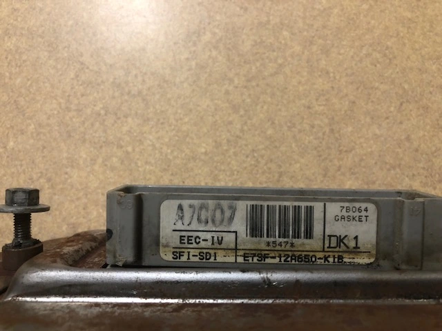

Here is the ECU: EEC-IV
I do not see a connector on the harness that will fit the MAF sensor. If this is in fact, setup for speed density, then I assume it will not be there.
Would I be better off buying a 1990 - 1994 ECU and engine harness ?
Is there a better option ?

DK1 is the relevant code here. Trying to look up now what that corresponds too. It's not a standard mustang ECU.
But it is a speed density ECU (says SFI-SDI), which means no mass air meter. That's a problem with aftermarket cams, and larger size injectors (if you equipped your motor with it)
Do you still have the old motor? It's possibke that motor was never a 5.0 HO to begin with

Thank You for identifying the ECU as a speed density model, that helps !
To answer your question: Yes it is very possible that the old motor was not a 5.0 HO.
The new motor is definitely a 5.0 HO and runs great and with the mods, it really needs an updated ECU and a harness with a MAF plug.
Any suggestions as to the best way forward ?
Do I buy an updated (90-94 ECU for example) plus an engine harness ?
Or would I be better off going with an after market solution ?
My objective is not to RACE the car, but I would like to see the engine benefit from these mods and run good, so I'm looking for the cheapest and easiest way to (not cut corners....but make this right.
Thanks in advance
Mike
In theory yes, you can buy an A9P/A9L and mass air conversion and wire it up and call it a day.
In practice, you should ideally identify what you had as the non mustang ECUs tend to be batch fire injection vs sequenctial like the Mustang. You could also run into issues with pin 30/46 and how that's wired up with the unknown harness as it could fry your brand new $300 A9L ECU, and we certainly don't want that.
