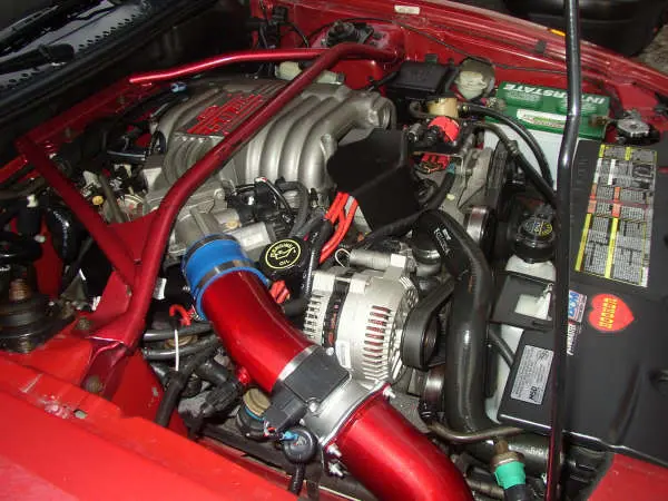

I bought a CAI on ebay, as pictured below:
I tried piecing this kit together in my apartment before putting it on my car. If you take a look at the smaller blue silicone coupler in the center of the pic, I tried slipping this coupler onto each of the pipes and it won't fit. It is just barely too small to slip onto these pipes.

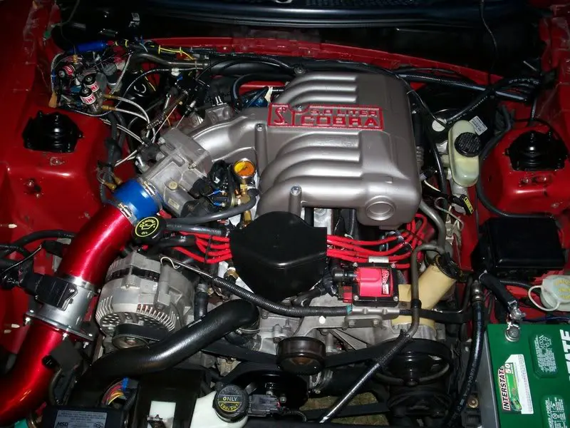

Does anyone know what the purpose of this coupler is and whether it is even necessary? In the pic below from another stang, it seems they didn't use this piece:
Also, am I correct in assuming that the other coupler (reducing coupler) is used to attach the CAI pipe to the throttlebody? Is the throttlebody for a 94 Cobra a smaller size than the CAI pipe?
The kit didn't come with instructions- just want to get everything straight so I don't waste time when installing. I'm sure this would help out other people as well.

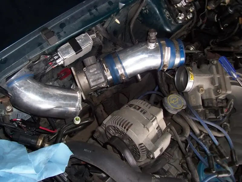

I have mine apart right now. Ill take some pics for you.
I used all the couplers, but they were a BITCH to get on. They will fit if you make them.

You get the idea.

a little trick that i use to get the smaller coupler to go on is i put it in boiling water for a little bit. makes it a lot easier to stretch out.

I got mine hot enough with a heat gun that it went on pretty easy! I could not even get it to start before using the heatgun though.

The boiling water trick worked, thanks!

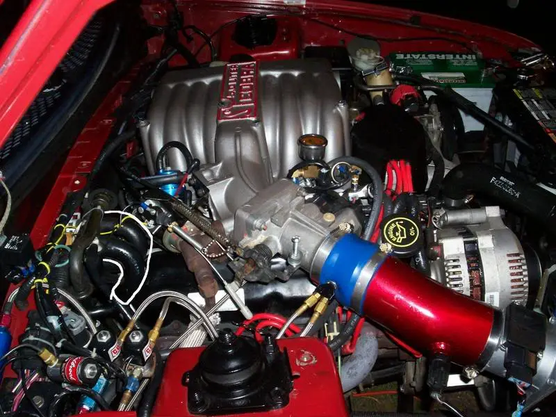

whew thats an old pic......let me post a new one....and im also late on this thread anyway i did not use the smaller coupler i just inserted pipe into maf which was a tight fit but not as tight as the coupler and secured it with a clamp and permatex to prevent air leaks see pics. below it works well. it makes good sence to me to get this cai unless you have money to throw away its just a tube....

The Green GT said:
You get the idea.
someone needs to do some cleaning.... what is that silver box on the fender wall next to maf...
i believe thats for his HID kit...
i got the same CAI intake kit and cant complain... i chopped mine so i didnt have to do a fenderwell...
Yea, Ive been meaning to pull all kind of stuff out and clean around it one day. Just need to find the time.
And that box the the control module for my twin turbonators.
Its actually the ballast for my HID kit.
