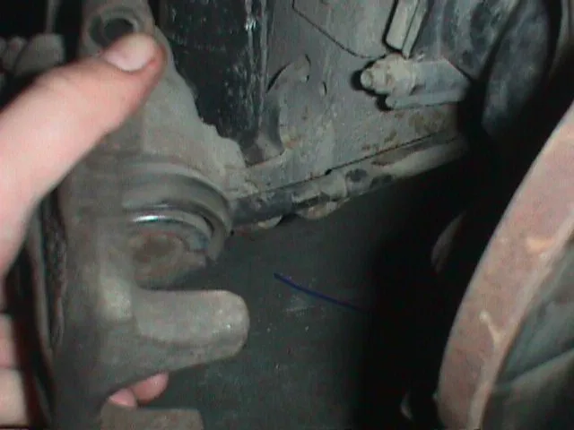

Well, it came off easy enough. Theres two lines that attatch to the rear calliper the upper is the brake line and I think the lower is the parking brake. The lower line is putting too much force on the calliper to get it back on. I've tried to pull on the line to relieve the tension but its not enough. How do I get this freakin thing back on??? Do I need to remove the lower line? If so how??? I've been at it for the last two hours and I've gotten to the "I quit" stage.

Its not the piston thats keeping it from going on. Its the lower line thats connected to the calliper. Its pushing the calliper back away from the rotor. I took the pads out to see if the piston had relaxed but I still can't get the calliper on. I can get the upper bolt screwed in but I can't put enough pressure on the bottom of the calliper to get the lower bolt in. Its like 1/16th of an inch away. Theres gotta be an easier way of doing this.
I have never had this much trouble installing a calliper. This is ridiculous! I've pulled that cable as far forward as I can but its just not enough. That cable is forcing the bottom of the calliper out, somethings gotta be wrong.
i've ran into your problem before. DO NOT remove that parking brake line. it is the near impossible to get on and off. you just have to really man handle the caliper.
1fstgt said:
and make sure your parking brake isn't set.
i dont' know if it matters or not but it would make sense that it wouldn't go on really well if it was set.
Like stated above, make sure the E-brake is not on. In fact, if memory serves, the e-brake cable should not be re-installed until after the caliper is all bolted up. After the caliper is mounted then take a vise grip and pull the cable into place.
