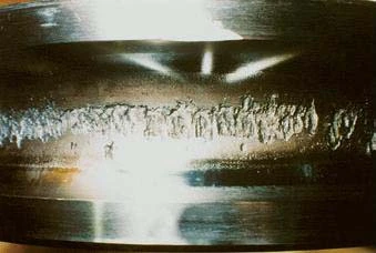

It was the rear bearings without a doubt. The differential unit and the ring/pinion gears are unharmed (thankfully).
The bearing raceways were pitted and heavily damaged from the bearings. I'd be willing to bet that if I was not as in-tune with my car or just ignored it, that the bearings would have torn themselves apart and the damage would have been far worse than what it was.
I wish I had gotten a pic of the damage, my raceways were marked with similar damage to the following image:
They were kind enough to inspect the wheel bearings as well at no charge :flag:

Wow, those bearings certainly were on the fast track to deadsville. I'm glad you got if diagnosed & repaired when you did!!
